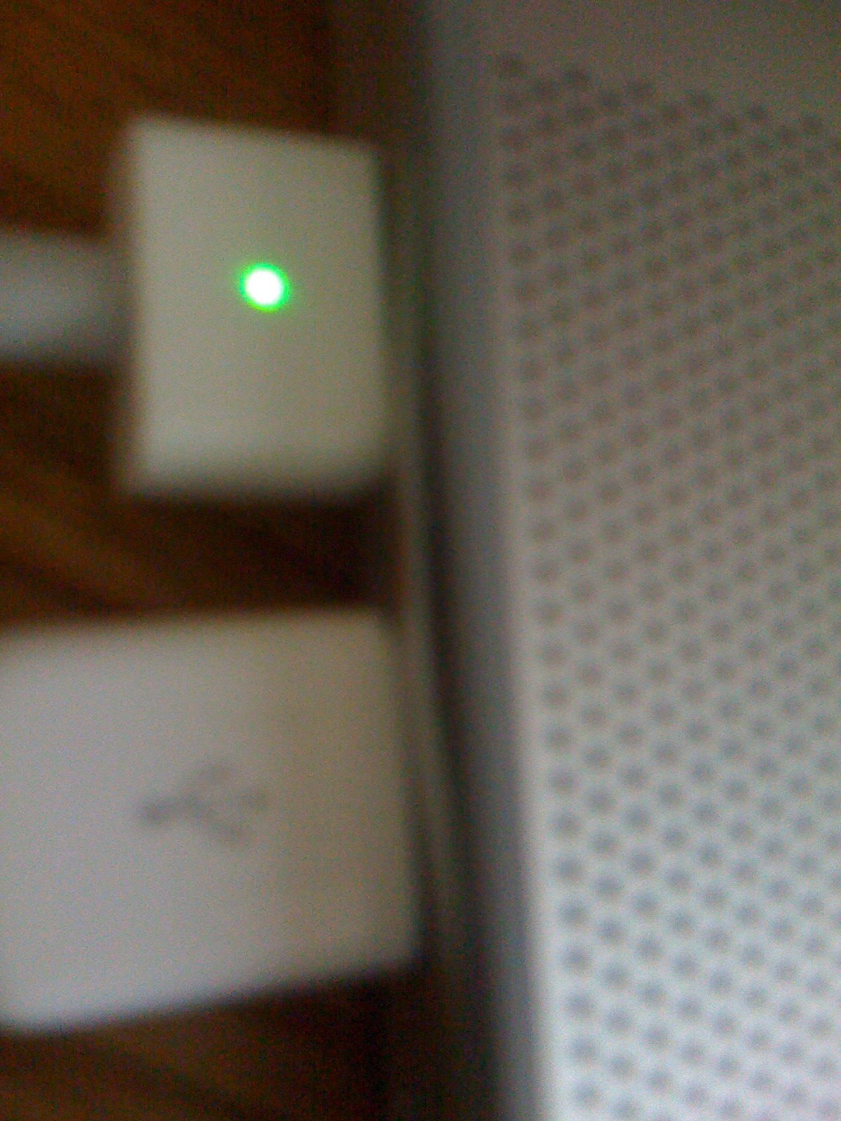

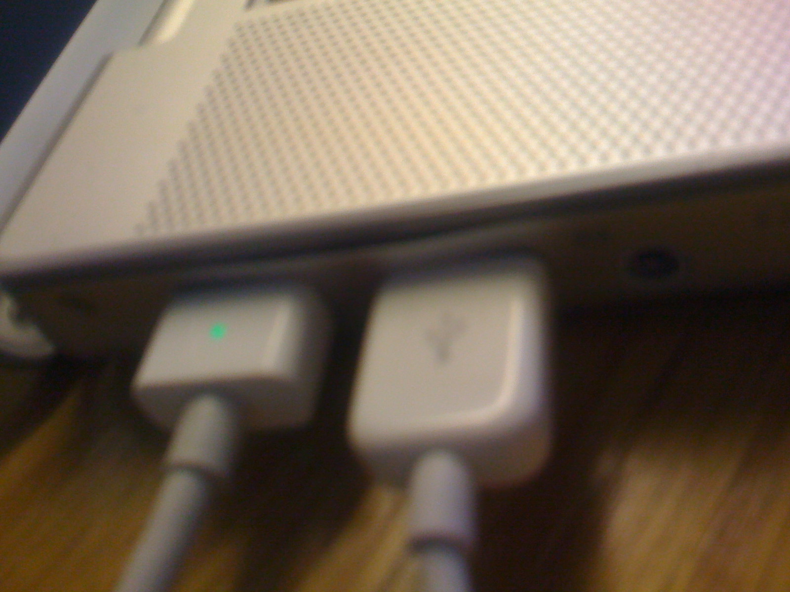

This also just occurred to me, but the work authorization sheet from the Genius Bar doesn't list the speaker dent under the cosmetic issues.
While I think the dent was caused by dropping the A/C adapter (that incident was honestly so long ago I don't remember, and the dent in question has been there for a while), would it be a plausible argument that, for all I know, the speaker was damaged while the Genius Bar had my computer for a week?
In other words, Apple's argument is they can't prove the dent was made two years ago and hasn't impacted the computer's performance until now, but I could counter that I'd never even noticed the dent until the ARS people pointed it out to me, and since it wasn't on the work authorization form when I checked the computer in with them, they can't prove they didn't cause it in-store?
I'd hate to throw around blame here, obviously, but I was just wondering if it would be worth pointing out should the issue come up.
Also, FYI, the only thing that the Genius did list on the work auth form was "Cosmetic Condition: Good. Small cosmetic bend along the right-side near DC-In and Express Card Slot In." Attached is a picture of what he's referring to.

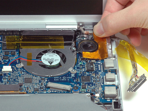

Unfortunately, it's quite close.
I'm not 100% sure I know what I'm looking at there, but that's the right-hand side of the computer, isn't it? Over beneath the power button and by the DVI/ethernet/Firewire/USB ports? (Which I guess should make sense because the location of the DVI port should be in proximity to the graphics card, right?)
The speaker dent on my computer is on the left-hand side, over by the power/USB/audio ports.
ETA: So I guess the Genius also made a mistake when he described the "small cosmetic bend along the right-side near DC-In and Express Card Slot-In," and he probably meant along the left side.
I'm not 100% sure I know what I'm looking at there, but that's the right-hand side of the computer, isn't it? Over beneath the power button and by the DVI/ethernet/USB ports? (Which I guess should make sense because the location of the DVI port should be in proximity to the graphics card, right?)
The speaker dent on my computer is on the left-hand side, over by the power/FireWire/audio ports.
Right, the left hand side would be somewhat symmetrical - which is wear your dent would be. Although I still stand by my argument that the dent did nothing to your logic board, you can see where and how Apple has a strong argument where they say the dent could have affected your logic board in some way.
Yeah, I can definitely understand their side of the argument in all this. For all they know, whatever caused the dent could have damaged the logic board, which could be causing the symptoms I'm experiencing now, and since accidental user damage isn't covered by AppleCare, then, yes, they're not obligated to fix it. Which would suck for me, but a contract's a contract.
However, it is reassuring to hear that it's unlikely that was actually the case.
Plus I would imagine if I had damaged the board on the opposite side of where the video components are even located, I'd be dealing with a whole slew of symptoms and not just this single video issue.
And to hear that it's also a common issue that several other users with this machine are now suddenly waking up to two years after they purchased their MBPs?
Well, let's just say I now feel a lot better about asserting that I didn't cause the problem here and the Genius Bar people simply either didn't want to take the time to properly diagnose my machine, or didn't want to hand over an $890 piece of equipment.
If you look at the ifixit picture you can see that the logic board doesn't extend over the left speaker.
