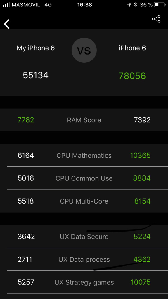

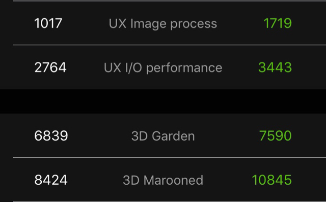

I understand and already knew that since some years ago, devices manages the clock between some pre-fixed speeds depending on demand.
What I don't agree with, is that it always be on minimum clock speed. The laggy and freeze is incredible. And a benchmark comparing plugged and unplugged is awesome. I know that them cannot be used to compare two different mobiles might not be useful, but comparing the same mobile at different times tells a lot of what I suspects.
Look at the test I did some minutes ago at 40% battery. Comparing with "standard" iPhone 6 is shaming....
