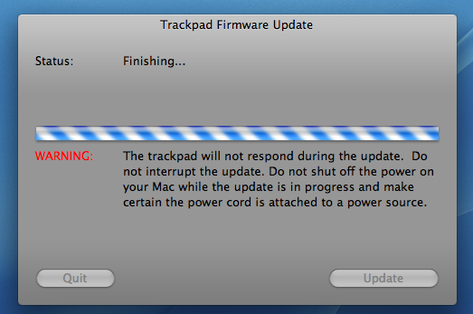

How long should this take? It's been at "Finishing..." for 30 minutes.
Looked like it installed some files after reboot 15 seconds in all
Then the firmware update 5 seconds then hit quit and all is done
I have Trackpad Hardware version 0.77
Track Pad Firmware Update 1.0 is installed
