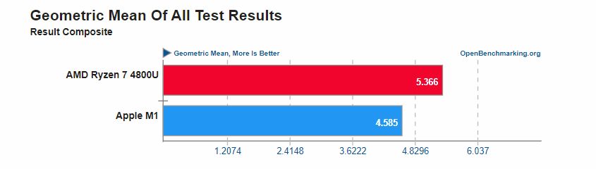

I can give you an additional one..
The geometric means of all openbenchmarking.org benchmarks between AMD 4800U and Apple M1
