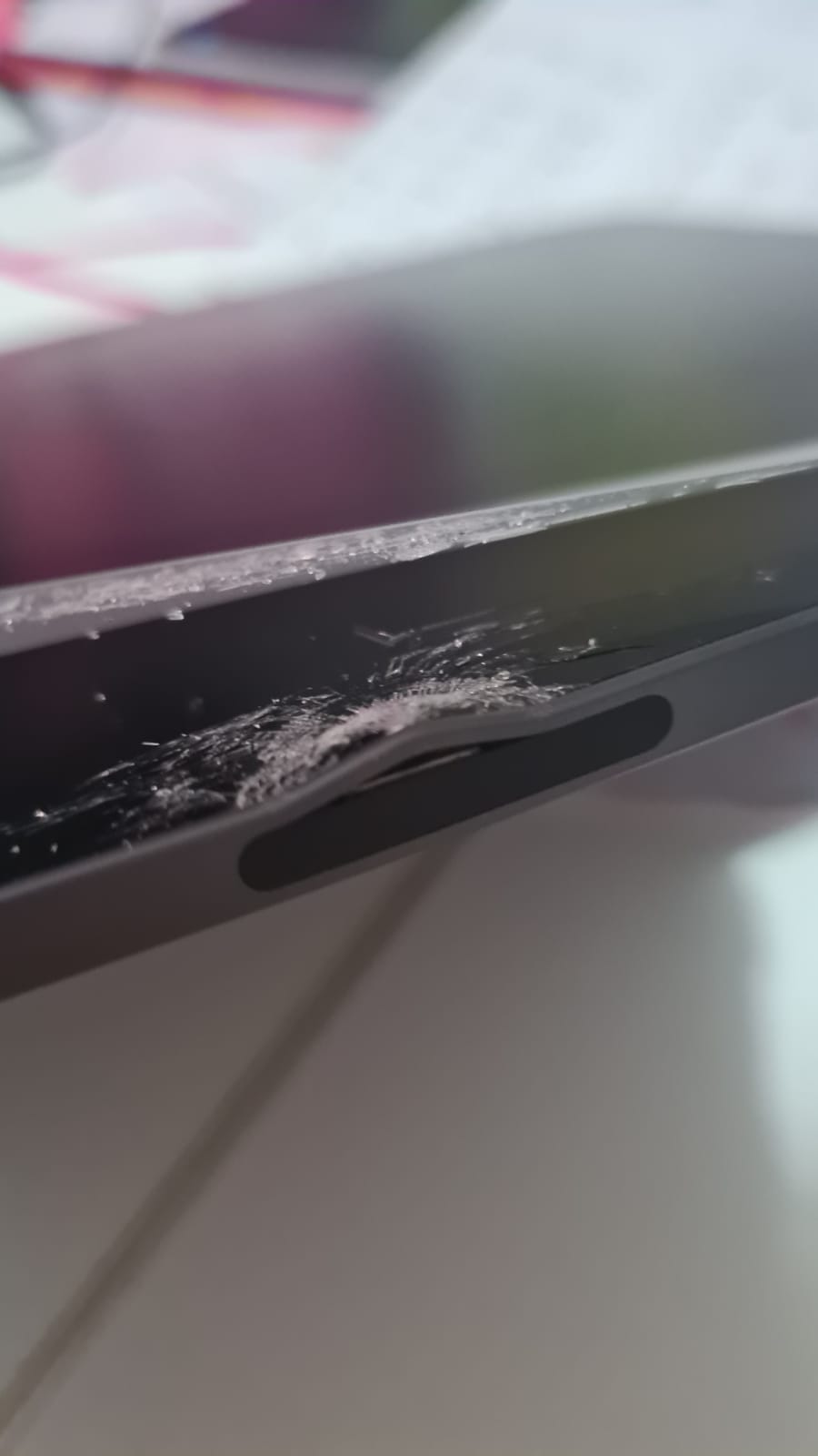

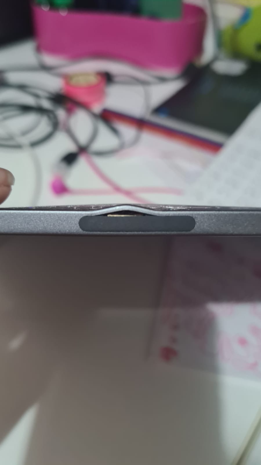

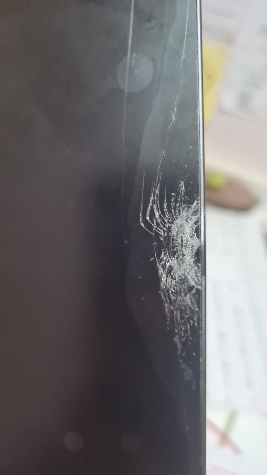

I was charging my Apple Pencil 2 with my Ipad Pro (11 inches 2018) and the magnetic charger just bent by itself cracking the screen. Since my Apple Care+ expired two weeks ago and the support center said there was nothing they could do. They didn't give me an explanation about what could have happened, and the technician said that it indeed didn't look like something external happened to it, but since they didn't know what happened they considered it as accidental damage.
Does anyone know what could have happened to it? I don't have money to buy a new one, so at least I want to know what could have made this type of damage.

Looks like a part of the charger got hot and something expanded/exploded. As the guy said, it must have been internal, it seems very unlikely something external could have caused the metal to bend outwards in a 'nice' shape like that, and cause that shattering pattern from the bend point. So I wouldn't call it "accidental damage", because that implies the user did something to damage it (you only tried to charge your pencil), not a part failure.
Hard to say for sure without opening it up or comparing to a reference photo. I suppose if chargers get hot, there is that risk, but seems like an extreme case just for charging a tiny Pencil battery...

I'm not sure I'd be willing to accept the there is nothing they can do. If you are only two weeks out of warranty then that is kind of ridiculous if there was an internal fault. Do you have an Apple store nearby where you can take it in to show someone? Just for reference, I sold a 2015 iPad Pro to some friends and when it started flaking out and restarting they took it to an Apple store who said it wasn't repairable. When they complained the Apple store gave them a $250 gift card—more than it was worth in working condition. Apple store employees sometimes have a lot of discretion on what they can do to help customers.
I can tell you what happened. You want a replacement iPad for some reason and you bent that yourself with a screwdriver or some other implement.
There is absolutely no way that damage could have occurred on its own. No way. Any internal issue that would have been powerful enough to cause that kind of damage to the very edge of the iPad would be very easy to locate. That bend has a very small point of pressure, which is caused by the implement you used to bend it. There is nothing inside the iPad or pencil that would have caused that.
There is absolutely no way that damage could have occurred on its own. No way. Any internal issue that would have been powerdul enough to cause that kind of damage to the very edge of the iPad would be very easy to locate. That bend has a very small point of pressure, which is caused by the implement you used to bend it. There is nothing inside the iPad or pencil that would have caused that.
This ^^^

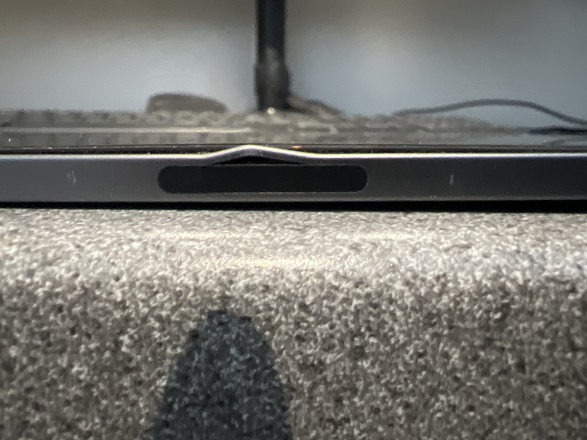

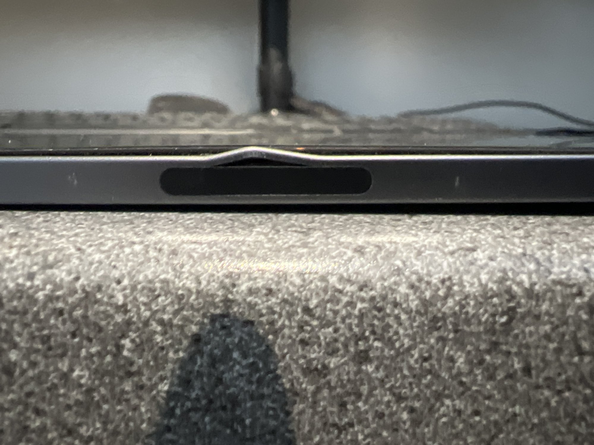

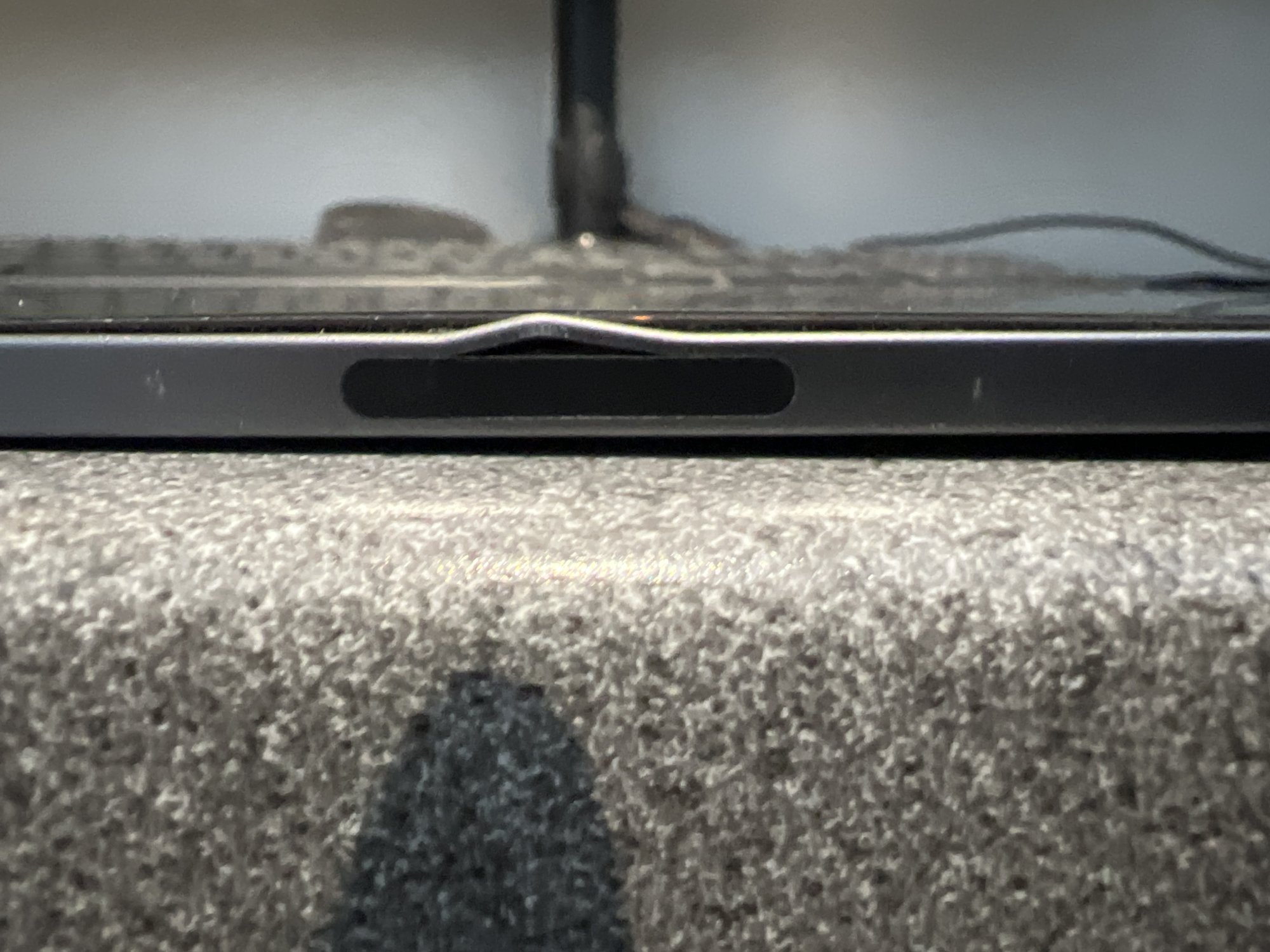

I have the same issue, although my screen hasn’t smashed (yet). There‘s a couple comments here accusing people of trying to break it on purpose, which is completely false.
iPad Pro 12.9” 3rd Generation.

Bent by itself? That is positively false. Look at the damage there - that was caused by either dropping the iPad while the pencil was plugged in or some event that caused considerable stress on the connection. There is no way that was caused 'by itself'. What happened was, you slipped up somehow and broke it.

That damage does not occur by itself. Even if the battery swelled, it would not cause damage there. Like the OP, you likely dropped the iPad with the pencil connected or sat on it or did it deliberately because there is no way that happened by itself.
So, it bent like that entirely by itself? The only possible (though very unlikely) component inside the iPad that could cause damage is the battery, and that is definitely not the case with your iPad. A swelling battery would never produce that kind of concentrated damage, and besides, the battery isn't even near that area.
Unless you fell asleep and rolled over on top of it without knowing, you did this on purpose and expecting people to believe otherwise is in and of itself ludicrous.
My guess is compression damage. The metal is bowing outward from one of its weakest points. Occam's Razor: it looks like a very specific kind of damage from a fall.
I was sceptical at first - looking at both the photos they are very similar in damage i.e. the peak of the bend is slightly offset from the centre, so I wonder if the copper charging coils (for the pencil) there have become faulty and caused damage?
Absolutely not possible. Those coils won't swell or explode. Let's look at the first photo again; anything that occurred internally with a degree of force required to bend the aluminum and break the screen in such a small concentrated area would have some telltale indication of what caused it.
The coil wouldn't (and couldn't) swell or explode, but even if it did, it would not be in the location where the damage is, and that particular coil would be easily seen where the damage is. To believe that the iPad had some internal catastrophic failure like what is shown, that coil or whatever caused the damage wouldn't explode, create the damage, then suddenly return to normal form.

Actually, I don’t want to rain on your parade here, because you seem to get enjoyment from being the resident crank, but you’re wrong. And rude as hell. But that’s beside the point.
I’ve serviced many iPad Pros made between 2018 and 2020 that have this issue.
It’s a structural problem. The metal at that point is thinner and weaker than the rest. This was somewhat corrected with iPads after those years, but it is a notorious problem with those made before 2021.
I doubt it has bent on its own with no external factors, but to say it was deliberate is a bunch of rubbish. More than likely, it was sat on or held by a corner or something else that distributed weight unevenly and caused bowing at the weakest point.
My own 2019 iPad Pro had the same issue. The screen didn’t crack, but that ridge did form on its own after time. My M2 iPad Pro doesn’t have the issue and I don’t see it in my shop very often on the M processors iPads.
But it is absolutely a design flaw of those models of iPad. Apple do not honor it as a fault because it is cosmetic. But they are well aware of the issue because they reinforced that area in later models.
Did it happen on its own out of nowhere? Not likely. Did it happen seemingly out of nowhere, with the owner not knowing something they did applied weight unevenly and caused a structurally weak part to bow? Probably.
But don’t go around accusing people of intentionally damaging their product. You have no proof of that, and each of these photos looks consistent with 50+ iPad Pros I’ve seen with the same unintentional damage.
Don't worry, you're not raining on anything, because this issue is a foregone conclusion with people that know better. You seem to convinced that this could not be intentional. Of course not all instances are intentional, but with the degree of force used to create that damage, it is suspect.
First you say how these iPads have this issue, then you say that you doubt it bent on its own. Well that's the point I was making, wasn't I? Whether it is designed for strength is irrelevant to my post. It's not an 'issue', or there would be widespread occurrences of it. There is no such thing as any charging coupling that can handle considerable force.

I didn’t mistake anything. The point is that you’re accusing people of intentionally damaging their product as some kind of scam or scheme and you have no right to do that. You are therefore an *******.
