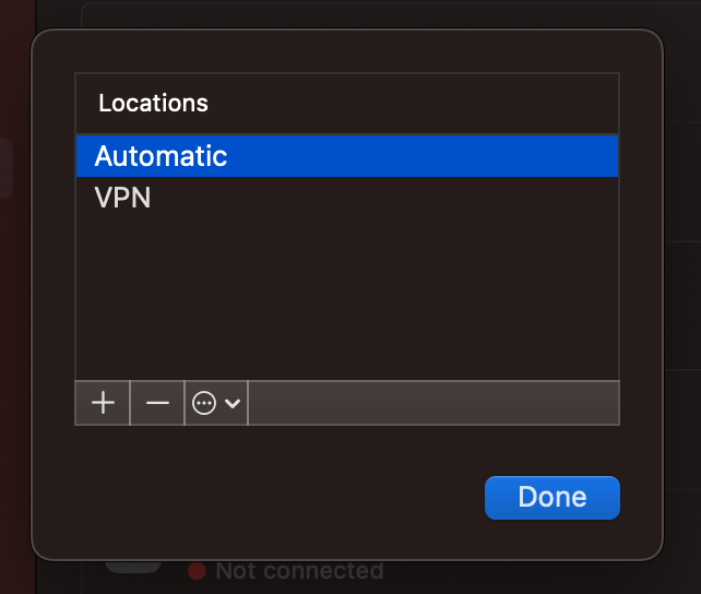

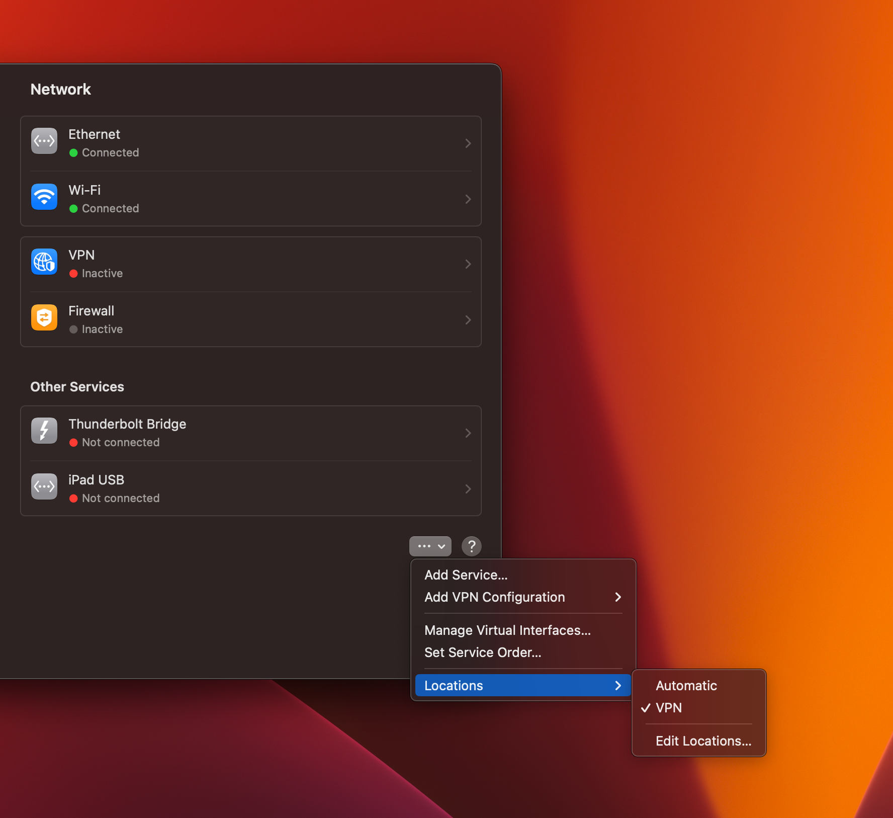

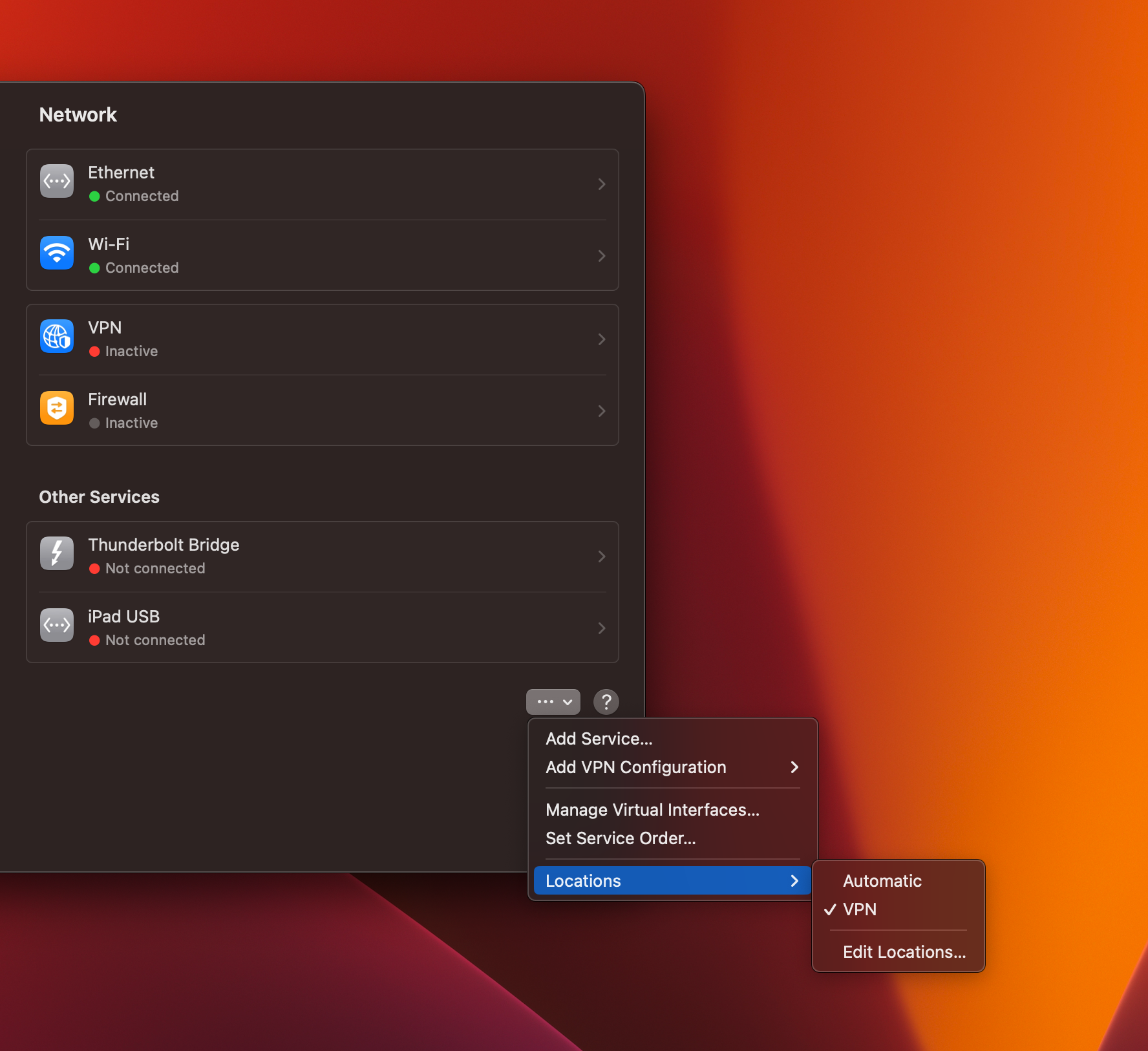

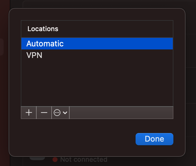

I did not expect this but Apple added the functionality back to 13.1.

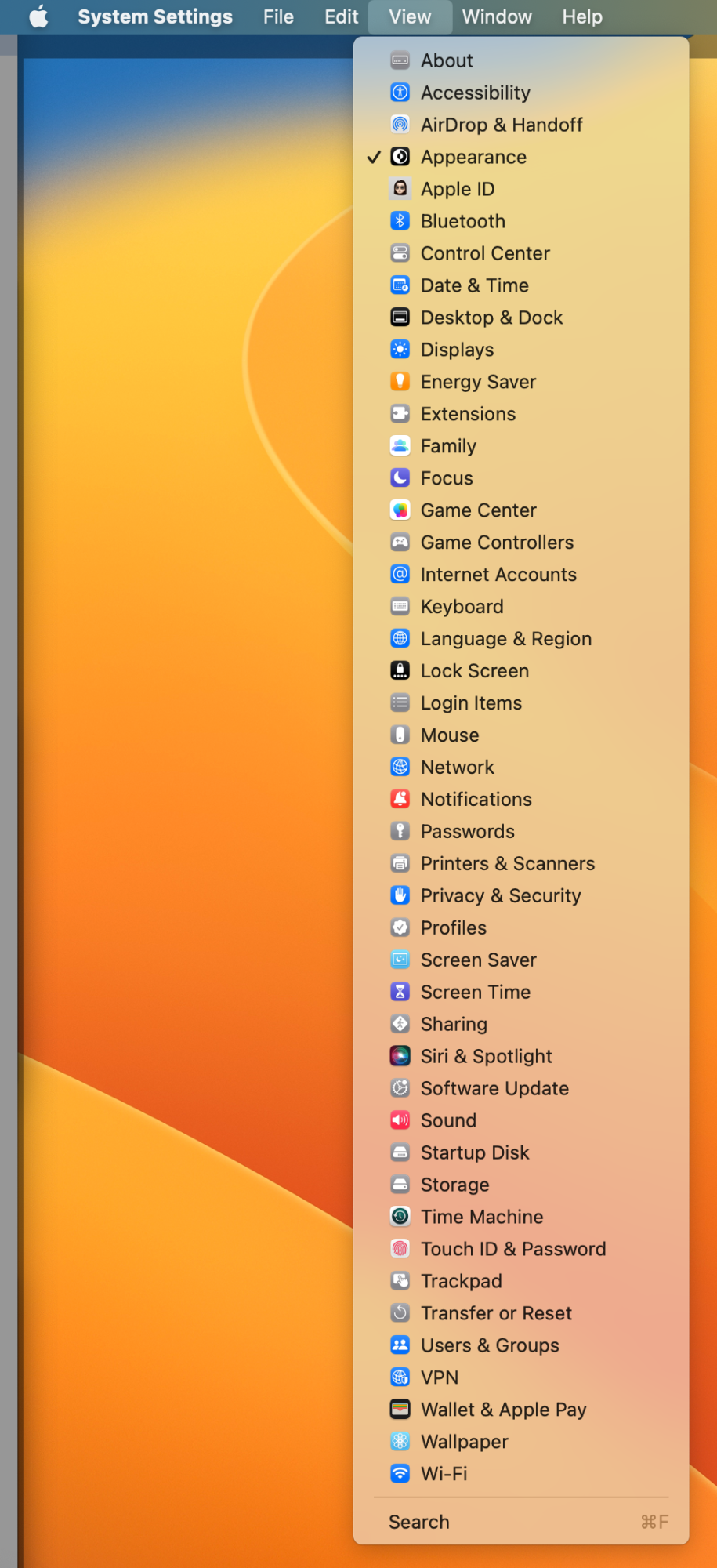

great find ! but the new system prefs has to be the most disorganized mess I've ever seen in a UI. send feedback to apple they need to at least put categories into alphabetical order instead of the random order they have now.
I don't think having it sorted in alphabetical order will be intuitive for most users. Still, you can get them in alphabitical order by clicking the view menu or the dock icon:
