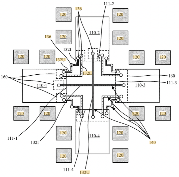

Something that's been commented on is the apparent non-existence of the UltraFusion pads on the side of the M3 Max. Along with that goes the question of how the geometry of the mythical 4-core M3 Extreme might work.
This patent suggests answers (though historically packaging is one of those areas where Apple throws out a lot of ideas then eventually implements only one of them, very unlike say CPU or GPU).
Look at, eg
The big idea here (though the patent does not put it this way) is that this is essentially a chiplet design.
The chips 110 are Max's. The big thing in the middle is a combination of some small chiplets (think something a little like EMIB) embedded in a substrate. As chiplets they incorporate all the IO hardware (SerDes and PHYs) that took up space for UltraFusion on M1 and M2; and as chiplets they can be produced on an older node, as old as makes sense.
So the dashed area of say 110-4 has beneath the chip a whole lot of dense pins that connect to the IO chiplet below it embedded in the substrate. The chiplet then does routing and communicates with the other three chiplets via further routing layers beneath it in the substrate.
This obviously scales us to 4 chips (as far as we go, I suspect, for M3 and M4). What I find especially compelling about this diagram is that it explains/looks so much like the actual M3 Max, in particular the bizarre way the SLC, memory controllers, and DRAM PHYs go about 3/4 of the way up the side of the chip and then just stop. If the area below the chip in that area is reserved for microbumps connecting to the submerged IO chiplets, then the layout makes sense...
This same basic design can easily be used to two chips as an Ultra. It could also fairly easily be expanded to 6 (3+3) chips. Beyond that, I expect something additional will be required; but one step at a time!
So the idea is moving the UltraFusion infrastructure off-chip and connecting the on-chip network to the substrate which then does serialization and routing? Is this feasible? It was my understanding that the physical layer is necessary to transfer data off-chip to begin with. I have zero background in electrical connections at this scale, so I don’t have any intuition what is required. But can one really just connect the internal fabric via micro bumps without running into major issues with the signal?
M1 Max had the same design though. I thought that the other side of the chip is used for IO, which is why the DRAM infrastructure doesn’t extend there.
I do find your interpretation very compelling and it makes sense to me. I’m just trying to understand the evidence better.
Reactions: Argoduck
You're right! I forgot that M1 Max was also "asymmetric" that way.
As for "can you move the Phy and SerDes parts of UltraFusion off the main chip? Well the patent says so!
These things are hard to read if you don't know what you are looking for, but look at the difference between diagrams 1A (existing design) and 1B (new design). There are two big differences.
First is an RDL between the chips and the substrate. This allows some rerouting of signals so that the geometry of how the signals leave the Max doesn't have to match the way they enter the IO chiplet.
Second is the IO chiplets themselves (labelled 160).
As I said, packaging especially seems to throw out ideas a lot faster than Apple uses them! (Or perhaps they get reused in places we don't explore much like Apple Watch or Vision Pro packaging?) But enough pieces of what seems to be required for the next scaling up of M-series seem to be present here.

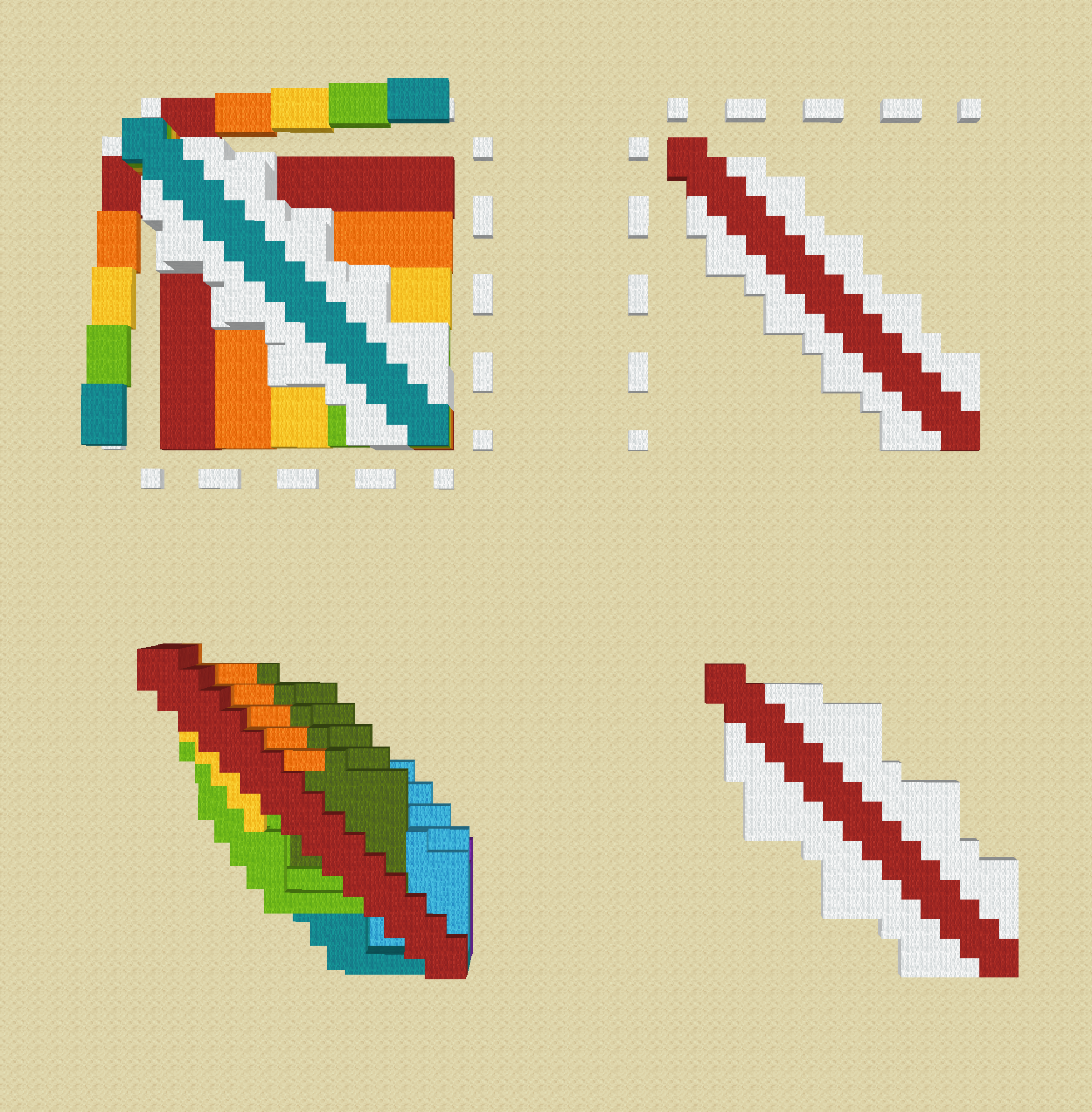

The process of understanding how a matrix is transformed from band form to tridiagonal form:
And the successful implementation, testing, and optimization in the Swift programming language:

The most workable code in highly complex software systems, is code that looks and feels like natural language. In fact, there needs to be a natural language comment before every section of code. Separate complex lines into distinct statements which are easier to interpret. Even if it feels redundant.
When you talk about compressing a billion-step build sequence for a replicating nanosystem, into a megabyte of information, it's all about code and methods to efficiently transform data. Information theory, understanding how many bits are necessary to represent something in memory. And then writing assembly instructions or low-level computer hardware to execute a given goal, such as self replication.
Actually a very good example, even if in a roundabout way.
Because you shot way above my head, into the stratosphere. But the point is well taken :)
This is very similar to how the Apple Developer videos I have watched are presented. So I take it as a confirmation that they are pretty good (classes). Which is what I wanted to know.
Thank you very much 👍
