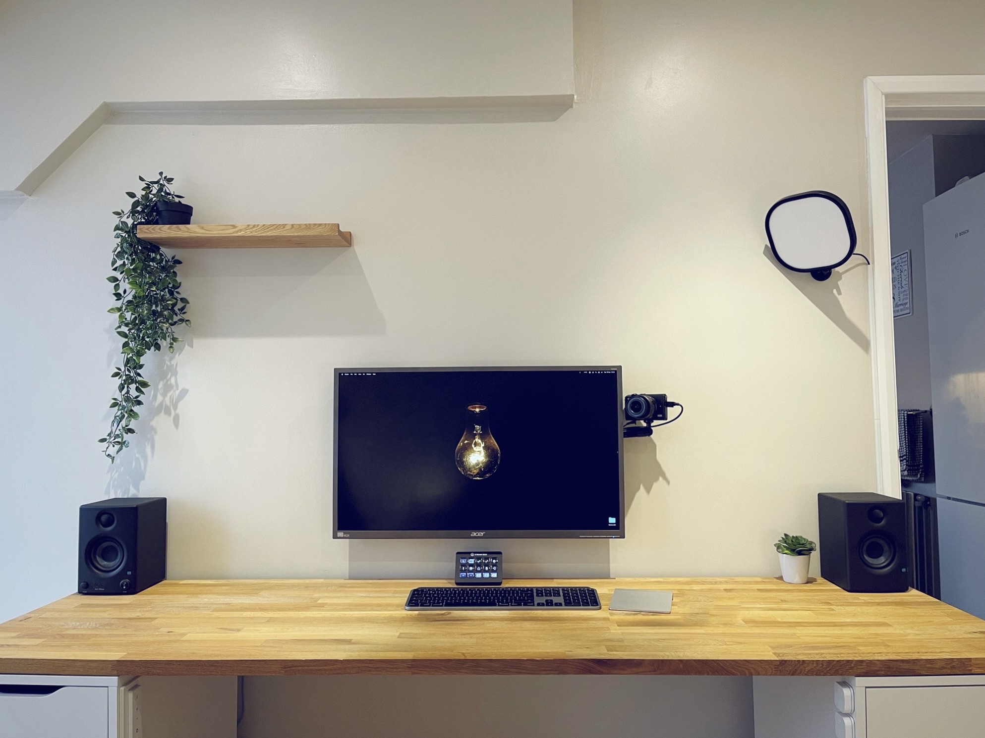

Hi everyone - I'm very close to ordering an Apple Studio Display (PPI is key), but trying to decide between the default stand and the VESA mount option (a clean desk is priority for me). The challenge I have around VESA mounting is largely how to hide the power cord (I already have cable runs inside the wall for USB etc.), but I'm also super interested to see any examples of the VESA version being mounted directly on a wall.
Does anyone have the ASD mounted directly on a wall - I can't find a single example via Google, Instagram, Pintrest etc. - if you have done this, have you any regrets?
For reference, here's my current setup with an Acer 32" 4K 326HK monitor:

Thanks - that's a handy accessory, though with the ASD I'll have a webcam built into the display for basic use... for high quality needs I've found the angle shown to be helpful because of the background, and I tend to look into the camera

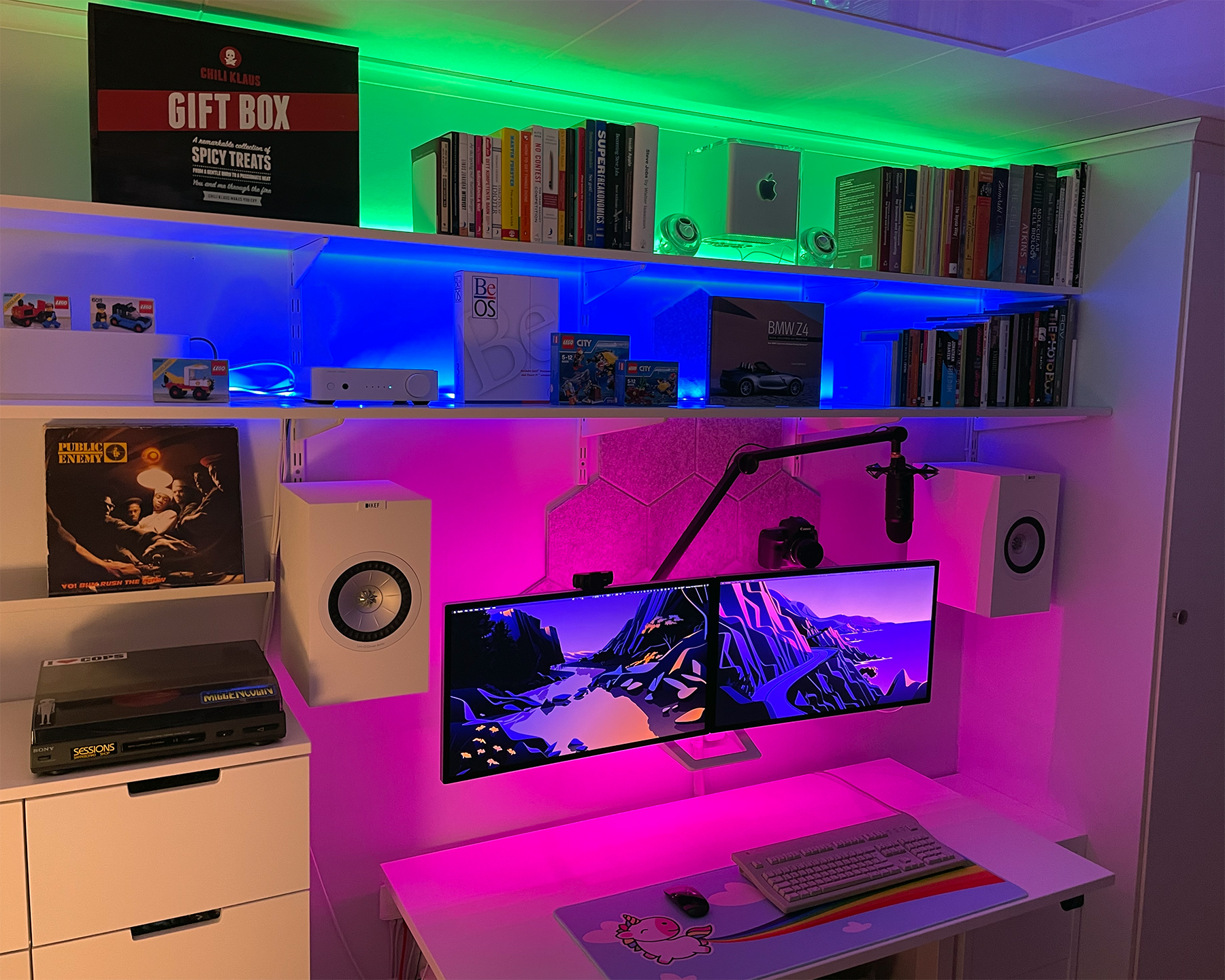

I experimented with both desk mount and wall mount:
It is available for single monitor too:
The vertical range of the arm is 29 cm.
This is not quite enough to adapt for a standing desk. I have installed it so that it is perfect in its lowest position for sitting, but when I raise the desk to standing position the monitors are about 10 cm lower than I would prefer in their highest position. Also, it is annoying to have to adjust the monitor height separately.
I felt the tradeoff was worth it to not have a stand clamped to the desk, but there are obvious ergonomic and practical benefits in this case. If you do not have an adjustable desk I see no reason at all to avoid wall-mounting, unless of course you need to be able to move your monitor around.

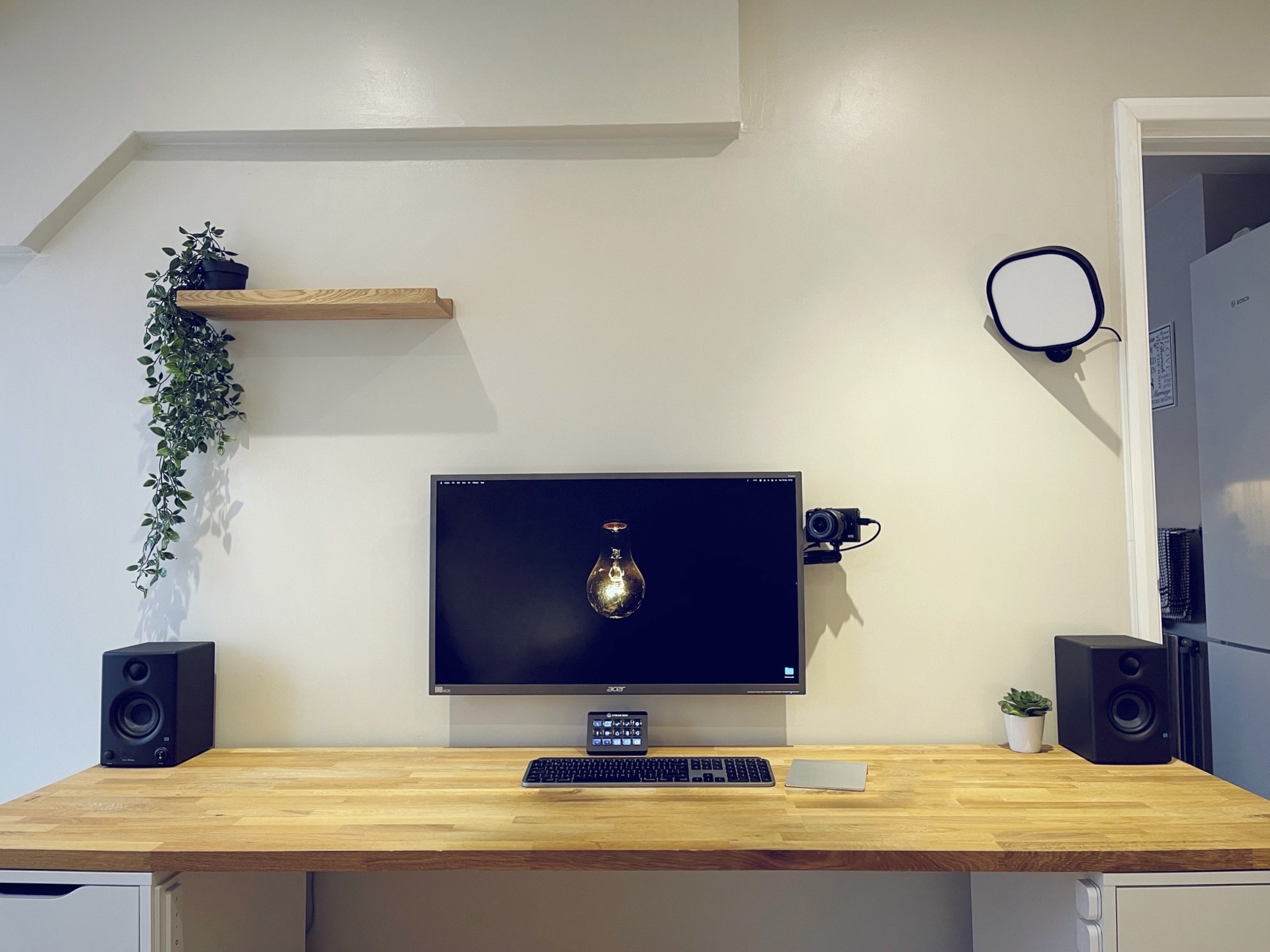

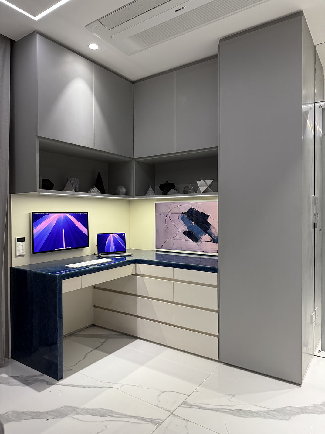

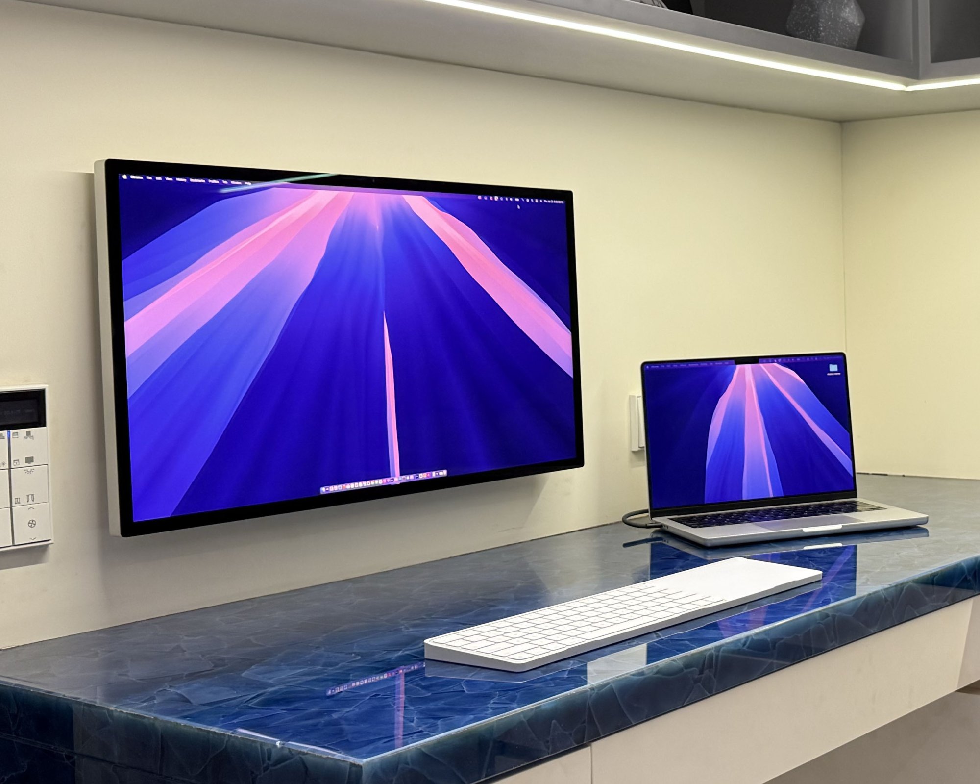

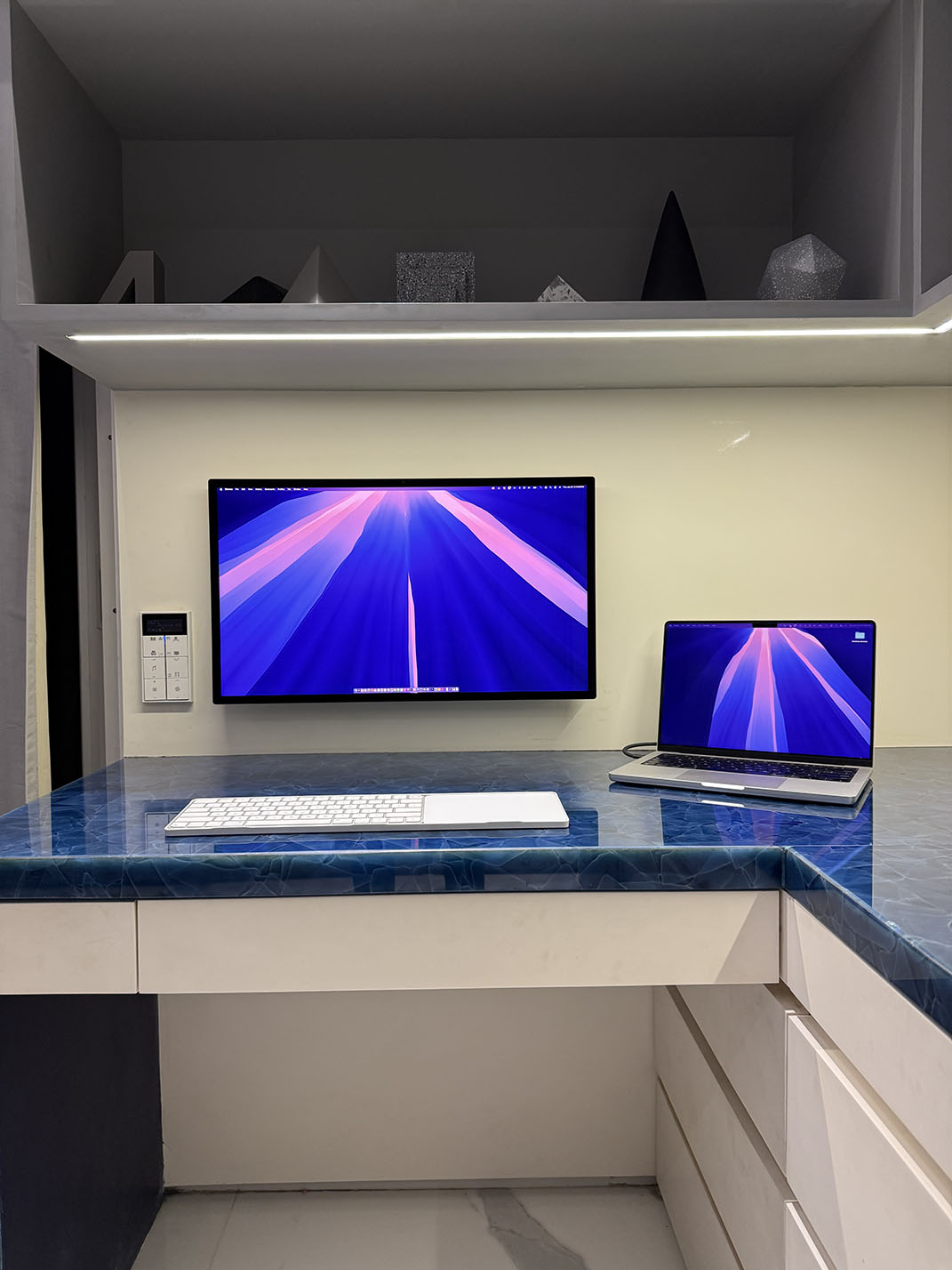

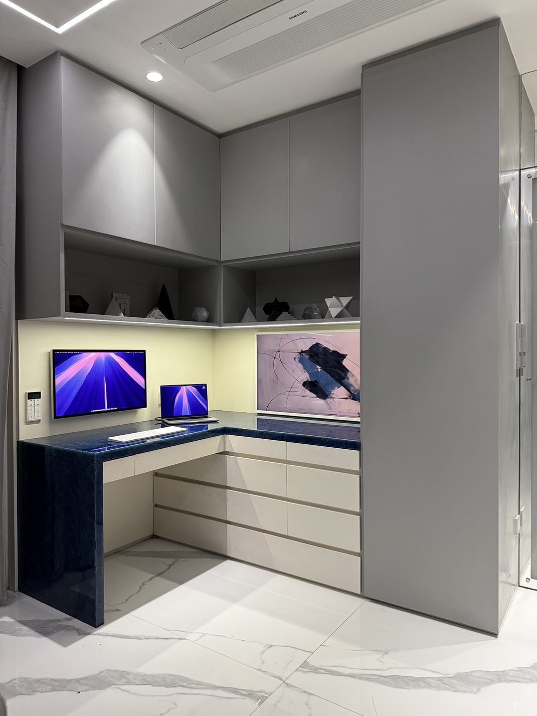

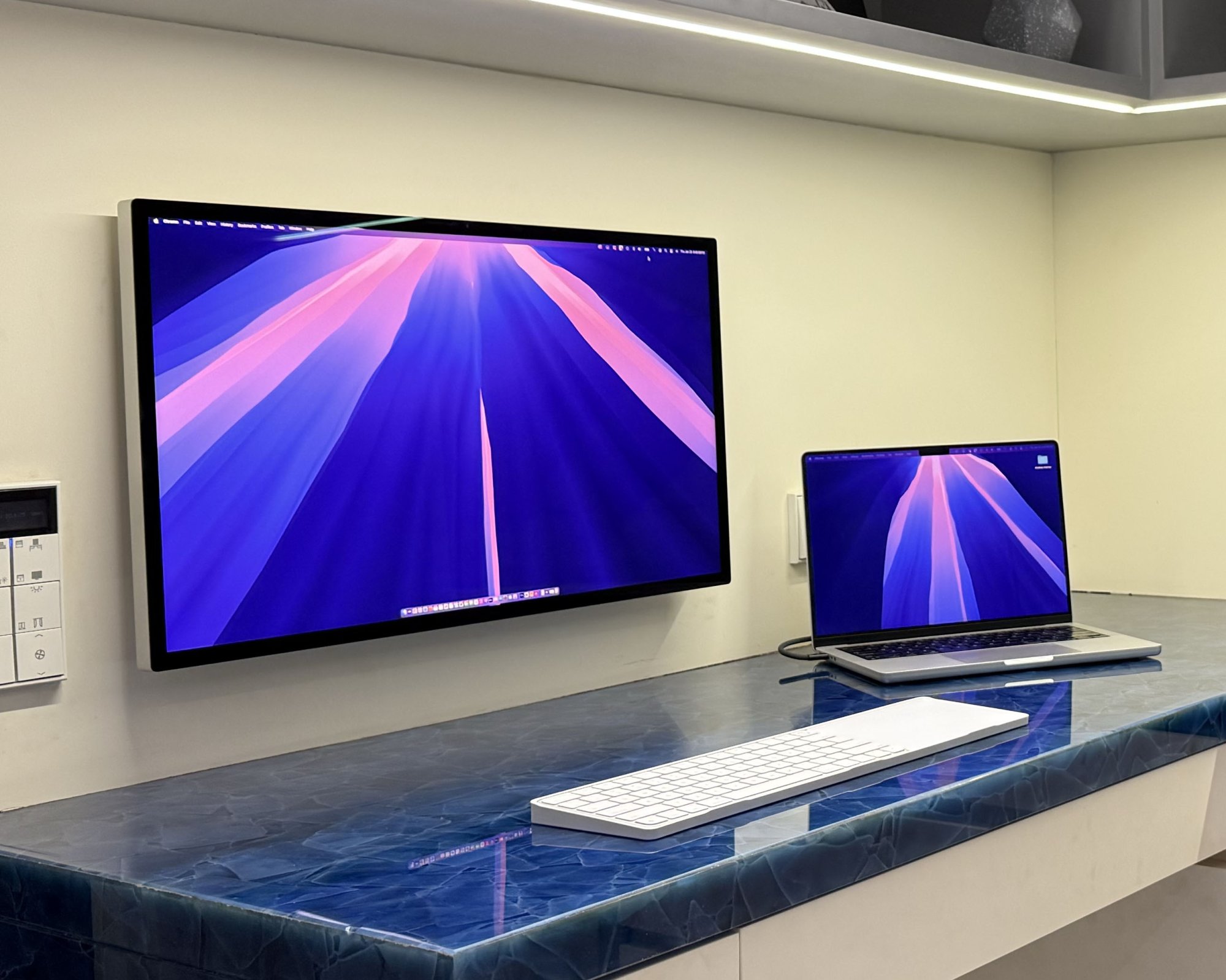

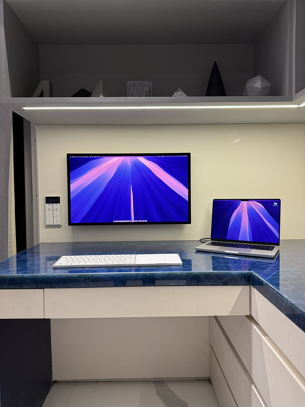

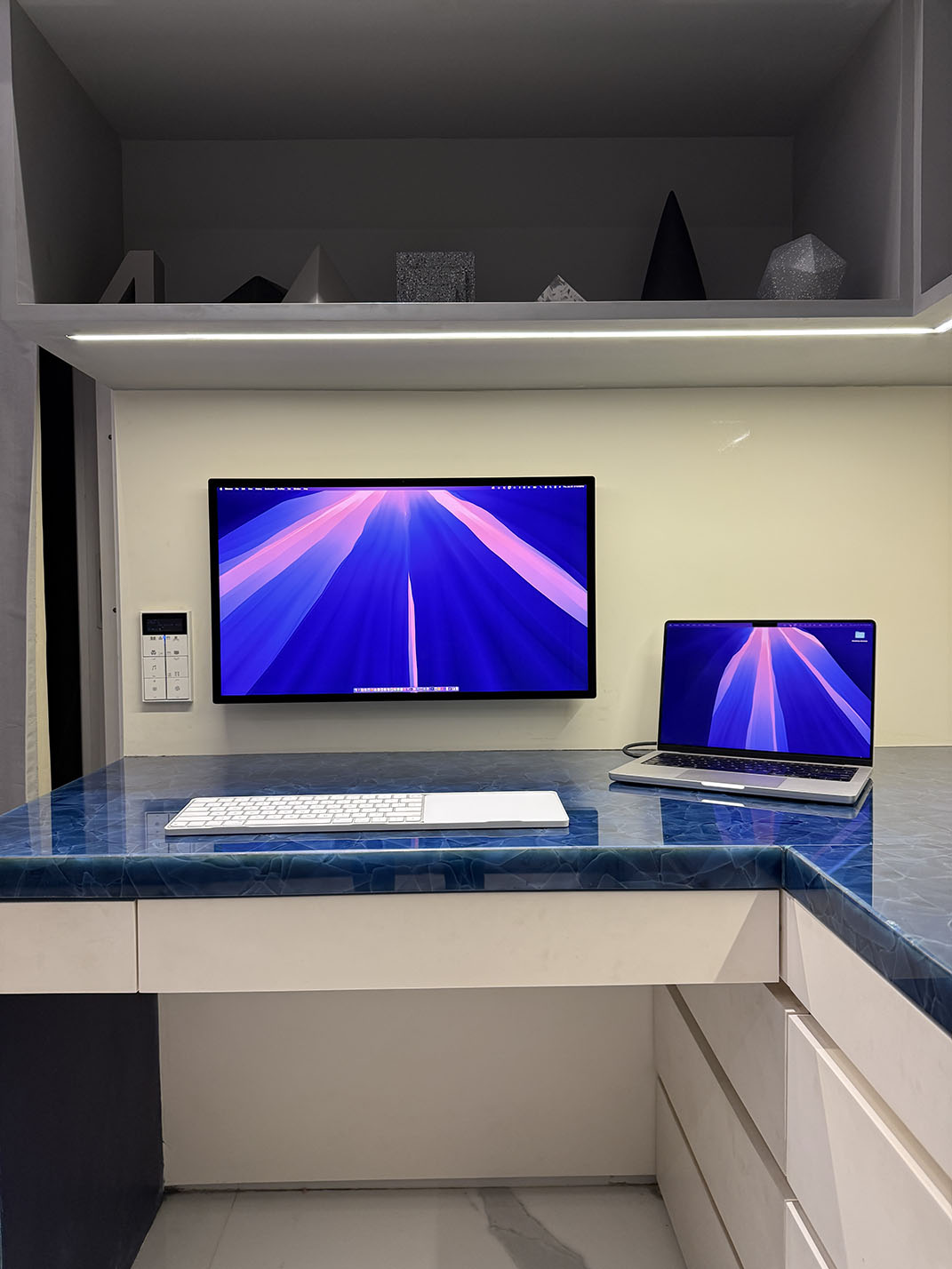

In case anyone is still interested, I have wall mounted my Apple Studio Display.
I managed to do it with a half inch gap from the wall. With the vesa mount frame of the ASD, the gap between the main body of the ASD and the wall is about 3/4 of an inch. Here's how I managed to do it:
- Used the Mount-It! MI-203 wall mount
- Used a right angled connector for the thunderbolt cable
- Drilled a 1 inch wide round hole into the wood panel behind the monitor (about 1 inch deep as well) so the power cord could go into this recess first and bend back towards the ASD.
I'd done a reddit post, with pics below.
