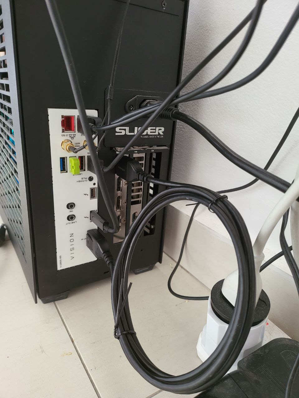

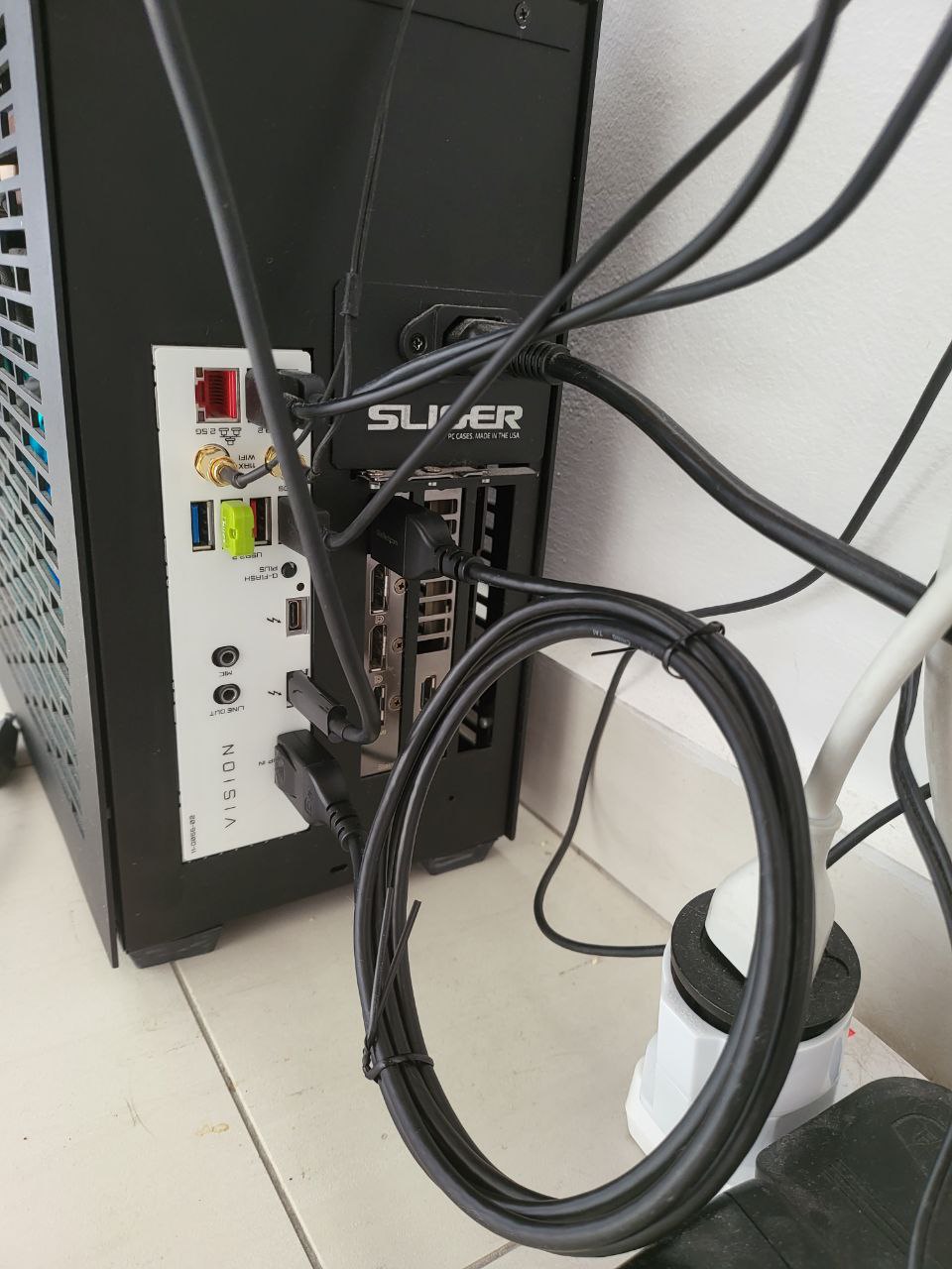

Hey guys! I plugged ASD to the following Win11 config: z590i Vision D, 10900K, rtx 3080. GPU is connected to DP-in on MB via DP 1.4. And ASD goes in TB4 MB slot. Monitor is black, but windows recognizes it and uses just ASD speakers...?? ASD itself works well when I connect it to mac (with any of the used TB cables - apple's or belkin's)
What has been done so far:
1) ASD is updated via mac os Ventura to the latest firmware
2) Win Nvidia drivers are up to date
3) I installed TB drivers from gigabyte website, but I'm not sure if it's finishing installation properly as I don't see any final message about installation success.
4) I don't see TB settings in bios for some reason, is it possible that it works by default and no setting should be present?
5) I flashed the bios to the latest version + I tried 3 more older revisions but no luck.
Also I found that the front M.2 slot is not functional on my MB for some reason, not sure if it's related
If someone could share his experience or any suggestions I'd greatly appreciate it..

I figured out that my front M.2 slot is not working because I have 10th gen CPU which is limited by PCI-e 3.0. Front m.2 slot works only on 11th gen intels with PCI-e 4.0 support.
I wonder if I don't see any thunderbolt settings in bios for the same reason..
Try the other TB4 port. According to the manual, you're plugged into the correct TB4 port but worth trying the other TB4 port. Also try a different port on the back of the GPU. According to the Z590i Vision D manual, there should be BIOS settings for Thunderbolt present. Do you have a separate monitor you can hook up to look at settings (Thunderbolt Control Center, Device Manager, Nvidia Control Panel)?
