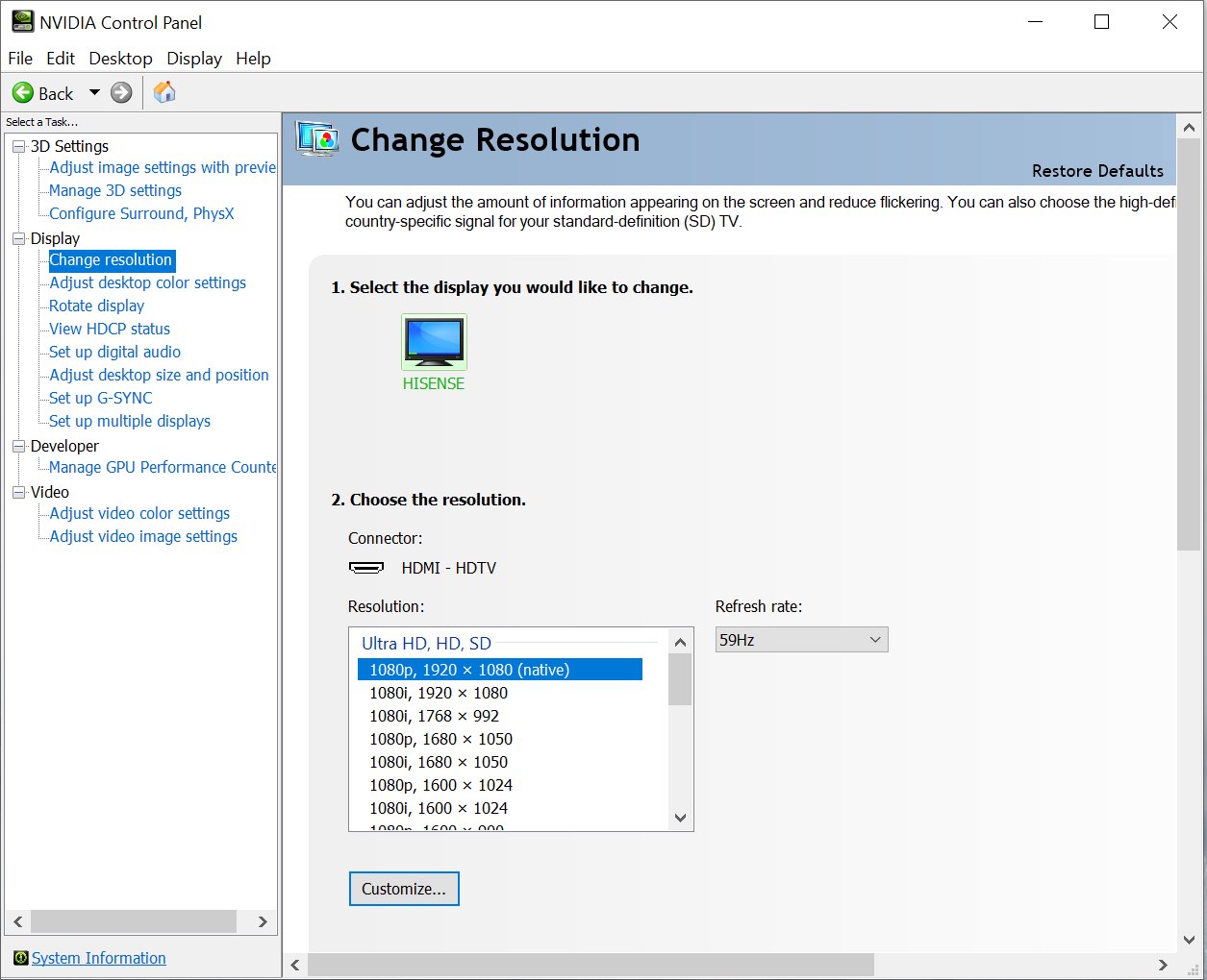

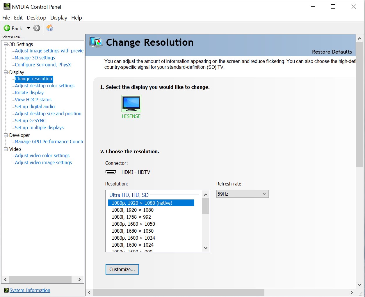

In the "Change resolution" tab, there is a "Customise..." button where you can add other display modes.

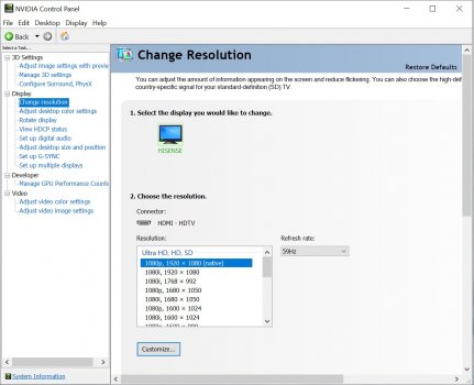

Attaching a screenshot, it looks like I can only get to show if I plug the TV in and then it only applies to the TV.

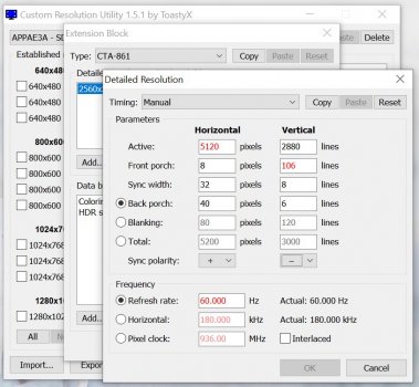

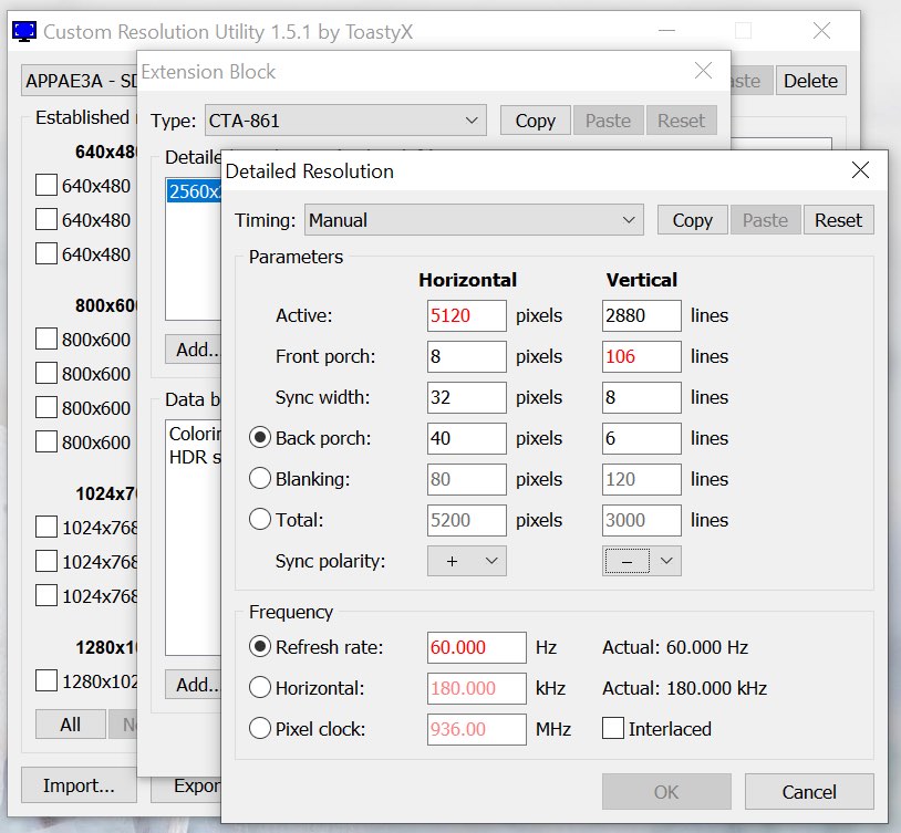

What to try next:
- Import your new EDID, deleted both of the Display ID blocks so only the CTA block remains. Edit the 2560x2880 timing in the CTA block so that it is a full 5120x2880 timing:
Code:
    DTD:  5120x2880   60.000000 Hz  16:9    180.000 kHz    936.000000 MHz (aspect 16:9, no 3D stereo, preferred)
               Hfront    8 Hsync  32 Hback   40 Hpol P
               Vfront  106 Vsync   8 Vback    6 Vpol N

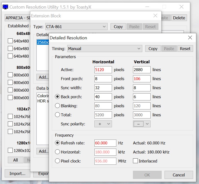

I think I entered that correctly but CRU doesn't seem to like it? Maybe the 106 was supposed to be 16? Even then it doesn't seem happy with 5120
- Or, Import your new EDID, delete the last Display ID data block, then in the remaining Display ID data block, delete the (VESA), OUI 3A-02-92 Vendor-Specific Data Block (0x7e).
I think I deleted the right part and no luck. Attaching the EDID for reference.
