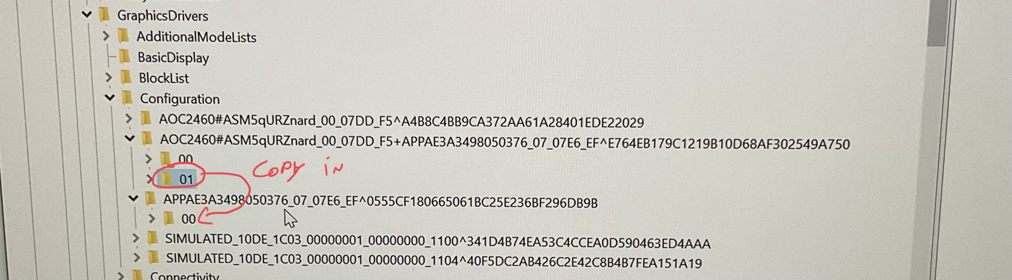

i solved the problem i explain it here, first i followed this Guide to impotare as first screen not the apple studio display, after which I changed the screen size by setting 4k 60hz after which if you disconnect the monitor he will try to put 5k again and then returns to not work, To solve the problem just go to the registers and copy the register of the Display1+StudioDisplay in the register single studio display and this made it work I solved the problem.
Access in the folder: HKEY_LOCAL_MACHINE\System\CurrentControlSet\Control\GraphicsDrivers\Configuration

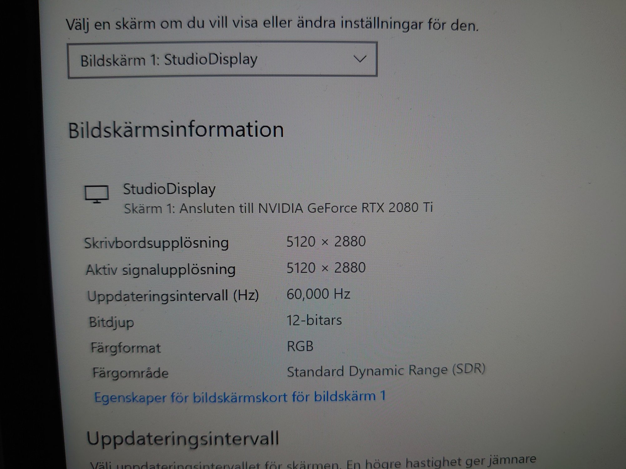

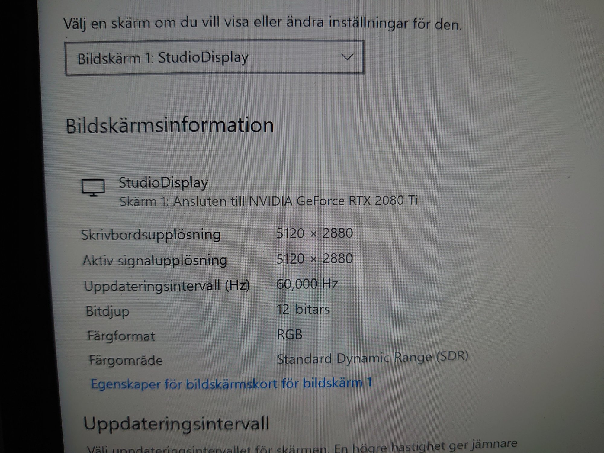

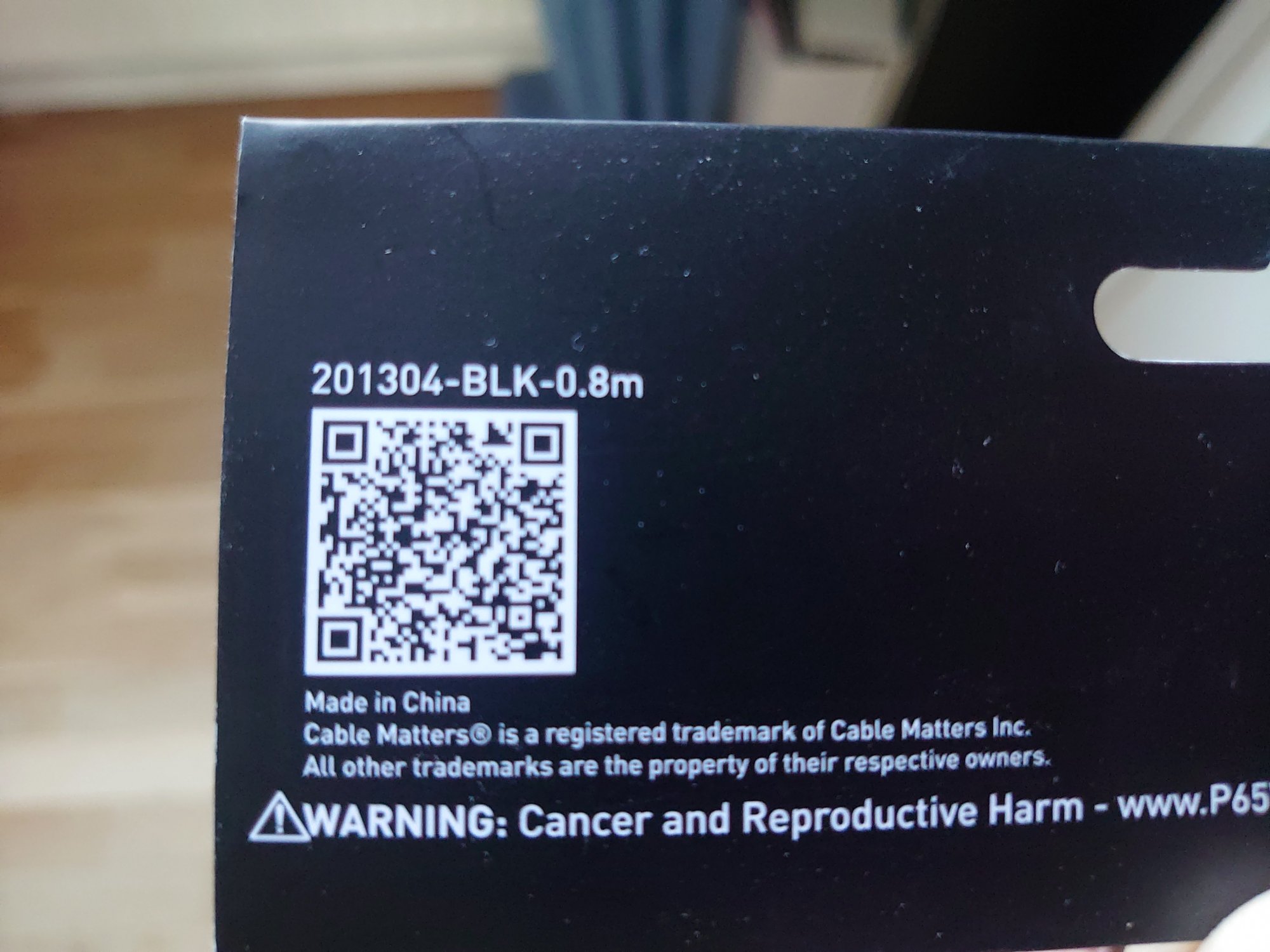

Exact same issue with a Cable Matters certified 40Gbps USB-C cable, picture is perfect with full 5K60 resolution at 8, 10, 12 bit colour, doesn't skip a beat. Then I get sound distortion (only) occationally, sounds like sort of static sound for a few seconds. Have played with all kind of sound settings and have tried moving the GPU to different slots. Tried different power outlets.
I don't think the cable is the issue. I did a test install of Windows 11, same thing.
Anyone have a clue? USB-C connected straight from 2080 TI USB-C out to input of Apple Studio Display. The GPU supports DSC so that's what it's using I suppose.
Sound is perfect when using the Mac Mini M1.

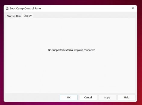

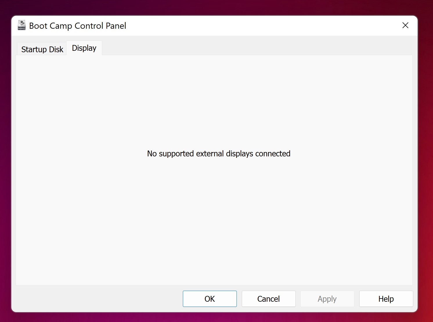

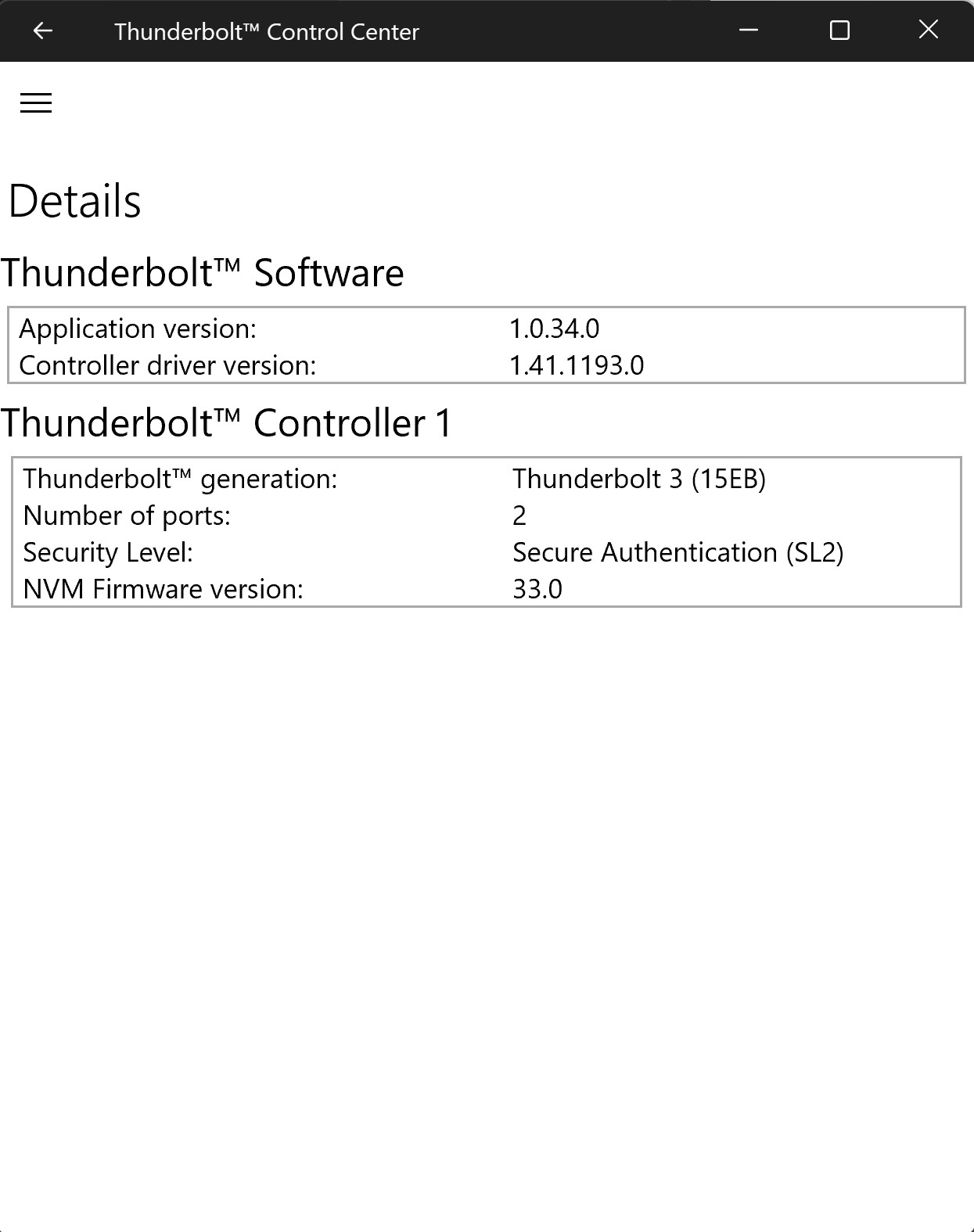

The Apple ThunderBolt4 cable included doesn't work,It turns monitor on for a few secs then goes off.

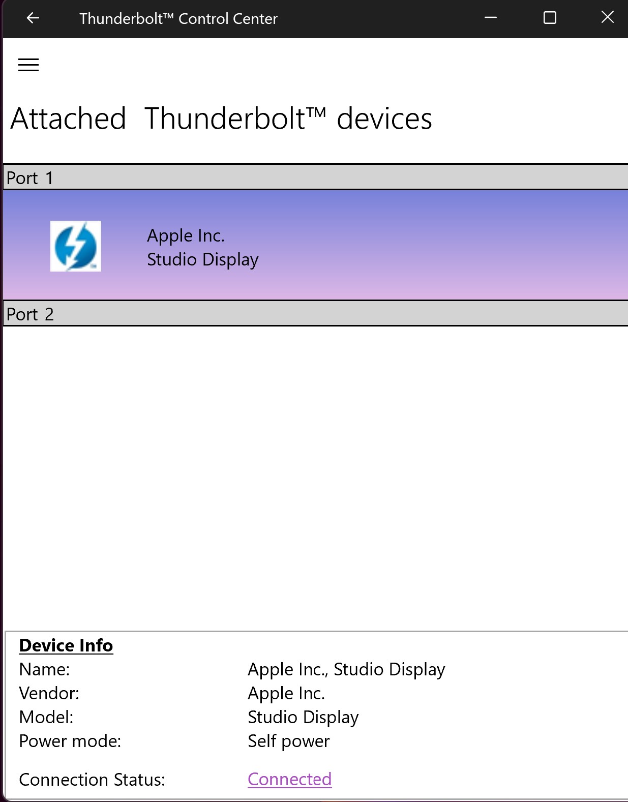

I purchased Plugable Thunderbolt 4 Cable so My Studio Display works fine with Windows 11 but sound & webcam & mic & usb hub aren't work.
Updated bootcamp drivers but no luck,Anyone have same situation ?
I'm using i9 9900K | Gigabyte Z390 Designare discrete thunderbolt 3 support with 3070ti
Thank you so much.
For the sound/webcam/mic issue, ensure you have the latest TB driver for your motherboard, here: https://www.gigabyte.com/Motherboard/Z390-DESIGNARE-rev-10/support#support-dl-driver-thunderbolt
@BeatCrazy thank you so much .It already updated to newest version(bios&thunderbolt firmware,ASD is 15.4 )

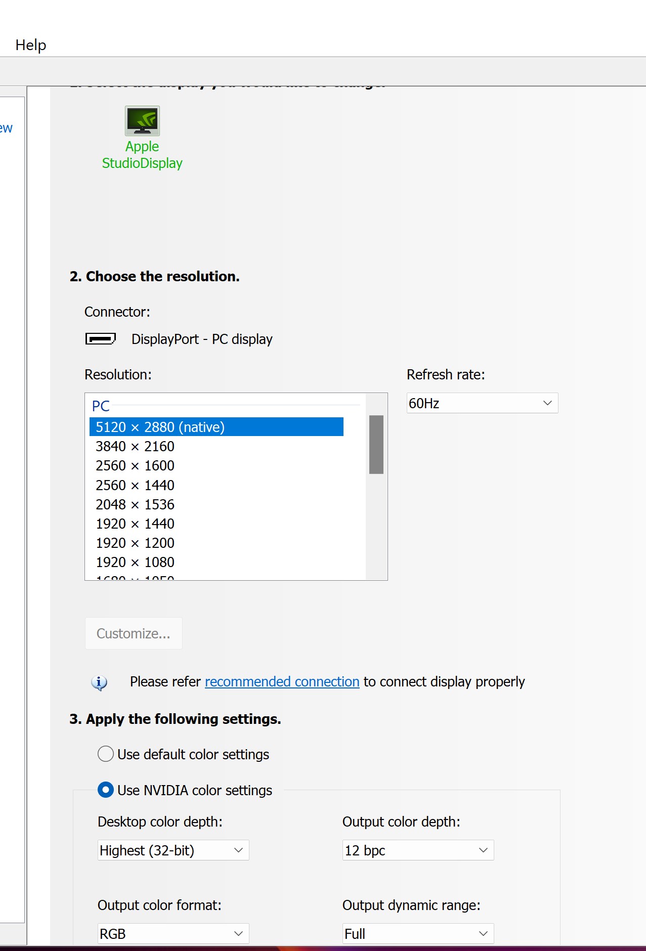

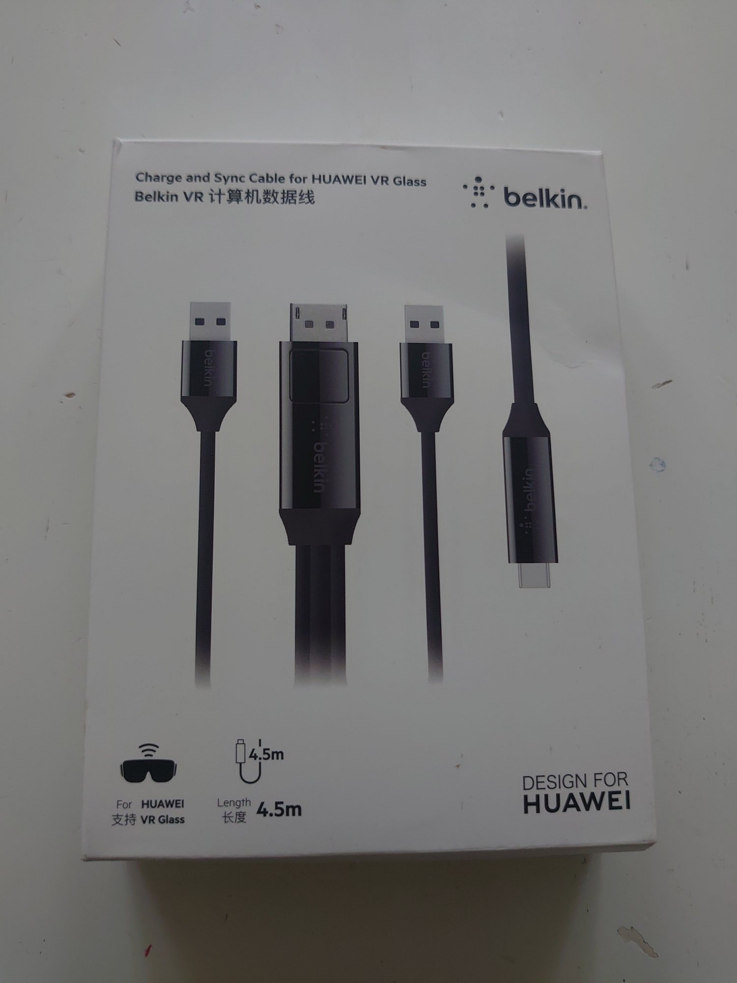

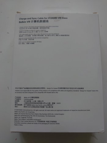

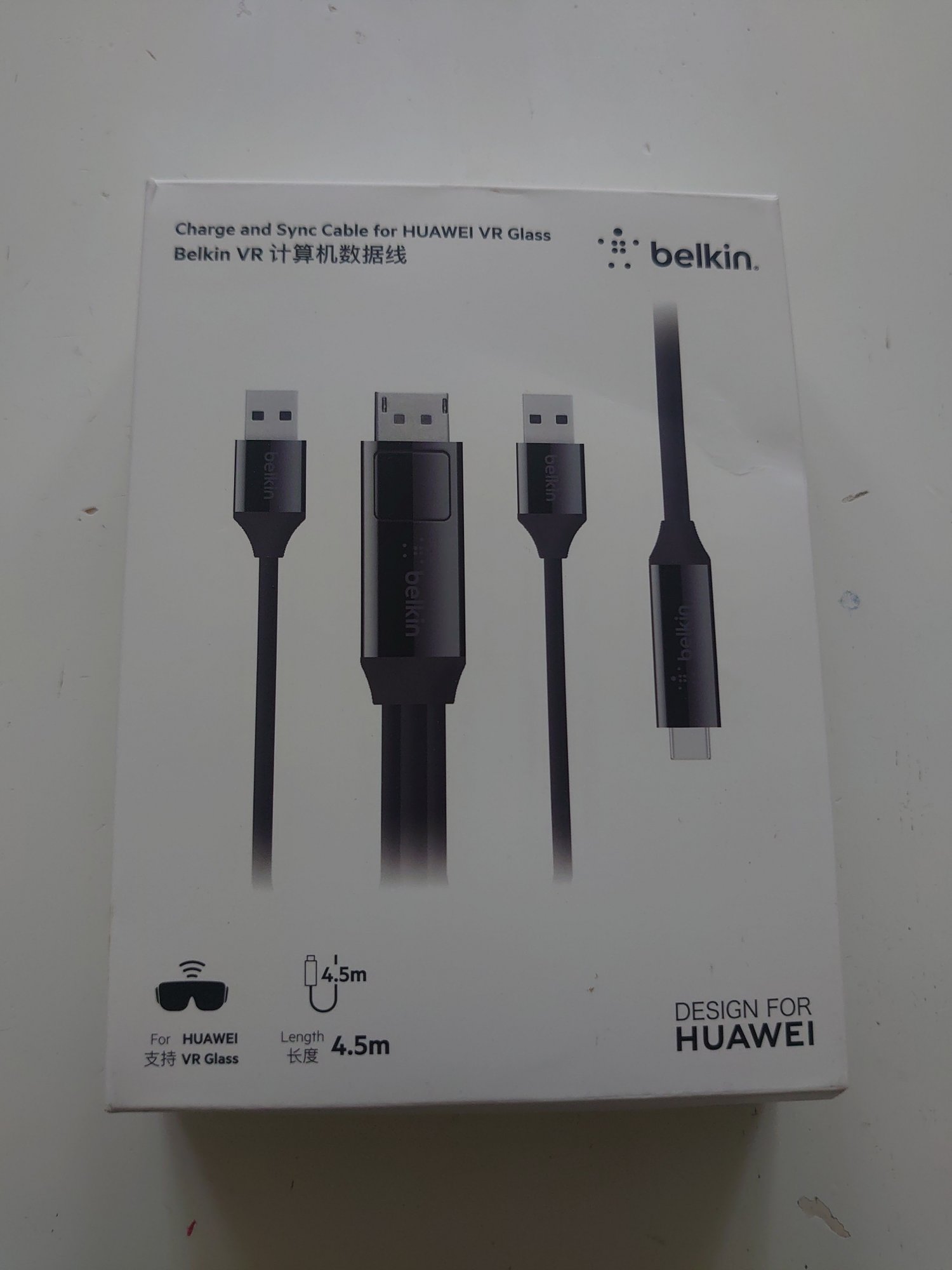

Received my Belkin VR cable today, happy to report it works perfectly!
Full 5K60 at 8, 10 and 12 bits, sound is perfect and the disortion is gone. GPU is a 2080 TI which has DSC support.
Bought it here:
Belkin VR Charge Sync Computer Cable
https://bit.ly/3FPoDZH

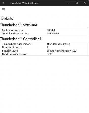

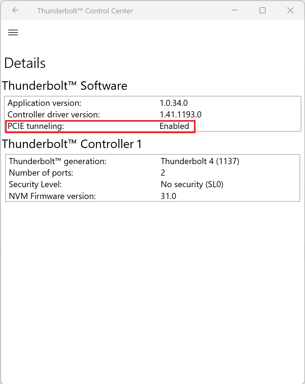

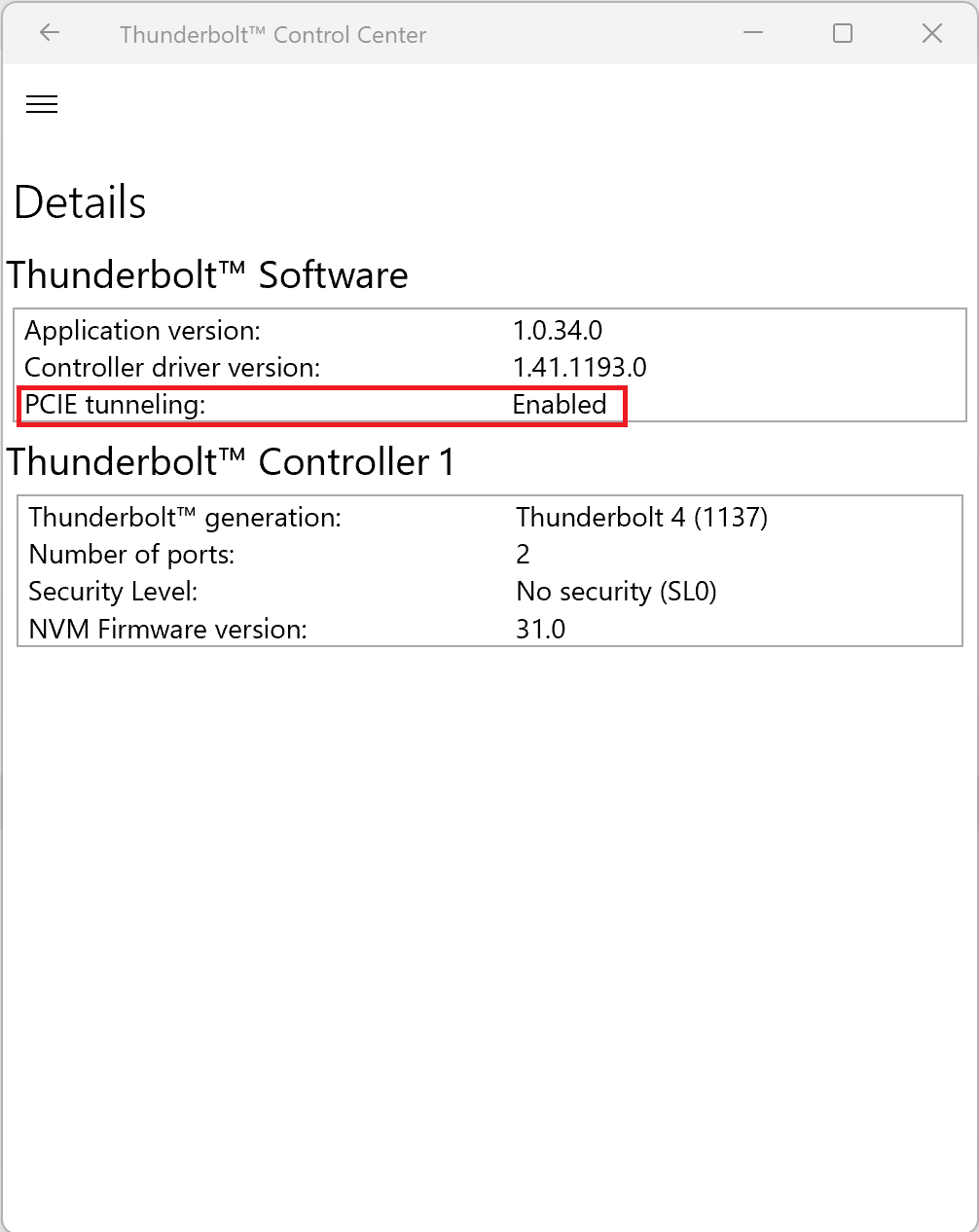

Maybe it's because of "PCIE tunneling". Here's something I found before:
Recent Intel Thunderbolt firmware connection manager has support for
another security level, SL5, that disables PCIe tunneling. This option
can be turned on from the BIOS.
It might be the problem but unfortunately it doesn't have any kind of that feature in BIOS(i think it does available in THB4).Thank you anyway 😉
