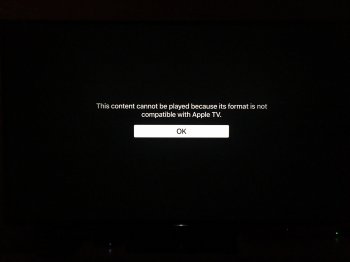

As far as I can tell, aTV 4K does not play back 4K@60fps at all. I have not managed to get any 60fps 4K clips to play back, I only get the "not supported format" message on the screen.
Your software doesn't like your media. Could be a million different reasons from incompatible video and/or audio formats, medias encode is too complex for the software and/or hardware, etc.
Keep in mind the player software still needs to support a format/codec regardless of whether the hardware can natively or not.

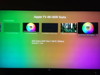

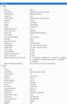

My video is iTunes compatible, see the attached detail from Media Info. Also iTunes happily ingests it.
Briefly I had thought that the problem is in the Main@L5.1@High profile.
SES Astra demo you referred to, has Main 10@L5.1@Main.
But to be frank, the QT player of tvOS still does not play it!
Infuse is a different story, it seems to be decoding on its own devices and does not rely on the QT engine from Apple.
