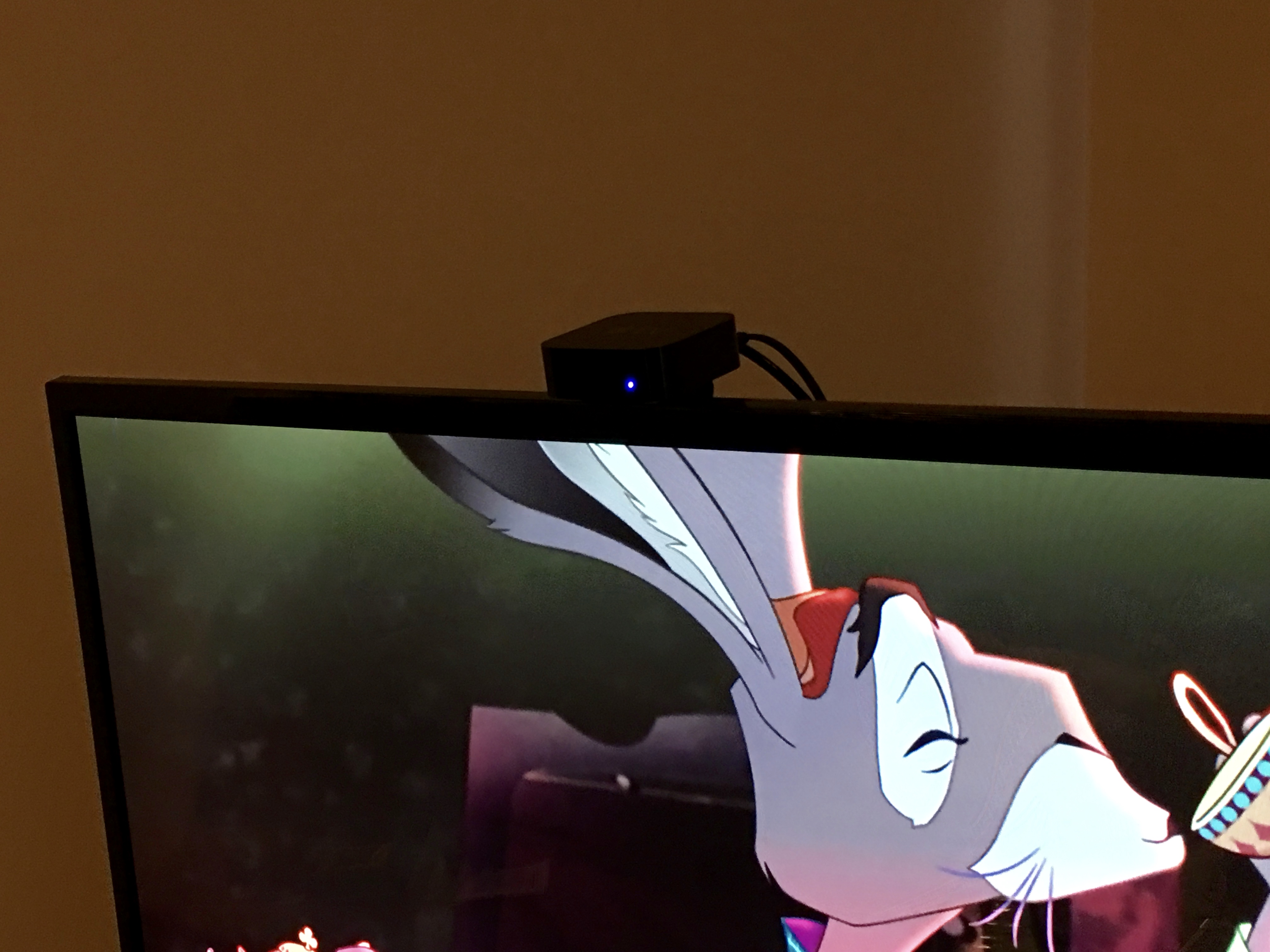

I didn't hide my ATV4, but I did make a mount for it for the top of my TV.
Due to a new baby, I was trying to eliminate the devices I had on my entertainment shelf, but I did not want to remove the ATV4. I couldn't hide it behind, because my family uses IR remotes as well as the Siri Remote.
So I made this.
The photo is at a high angle to show the mount and the cables, but sitting right in front of the TV, it blends pretty well with the Samsung.
