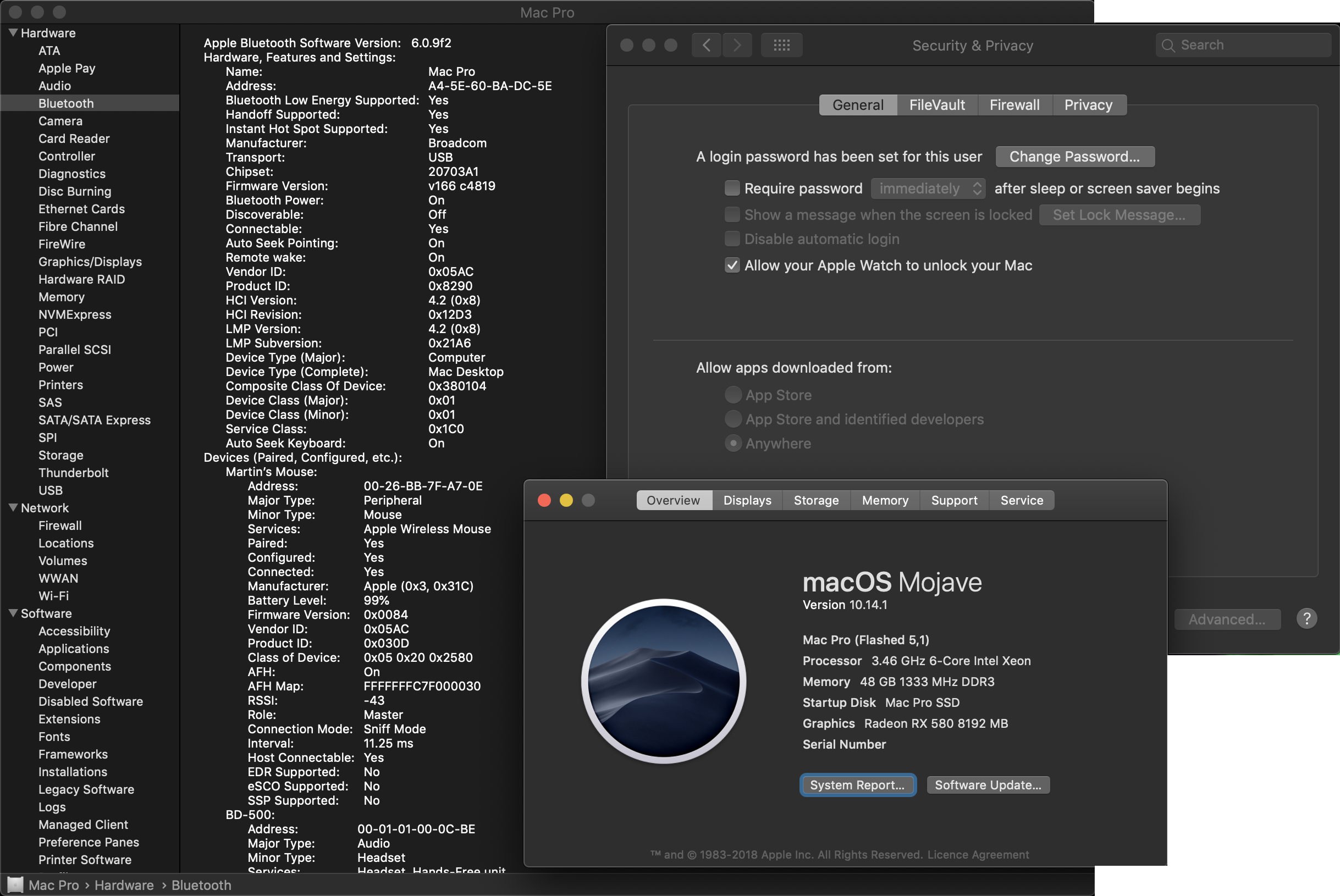

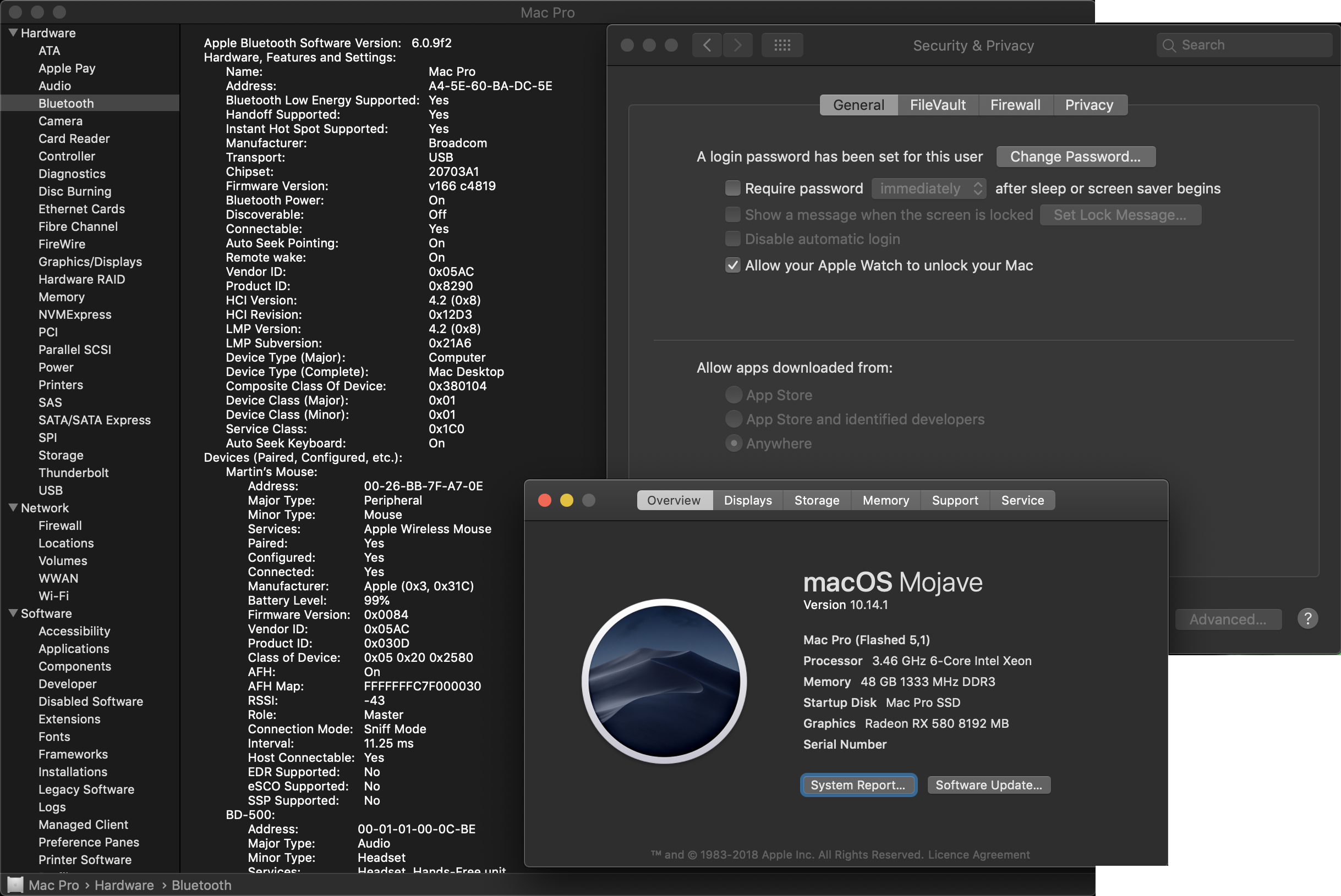

Not entirely true, because that's assume with stock hardware.
If the user upgraded the BT / Wifi card, even older Mac can use Apple Watch unlock.
e.g. My 2009 Mac Pro didn't even come with Wifi card. But after I install a BCM943602CS, I can use Apple Watch unlock and all other Handoff function.

I tried searching through this thread to find out about the Mini, but couldn't find anything relevant. So...
What sort of WiFi/Bluetooth card is used in a Mac Mini 6 (i.e. 2012) and can it be exchanged with a later one to enable 802.11ac and hence Watch Unlock etc?
Is there a ribbon cable connected BT4/ac card that can be used to enable this?
The 2012 Mac mini use a different connector than the 2014 Mac mini. So, I don't think it's that possible (at least can't be a plug and play solution) to achieve that by "replacing" the wifi card.
However, it may be possible to install a USB BT 4.0 dongle to active this functions (may still required CAT to patch the kext).
Yes, I've updated my cMP and also my Retina MacBook Pro to later wireless cards, but they're either a simple swap or there's an adapter available. What I've not been able to find is a newer card with the ribbon connector of the Mini. Sounds like no-one else has either.
