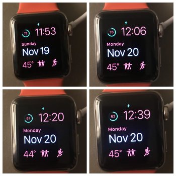

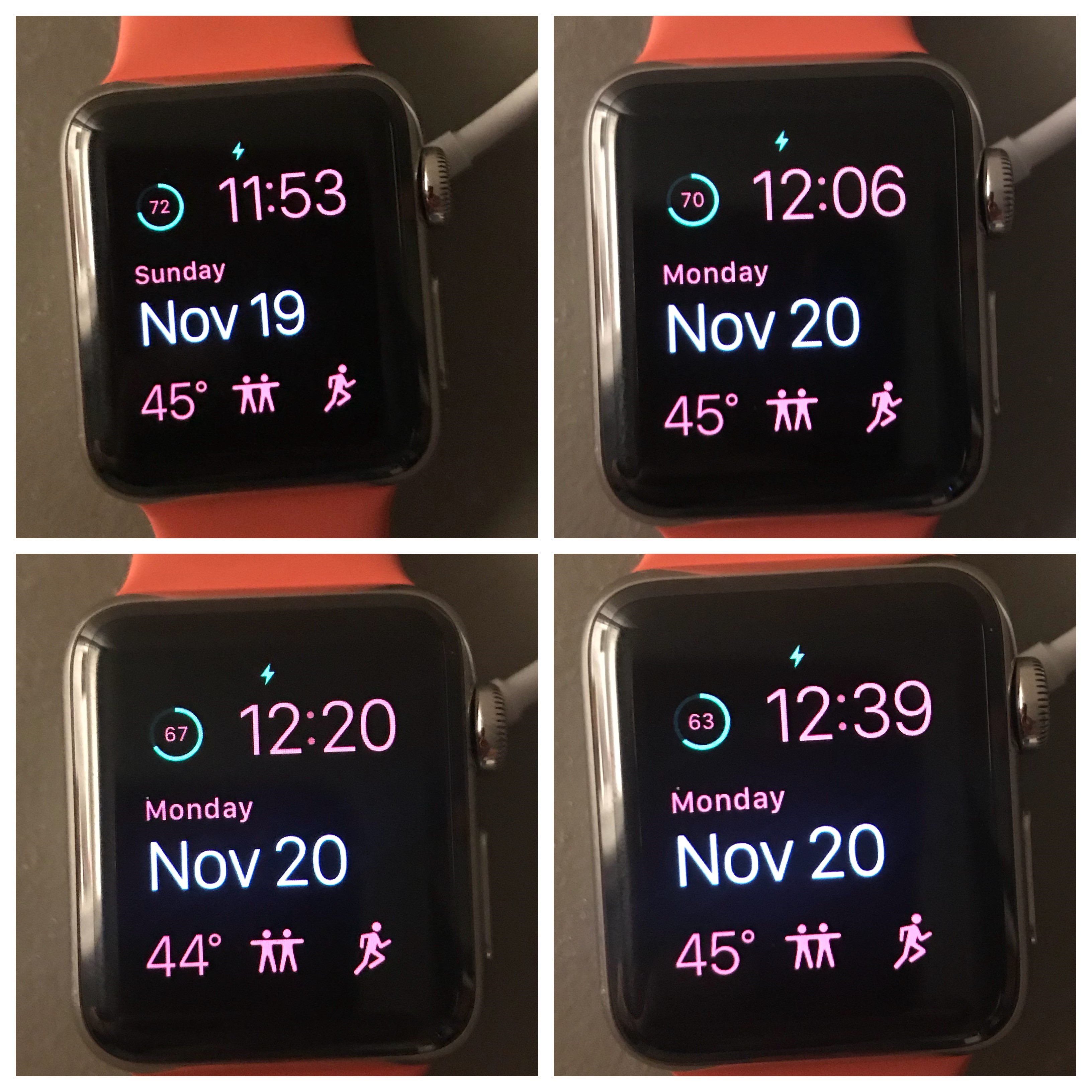

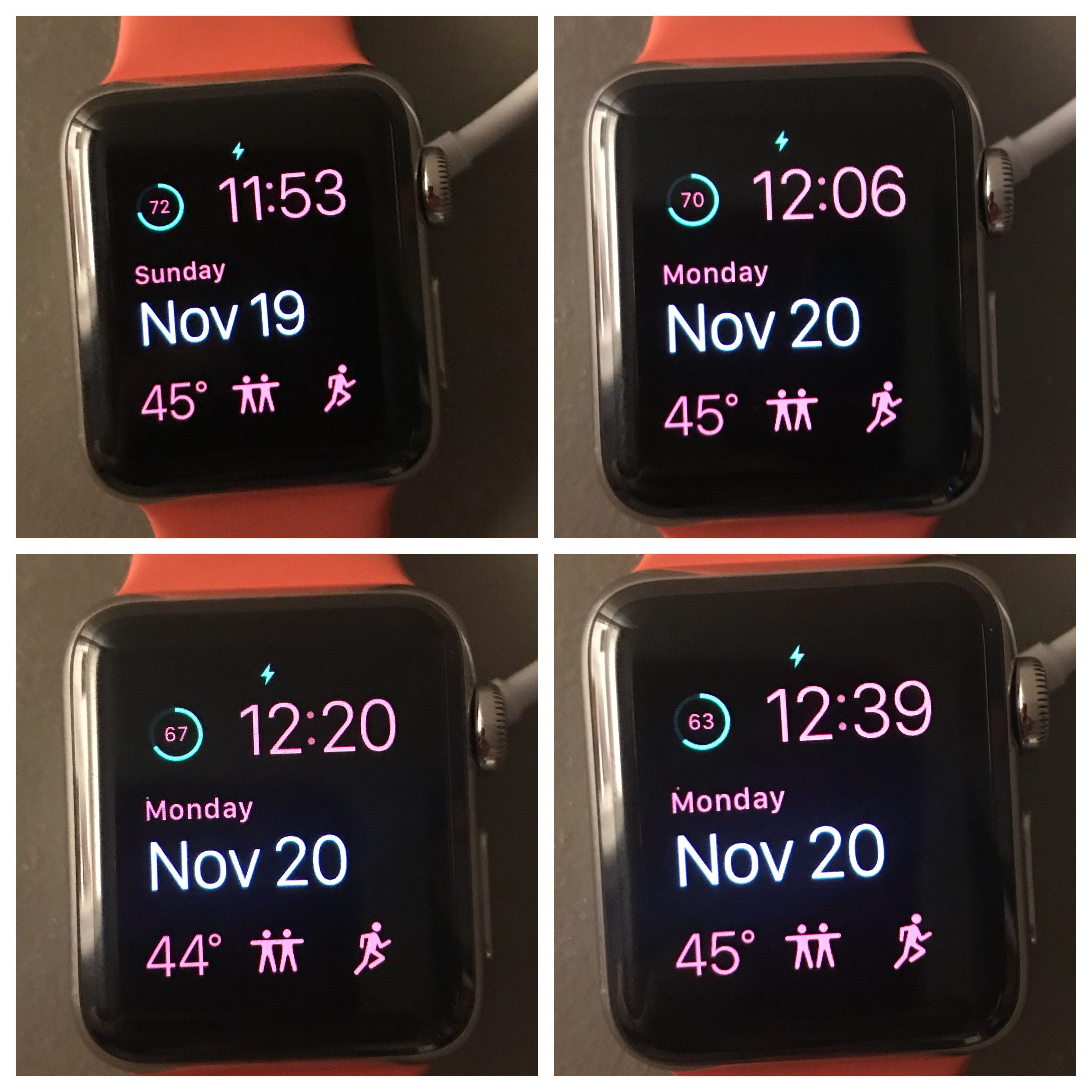

I am having this issue w/ my series 2 watch. I'm on watchOS 4.1. I have reset both the watch and my phone and restored from backup as well set both up as new. I took mine into Apple and they replaced the watch. I picked up my replacement last night AND IT'S DOING THE EXACT SAME THING!!!! Ugh!!! I'm going to try to pair to my mother's iPhone 6 to see what happens.
Have you tried disabling the passcode on the Watch?
I remember Apple did put a fix in for Series 0 and Series 1.... They may need to extend it to the Series 2 as well.
Just out of curiosity, is it a 38mm or 42mm Watch?
I haven't tried to disable to the passcode. I just paired the watch to my mother's iPhone 6 and it's working fine even w/ the passcode. Going to pair to my iPhone 7 again and see what happens. Will disable passcode if it goes back to not charging.
So I re-paired to my iPhone 7 and sure enough, it wouldn't charge. I disabled the passcode and it wouldn't charge. I turned off my phone and the watch charges (also charges with phone in airplane mode too). So I am 99.9% sure it's my phone is causing the issue somehow. Will be making an appt at the Apple Store for next weekend.
