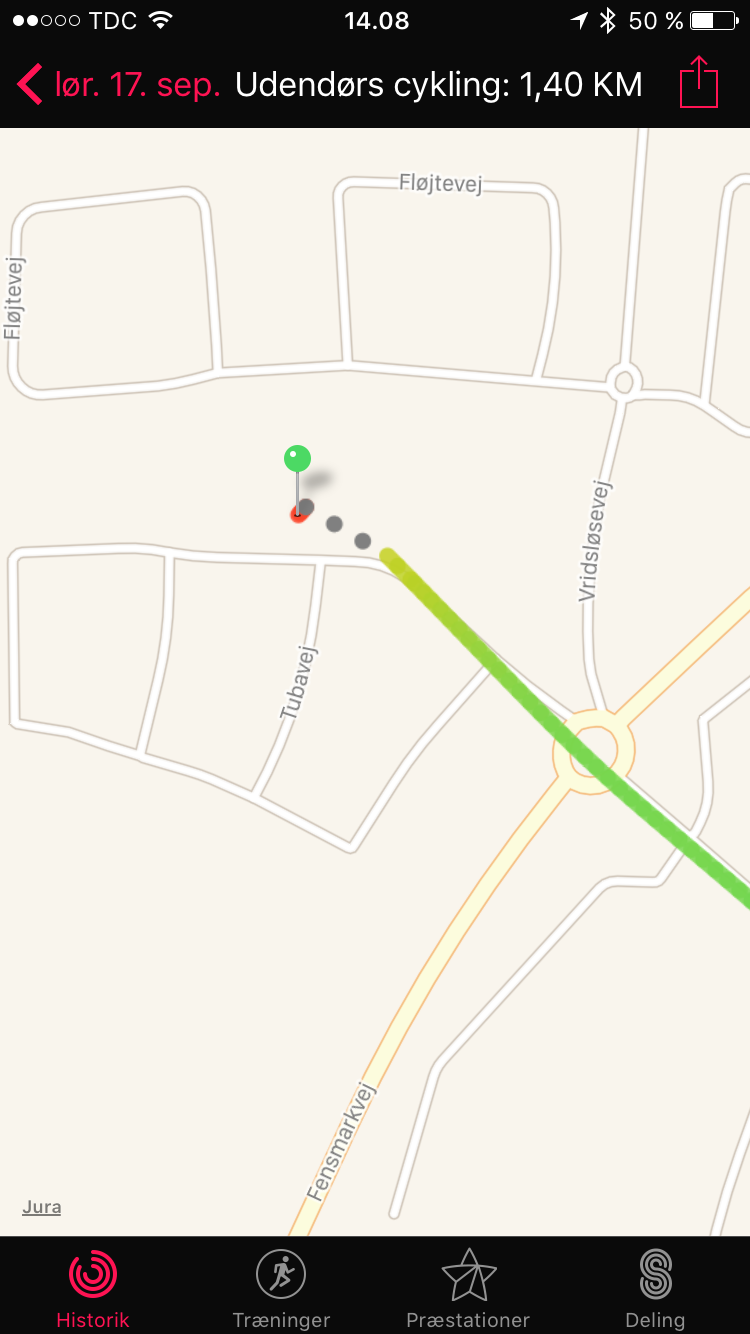

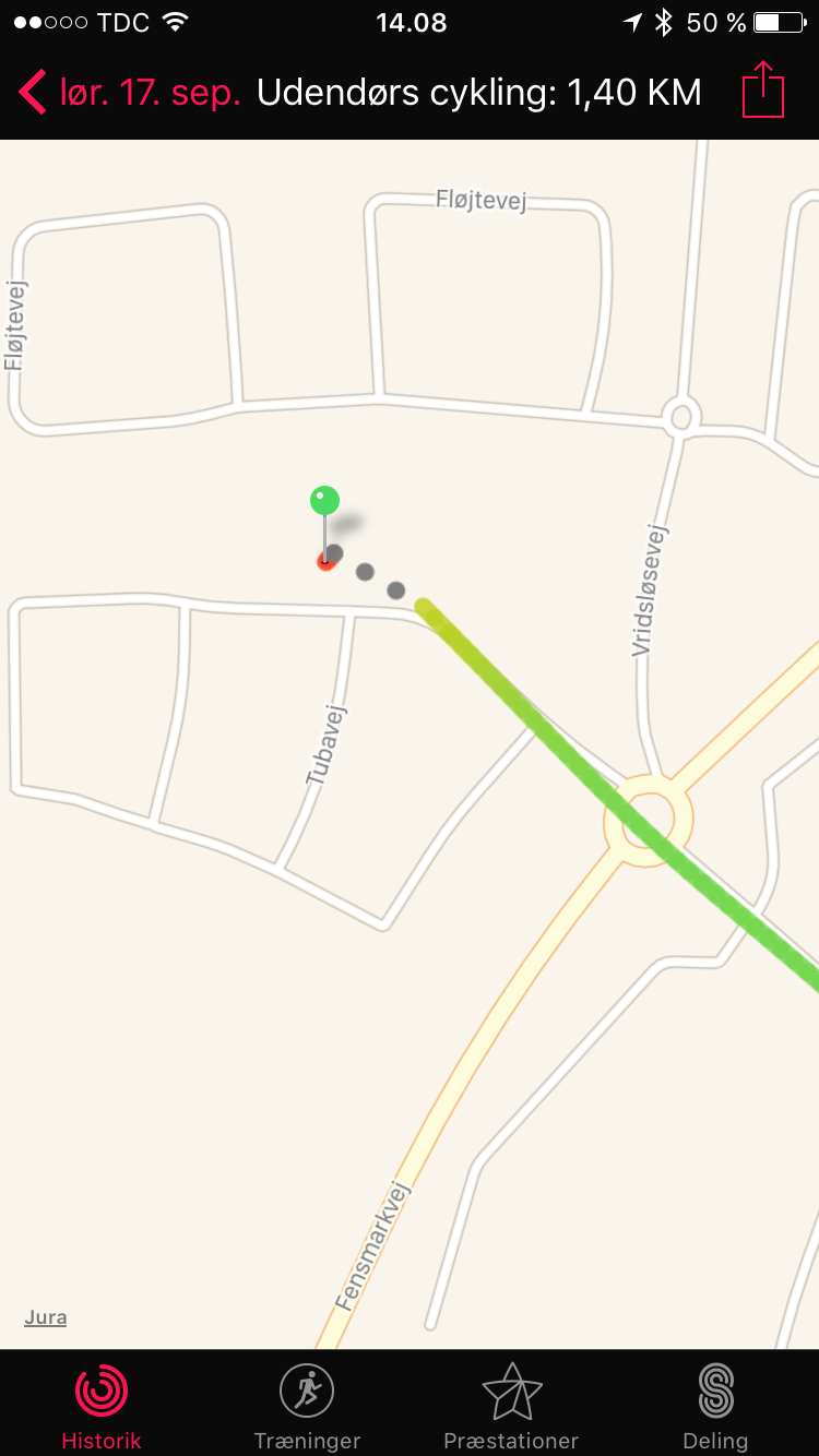

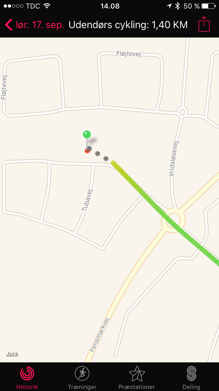

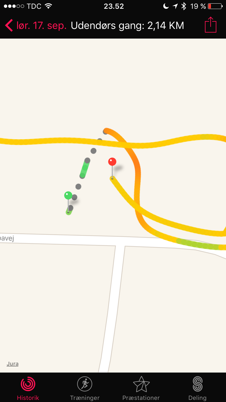

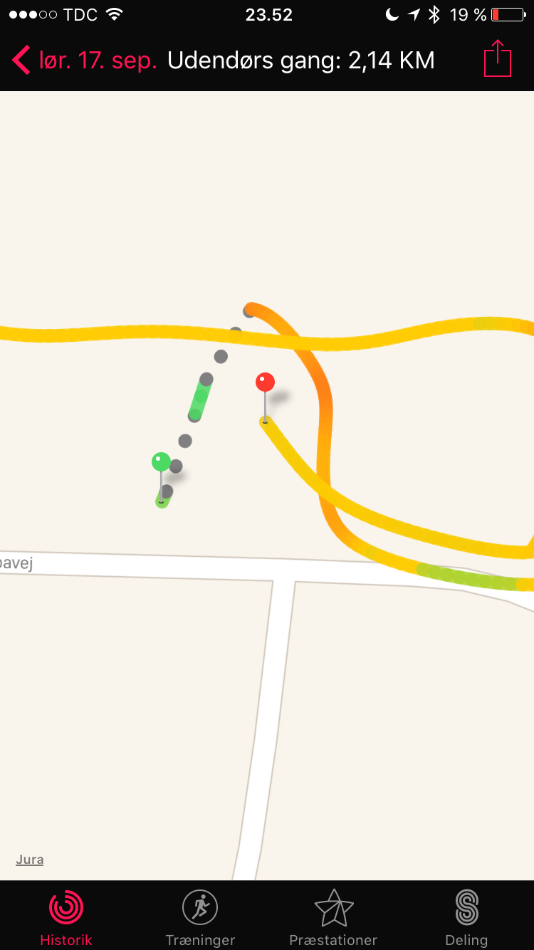

It failed today for me too, when taking the bike to the gym. I missed some 200 meters at the beginning of my ride? It showed my ride as if I went right through the roundabout too?

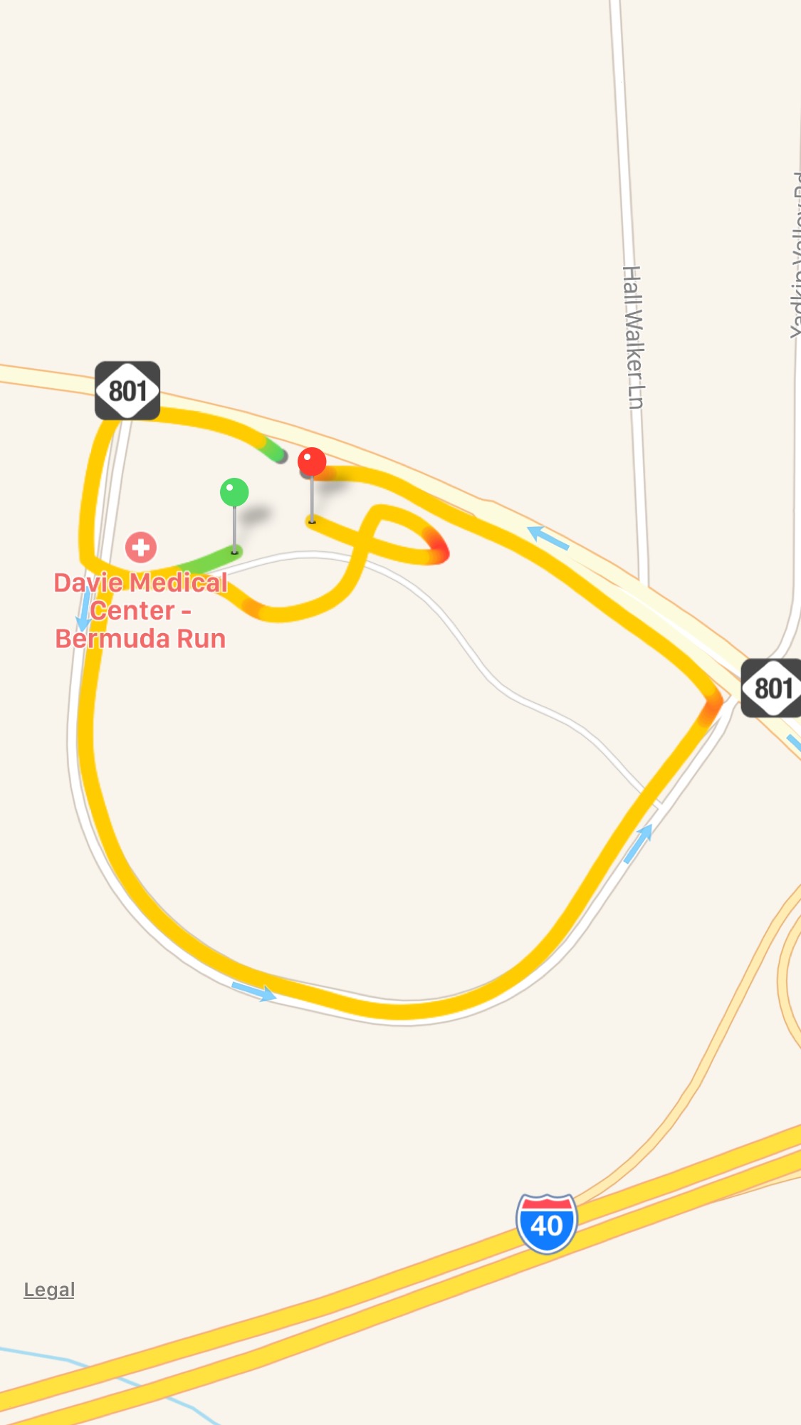

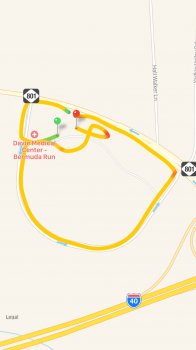

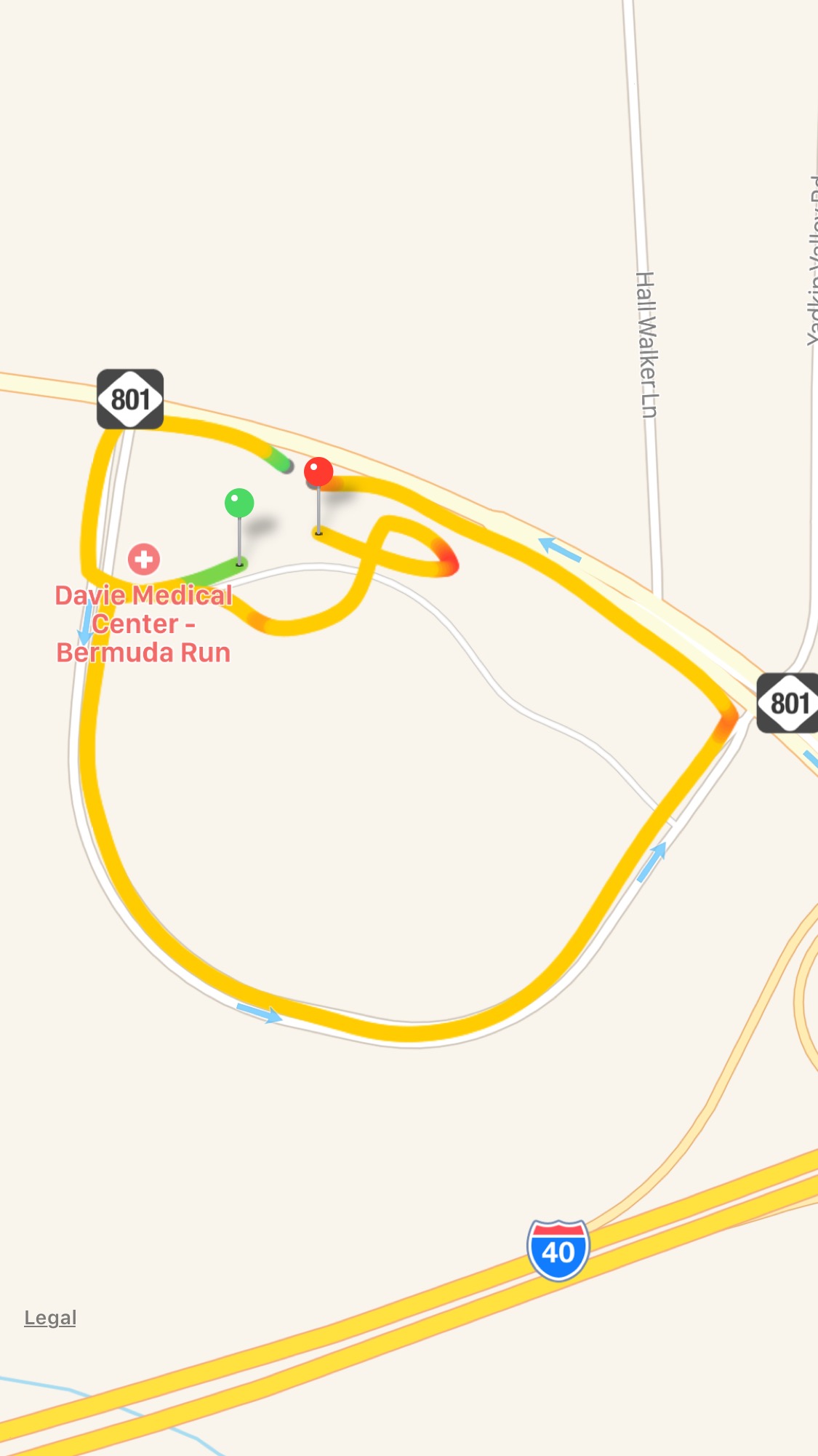

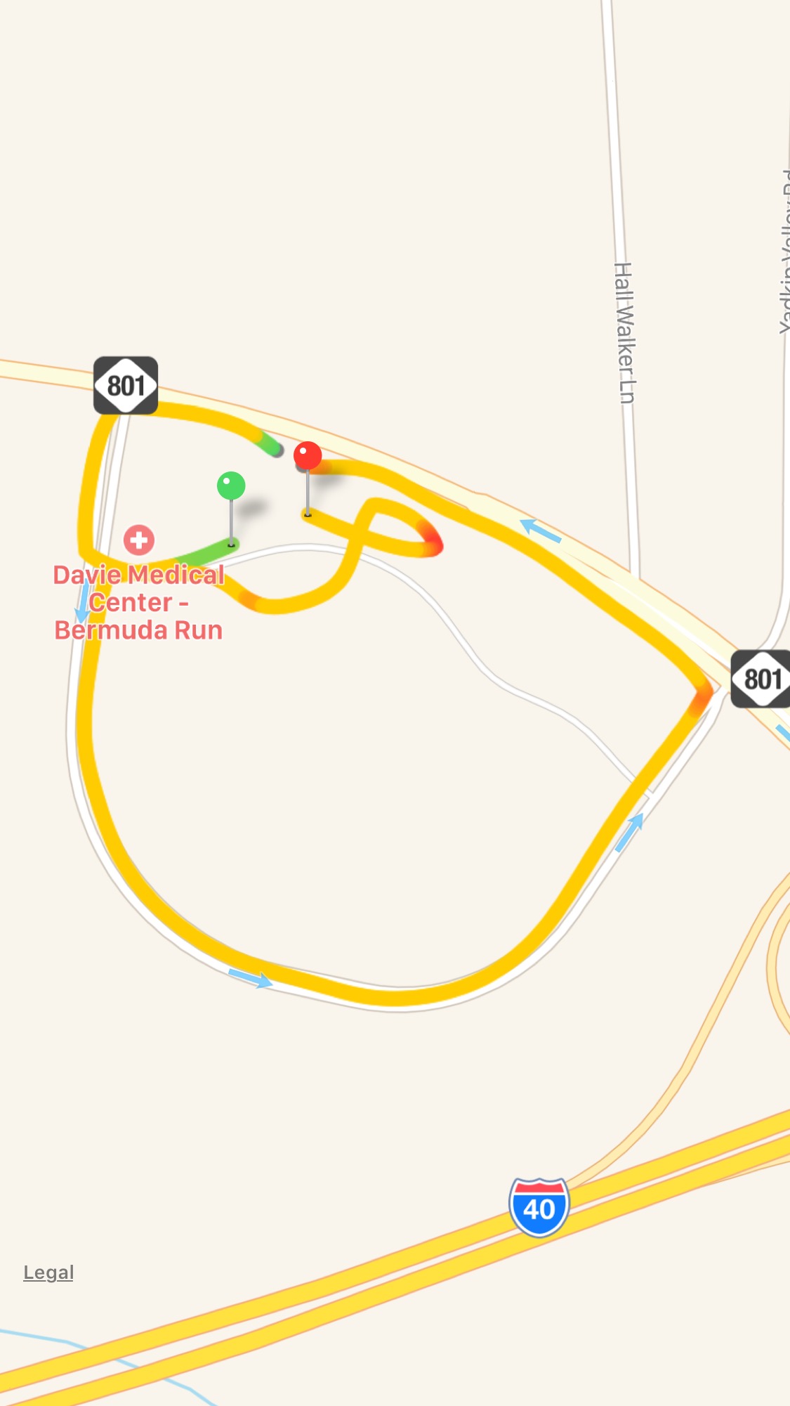

Just went for another test run around a local hospital that has a multi-use path. Since the loop is about a mile, a ran past my truck at one point. My phone was sitting on the seat. As you can see by the attached, the watch lost GPS right when I got close enough to my phone in the truck near the red finish pin. Looks like it connected briefly, and then the watch picked up the GPS again. Also strange in that I was running about an 8:20/mile pace throughout the run, and at the point where I came into range of the phone it shows a 11:00/mile pace.

Yeah, but I think it's an known issue with connected devices. Same misterious start - the route has been messed up at the beginning? I didn't run to the left at the beginning - but to the road?
I played around with the Samsung Gear Fit 2 before my AW2 arrived. It does exactly the same thing when I'm close to my android phone or wifi network at home before running - the tethered connection messes up my GPS fix, and sometimes I'm missing 100-200 meters of my run.
