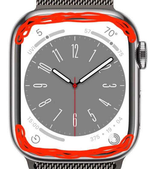

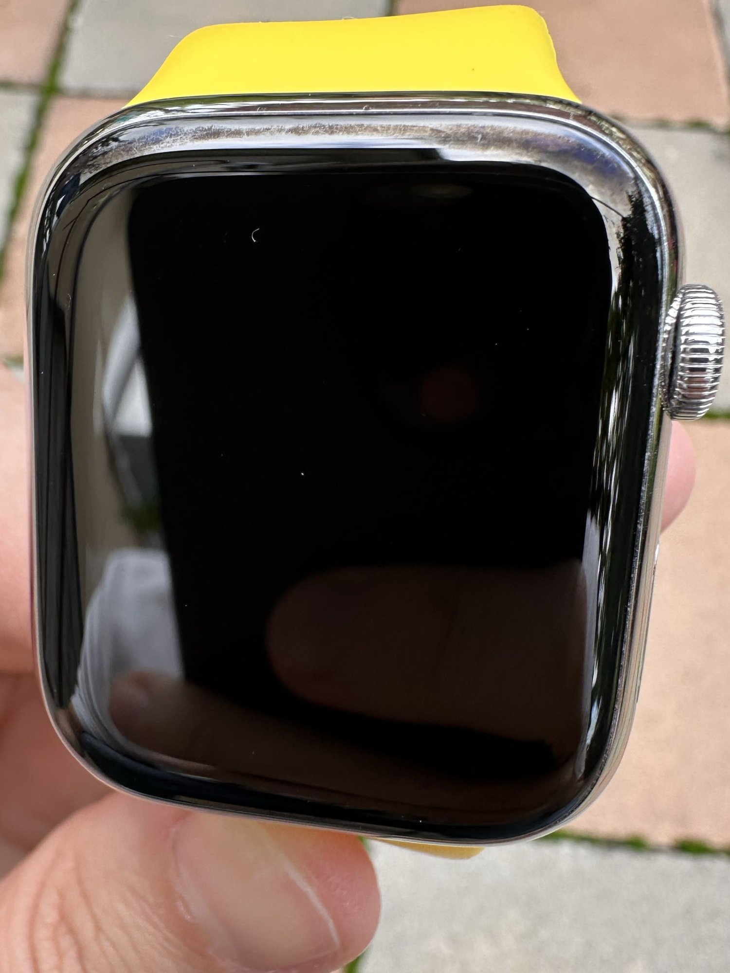

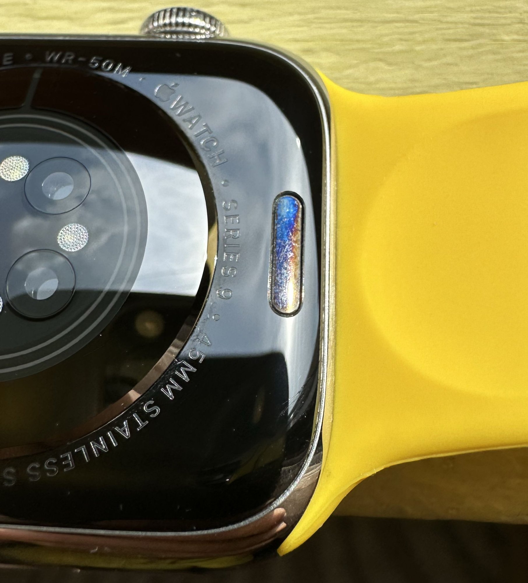

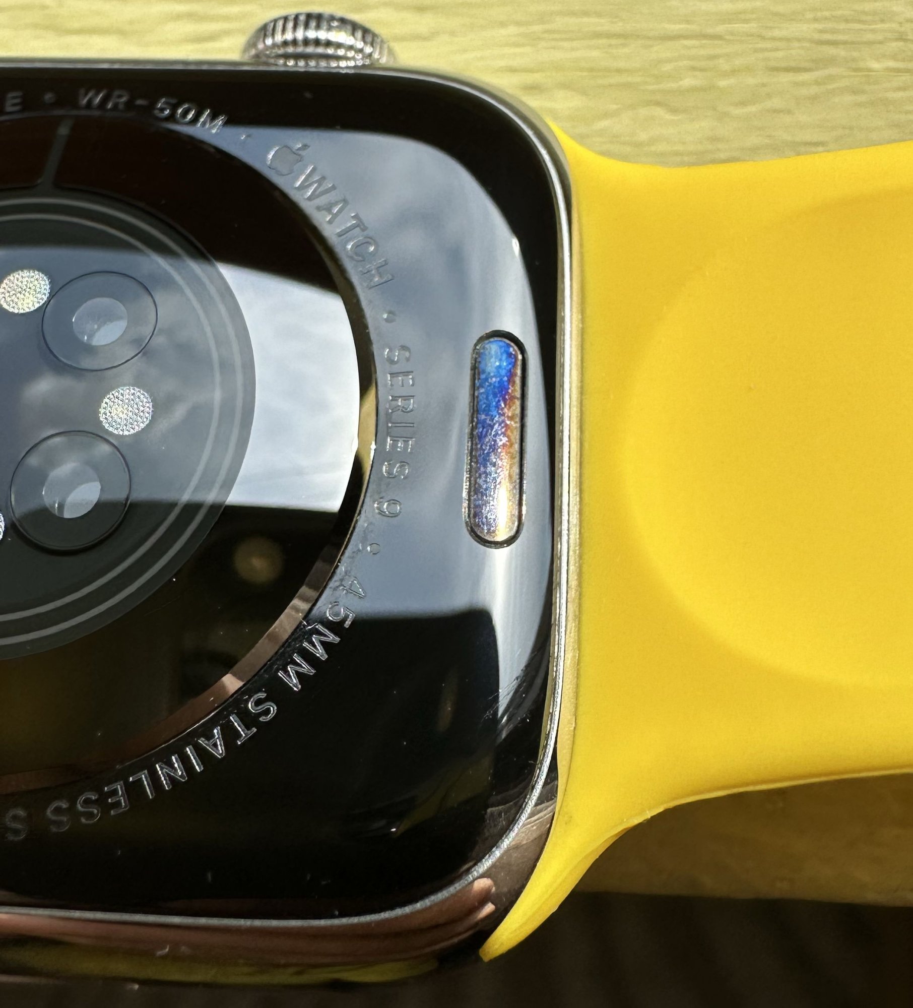

I'm pretty sure your issue can best be described as an "oleophobic coating" issue. The stains aren't actually stains but areas of display where the oleophobic coating has been worn off or was never applied correctly(during manufacturing):
A quick way to test if the oleophobic coating has been worn down is to drip a few drops of water over the different areas of the display.
The water will form spherical drops (beading) where the coating is intact but lie more flat (sheeting) in the areas where there's no or little coating.

If it is indeed just the oleophobic coating that's worn off then you can reapply it yourself fairly easily:
To be honest I've noticed months ago that when I wash it on the sink after a workout, the water never stays on the flat surface of the screen, it always goes on top and bottom parts where the curvature is and never on the left or right sides. This might be because of the coating problem or just the shape of the watch, cannot really tell. Here is an image what I mean, (red area is water) because it is difficult to take a close picture on my actual watch, but yes the water goes where the damaged area is.

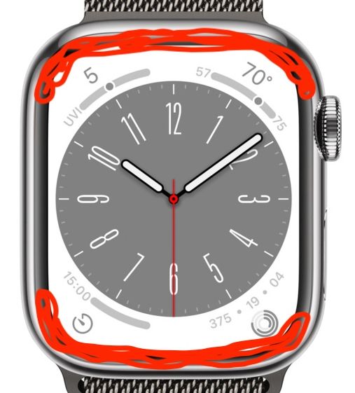

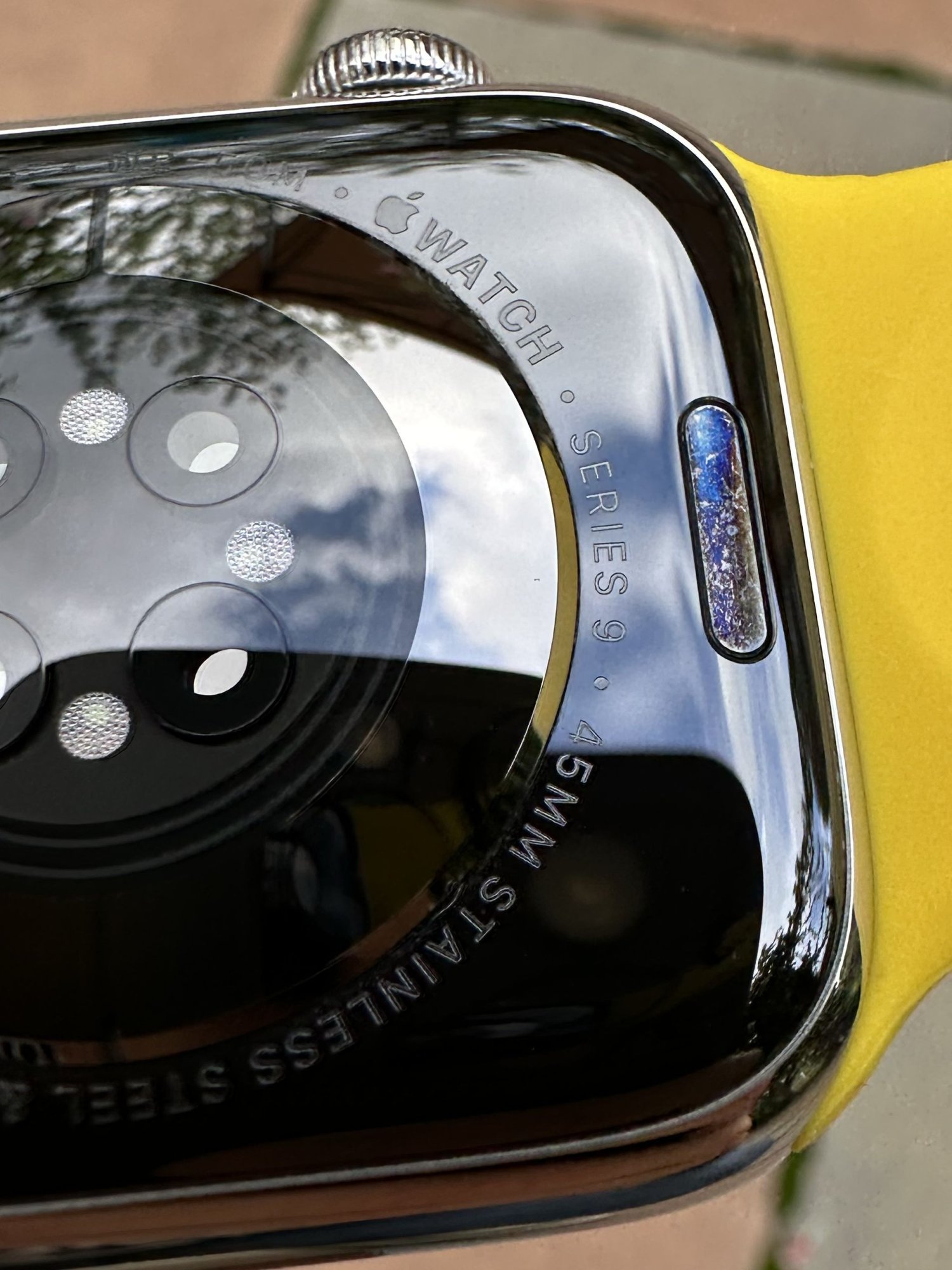

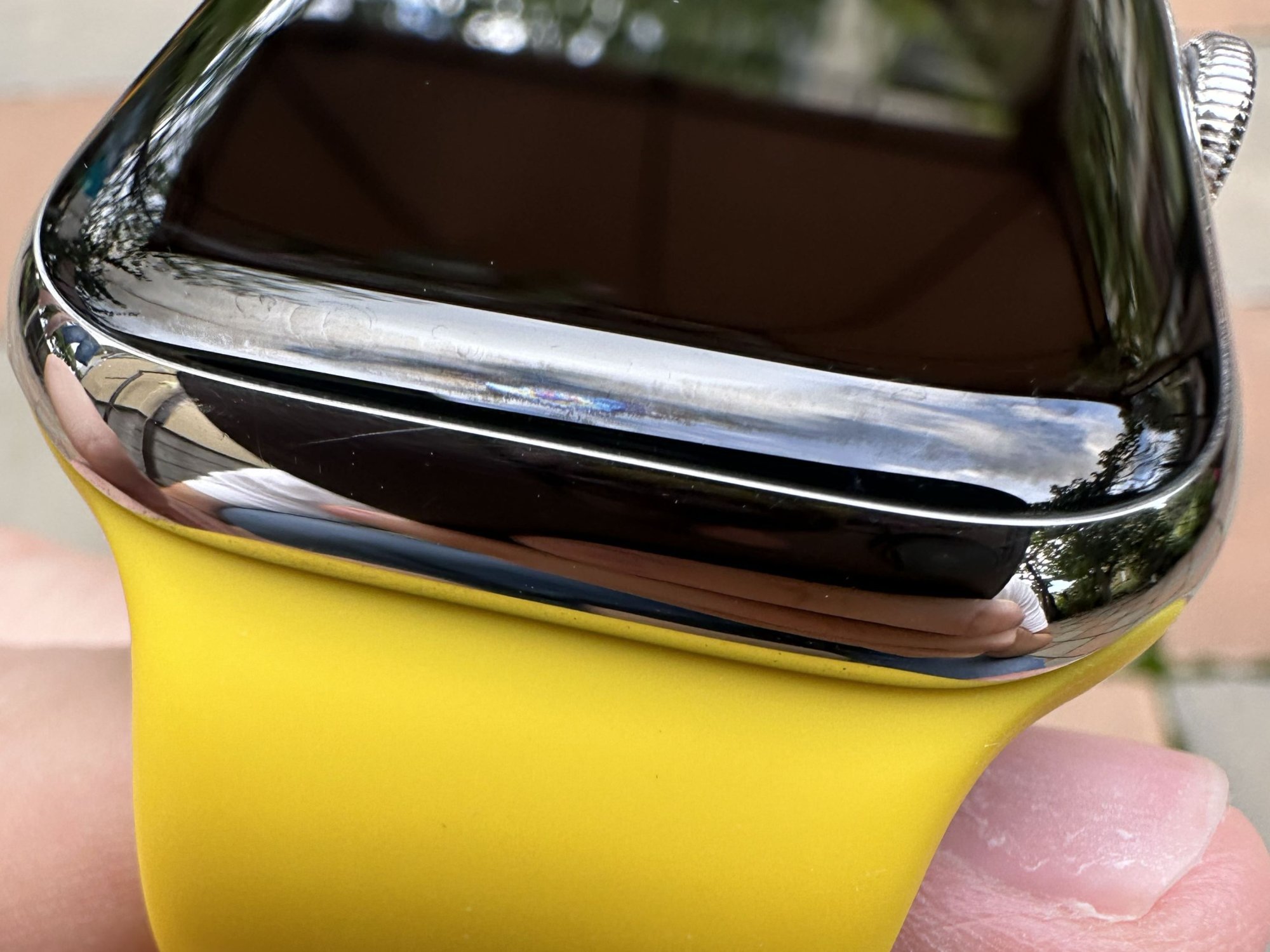

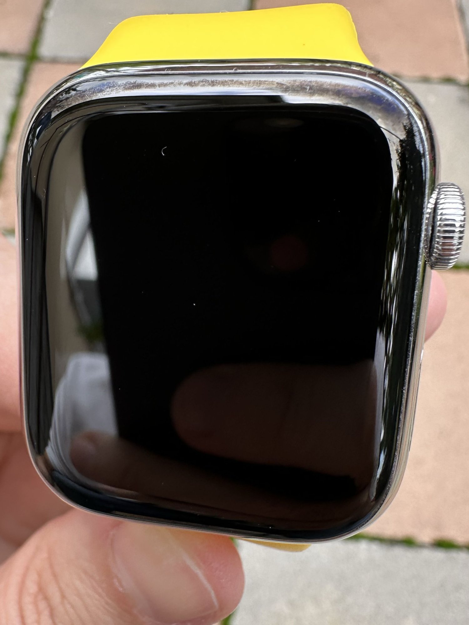

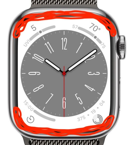

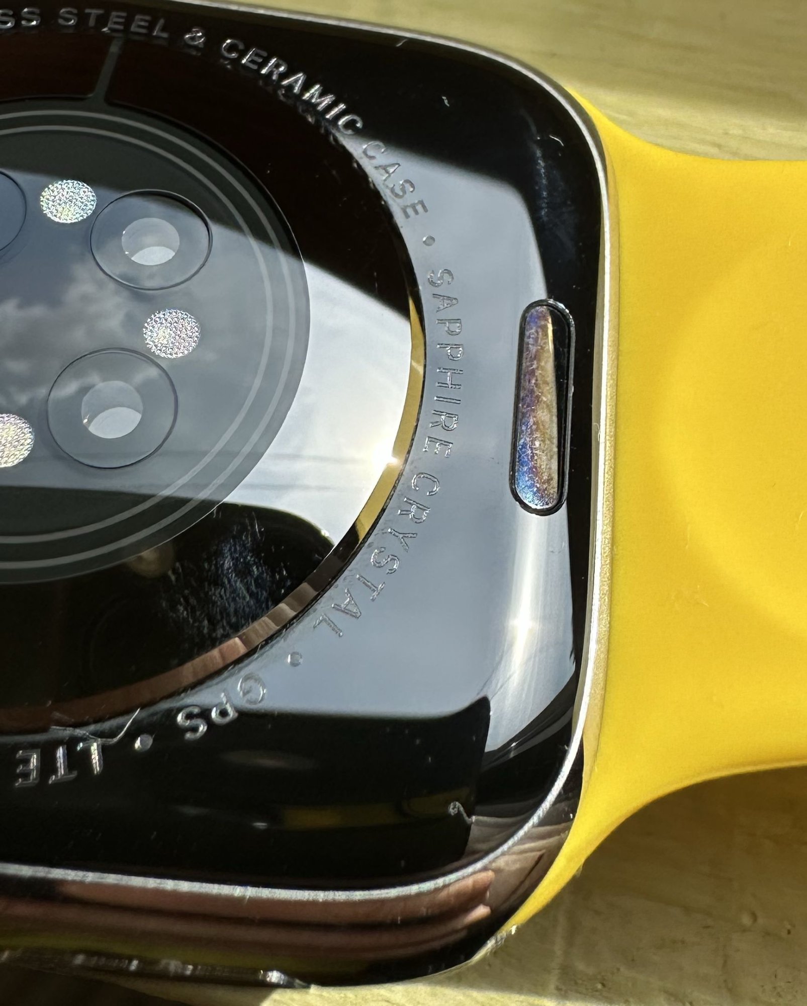

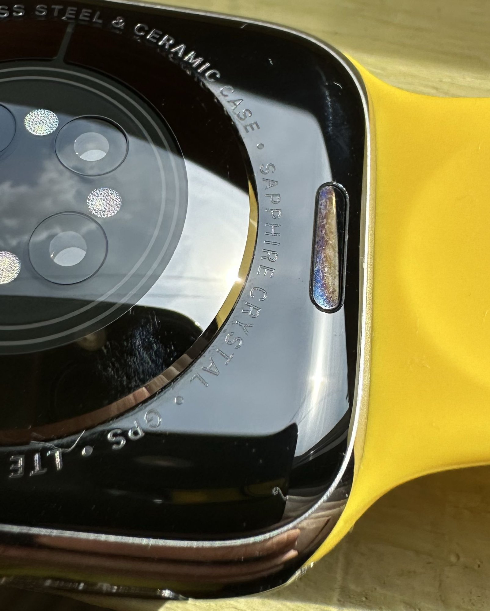

Well, the water forming droplets is because the oleophobic coating is repelling it. I wouldn't expect the coating to push off the water entirely. But if the coating is still intact, it would at the very least see the water form droplets instead of sheeting with the (raw, uncoated) glass surface.
In the spots where the coating is missing, the areas you've drawn in red, the water would be more "attracted" to as there's very little or nothing repelling it away.
It would definitely seem the oleophobic coating has worn off in those areas. And the stuff that looks like stains are small holes in the coating.
Which is good news because the coating doesn't impair the Watch in any way or means that it's in any way more prone to damage.
And you should be able to easily fix it yourself like seen in the videos I linked to.
I should clarify than in the red areas of my image the water stays as one solid body, not some small droplets. However if the problem is the glass coating how could you explain the same discoloration on the back to the watch?

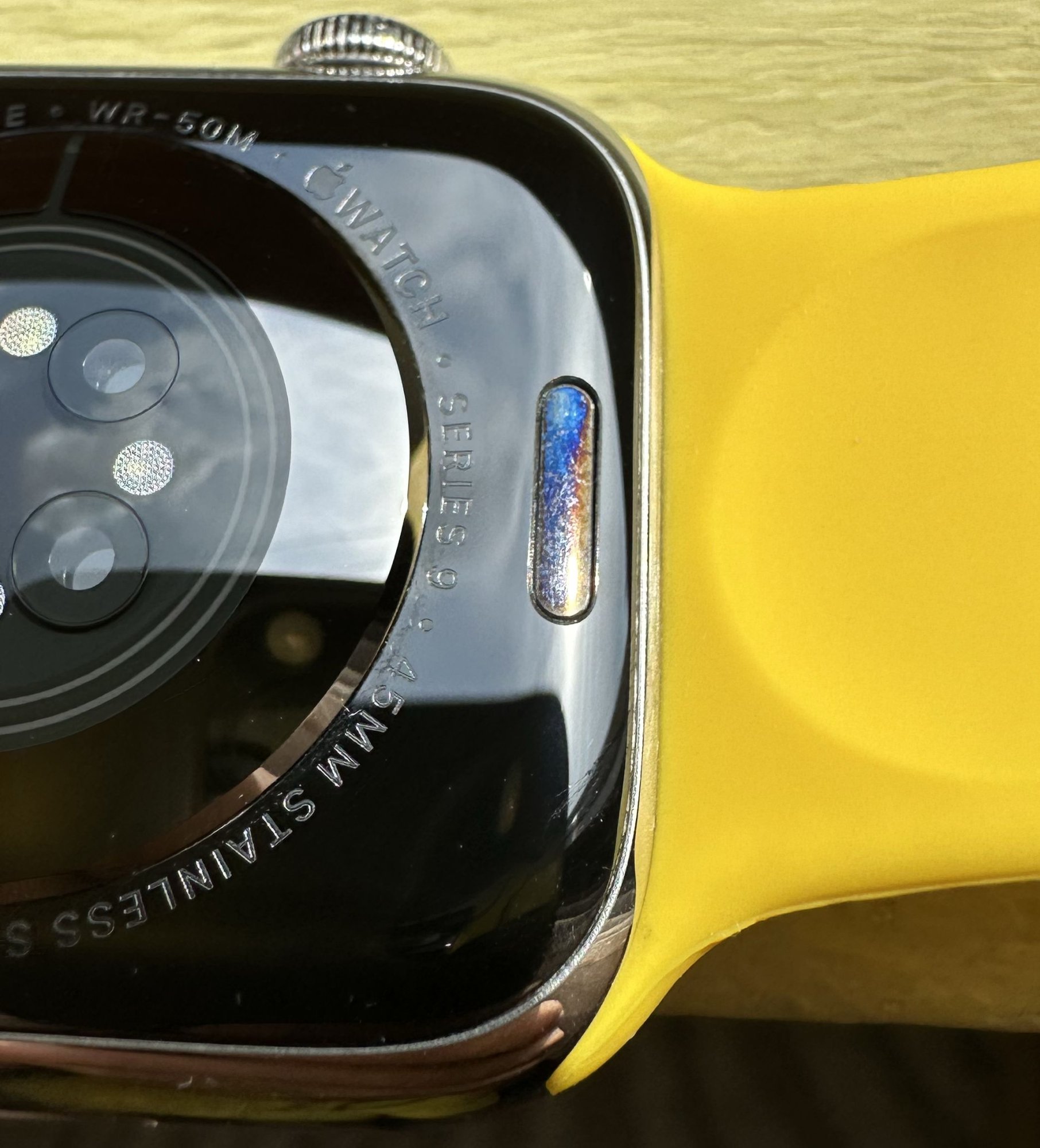

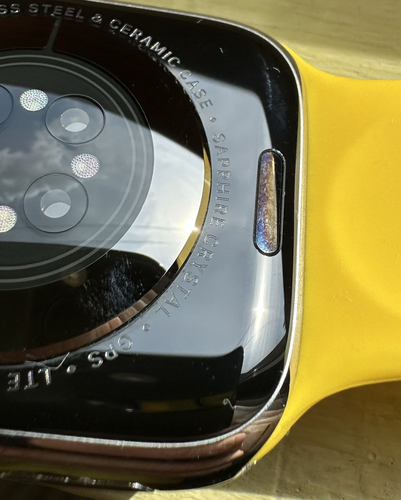

Y’all there is no way we can see the ceramic back tarnishing in any way, but as @ApplesAreSweet&Sour said, there may be an oleophobic coating on both sides of the Apple Watch that would be causing it, if not the case that it is occurring in the underside of the screen and ceramic back.
That's exactly my point: If the water does not form droplets on any part of the display, or really any part of the Watch, then that part does not have oleophobic coating.
I'm not saying I know how or why the coating has worn off, whether it wasn't applied properly during manufacturing, or if you have worn it off by using your Watch.
But even if applied perfectly by the manufacturer, oleophobic coating is known to wear off over time.
Although I don't know for sure if the bottom glass parts are coated too, you can do the water droplet test on those too to see if the coating is worn off.
My assumption is that there's coating on the entire display and entire bottom glass. I'm not sure though.

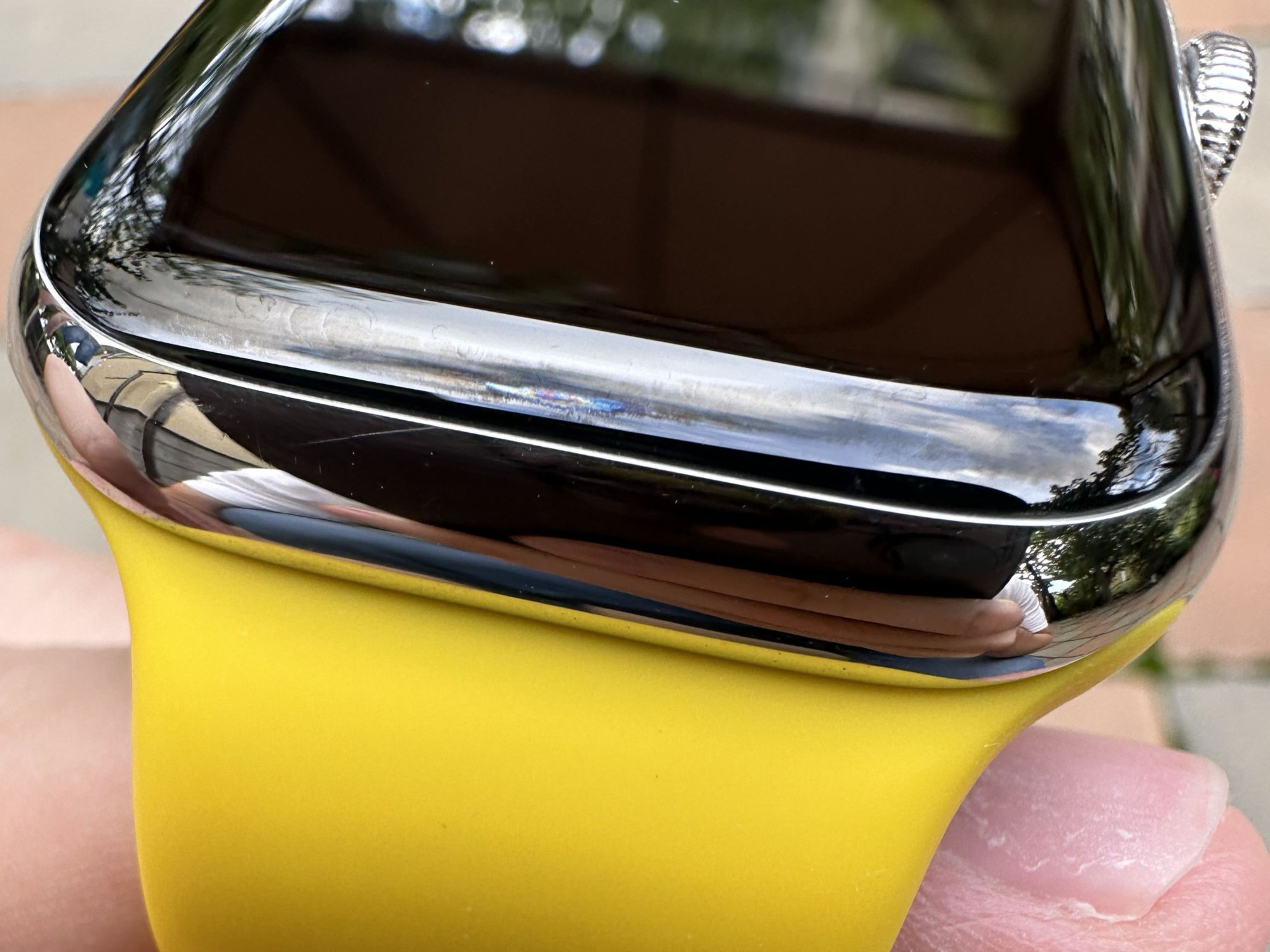

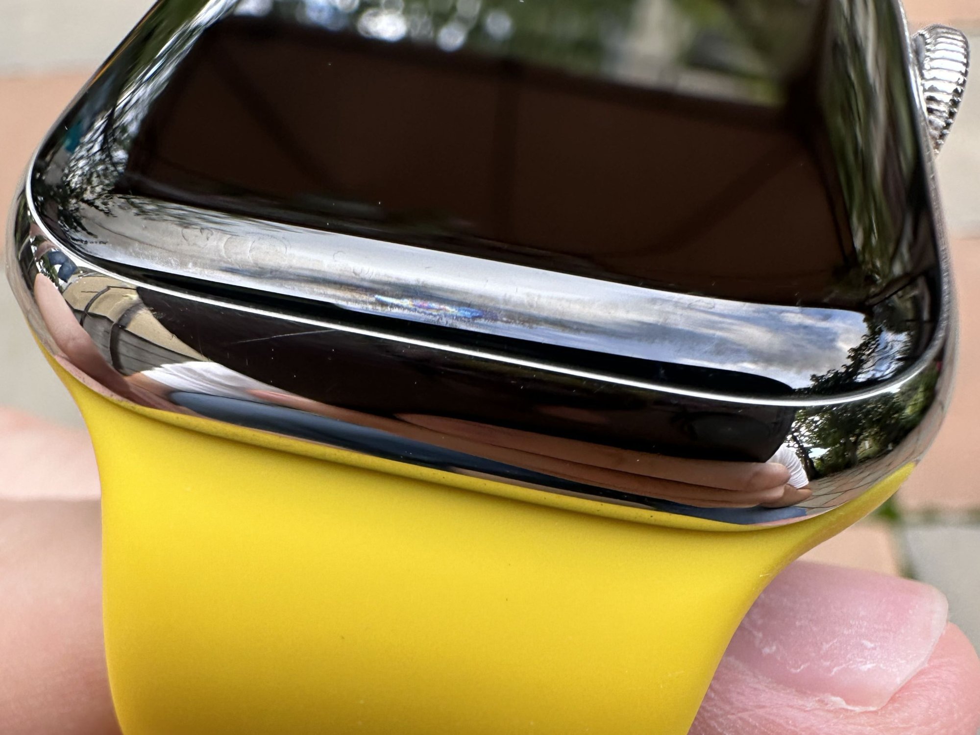

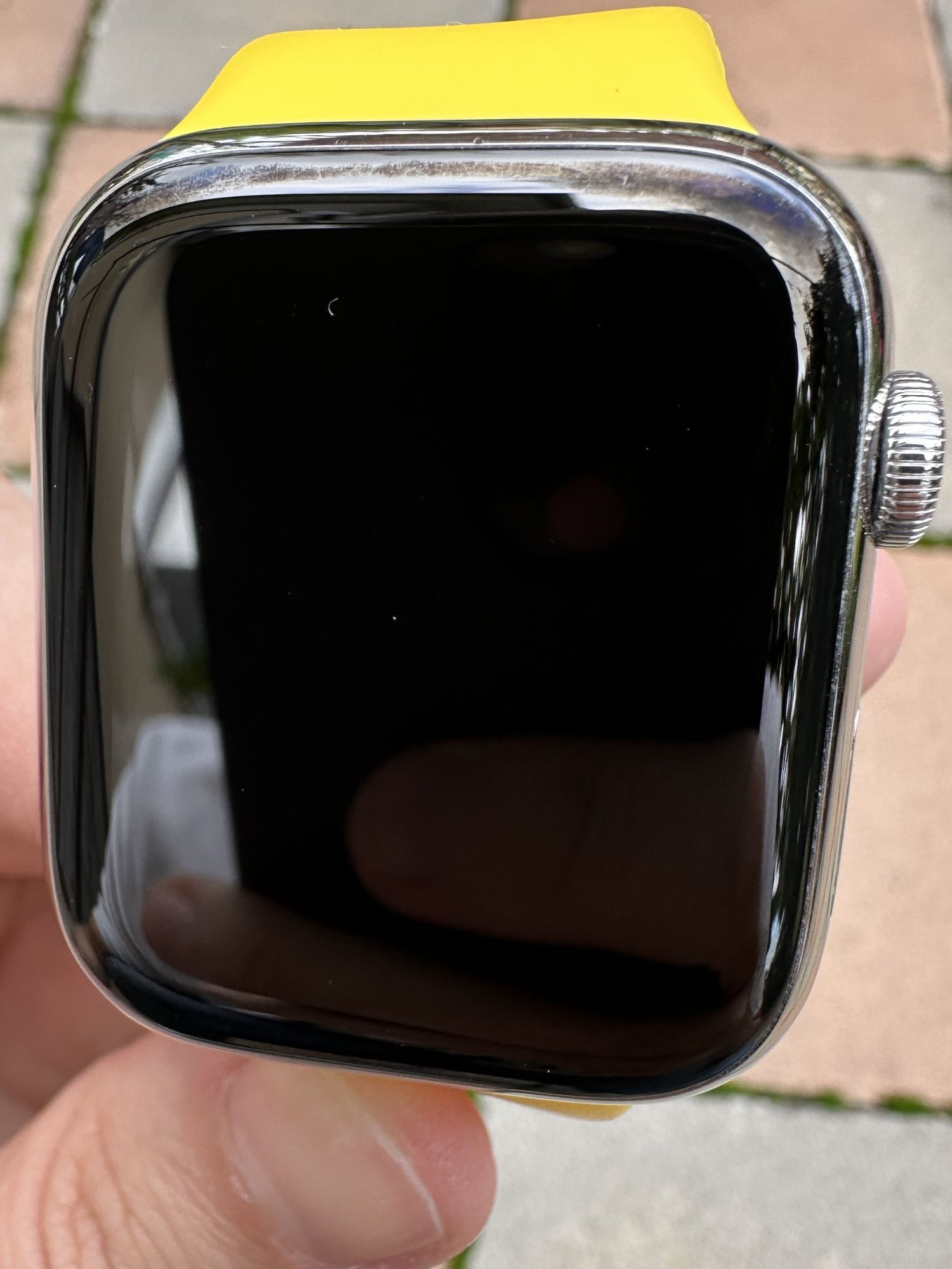

Ok guys here is an update from me.
I sent my Apple Watch to sertified repair shop here in Bulgaria on 18 September. One week later I called them just to check how's the things going on and they told me that the watch had been sent to an official Apple repair shop abroad (I guess somewhere in western Europe). I am fine with that, the guy on the phone was extremely polite and told me than in this kind of situations Apple usually replaces the watch and I felt relieved and happy. One week later (this Friday October 4th) the guy from my local repair shop called me and told me they got the watch back, but Apple had refused to replace the watch with an explanation that this is kinda normal, scratches happens sometimes and the sapphire glass is fine. Yesterday October 5th I got my watch back looking just like I sent it 2 weeks ago.
I really have no words to describe how frustrated I'm now. Unfortunately my watch isn't under a warranty since October 1st which means, there is nothing more I can do. Some of you might ask why I don't have Apple Care, and I would say, because I consider myself as a person who takes care of its devices. For example I had iPhone 5S and X and never had case nor screen protector on them and still looks just like I bought them, just because I don't drop my phones. Currently using 14 Pro for nearly 2 years, same no case no screen protector and it's like brand new.
Just wanted to share my bad experience, if you could give me an advice what to do is welcome. Here is a pictures of my watch from today.
Maybe I have overread it.. but you tried to clean it with Isopropanol?

Yes, before I sent it to Apple, I had tried several times rubbing the glass with Isopropanol, no difference.
I should add that I don'd to anything extreme with my watch. I work from home (not some chemical factory where I could melt the screen). I do some basic workouts every day and after a workout my wrist is sweaty, I wash the watch with water (normal temperature) I had never washed with soap because I was afraid that I could damage the screen coating. Well it's all confusing...

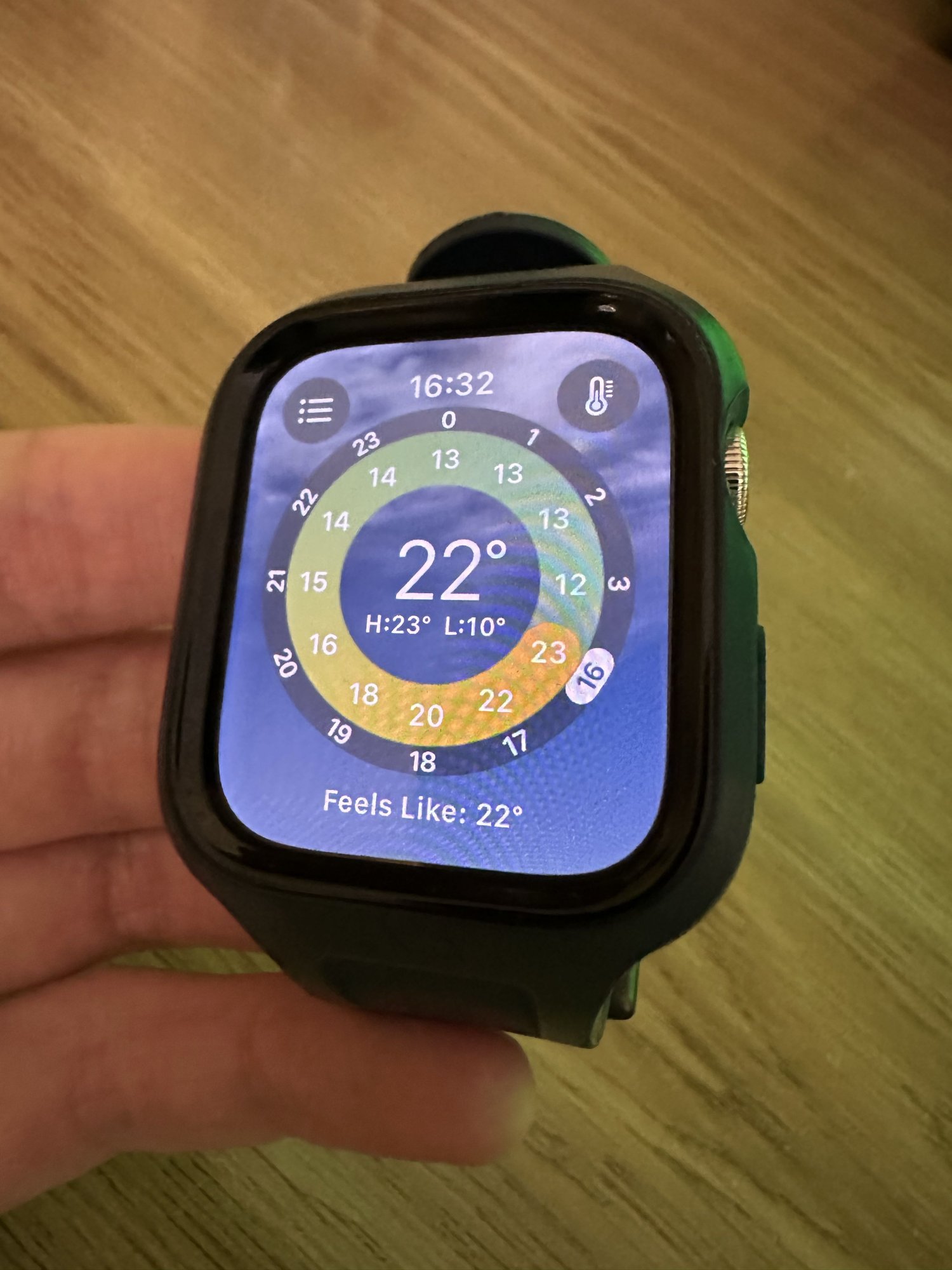

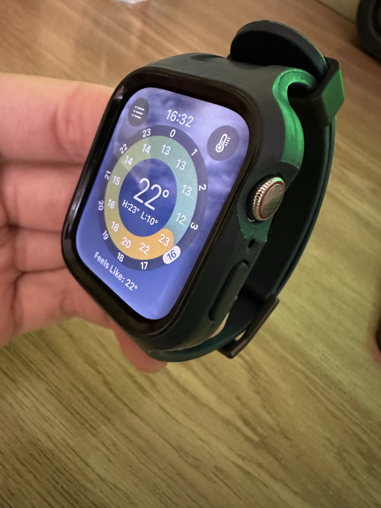

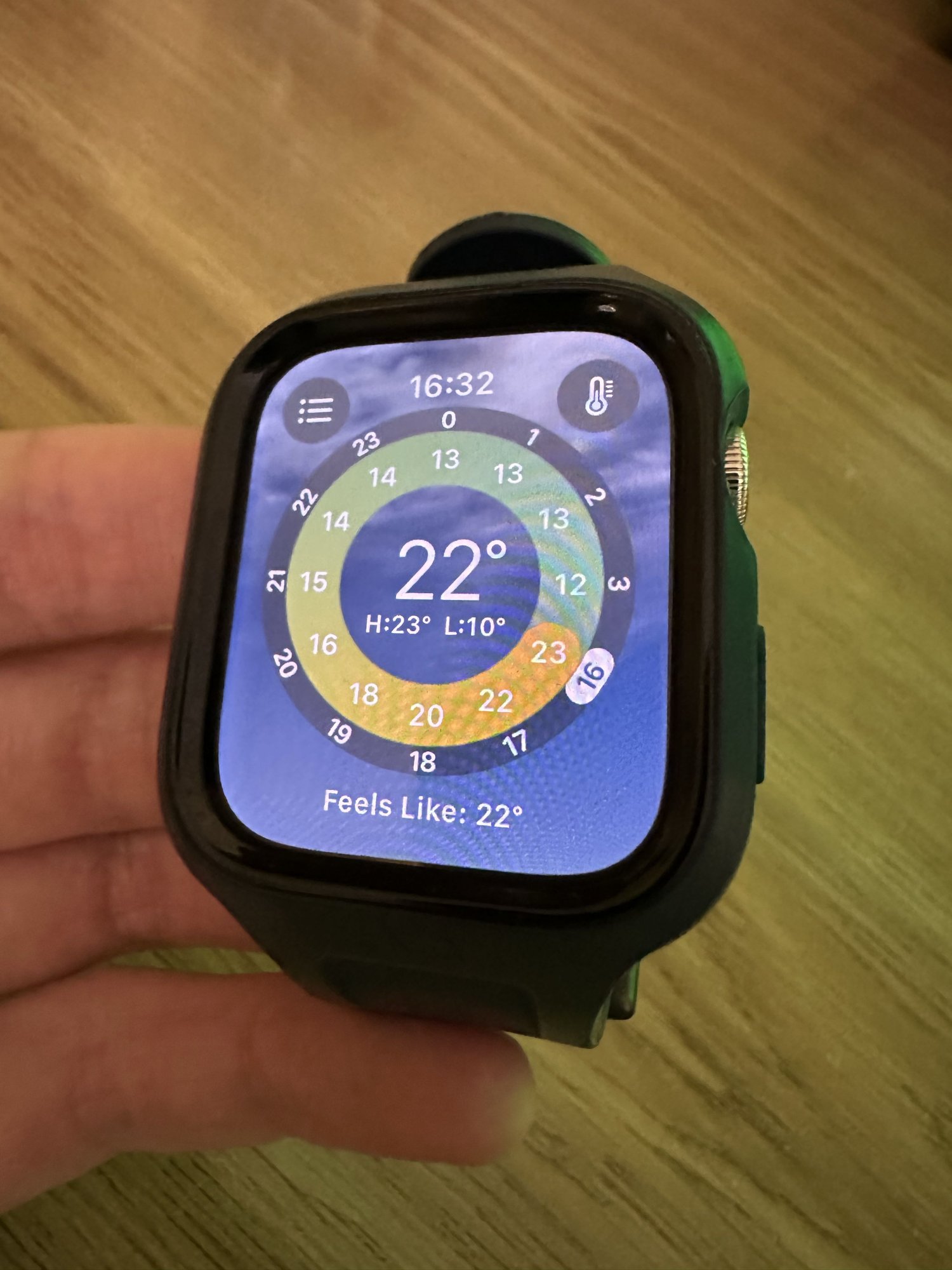

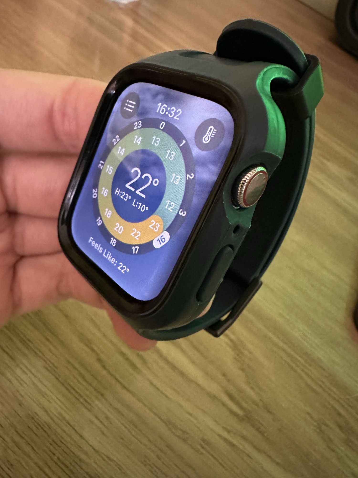

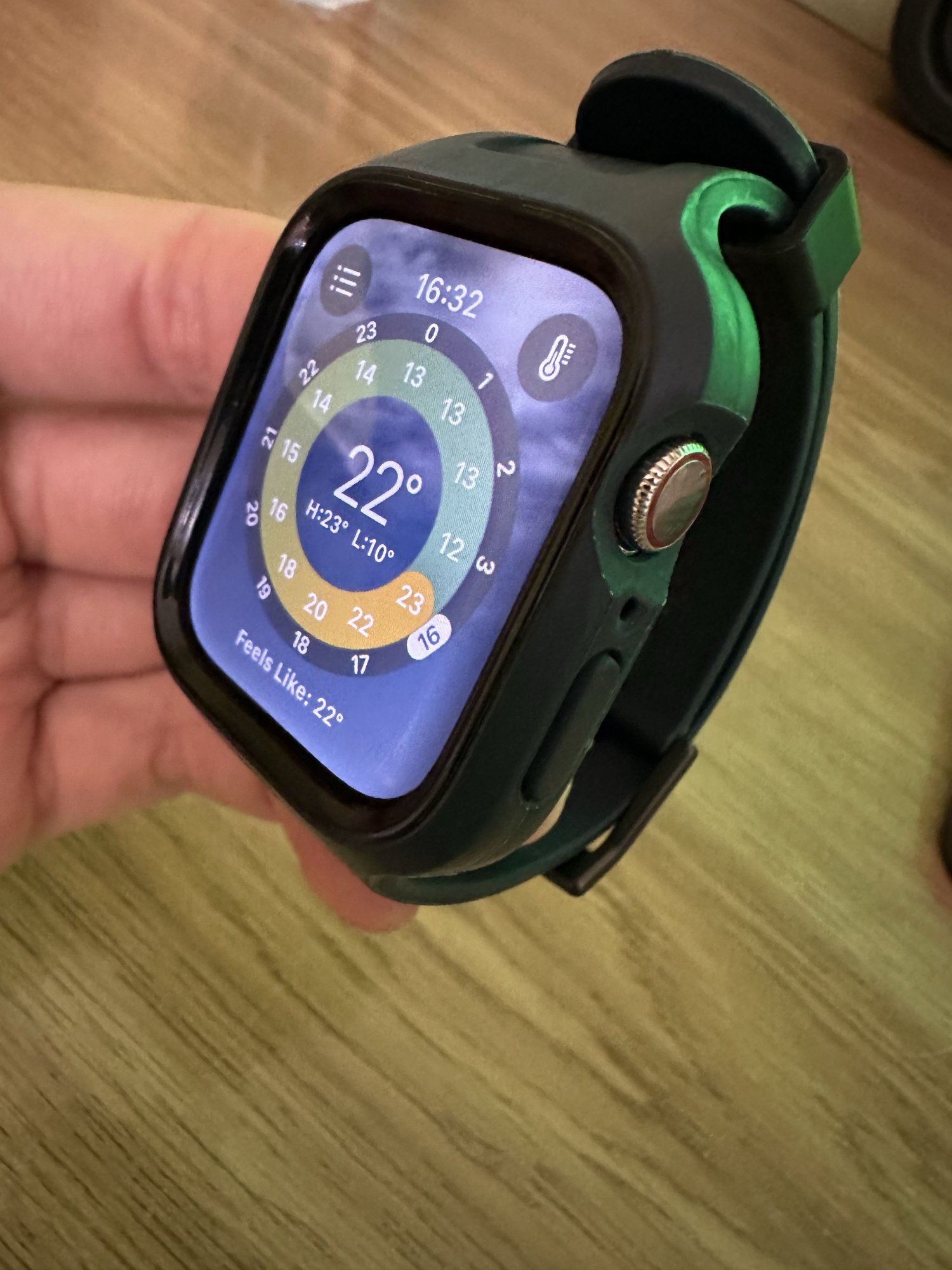

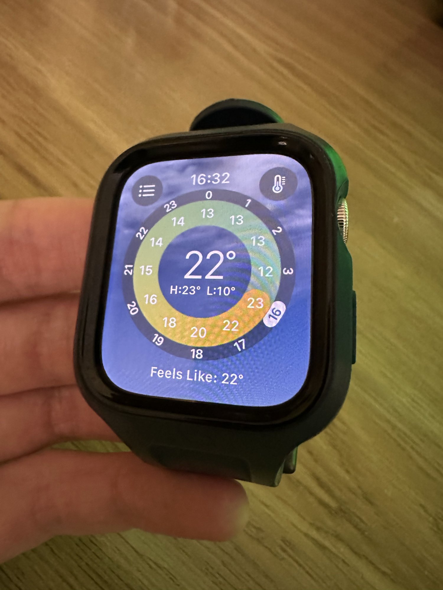

Actually I don't use cases on my iPhones but when it comes to the watch I do use a bumper by a brand called Uniq. I use it only when I do some DIY work around the house or maintaining the car for example but this is not every day of course just when I need it. So I think I take adequate care of my watch but still got damaged.
So does anybody thing I can do anything more in this situation? Should I contact Apple Support again, may be have a chat with them or anything else?
This is my bumper.

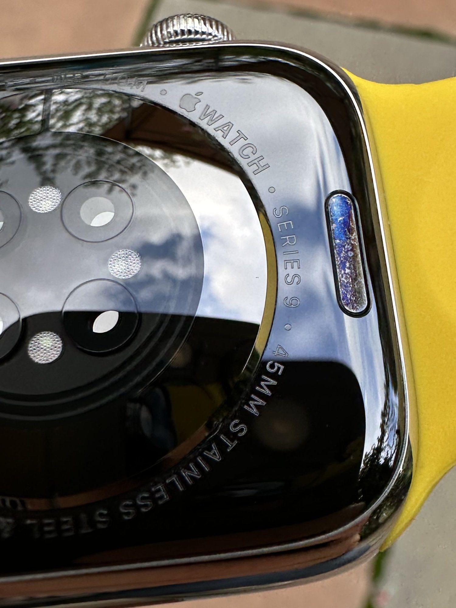

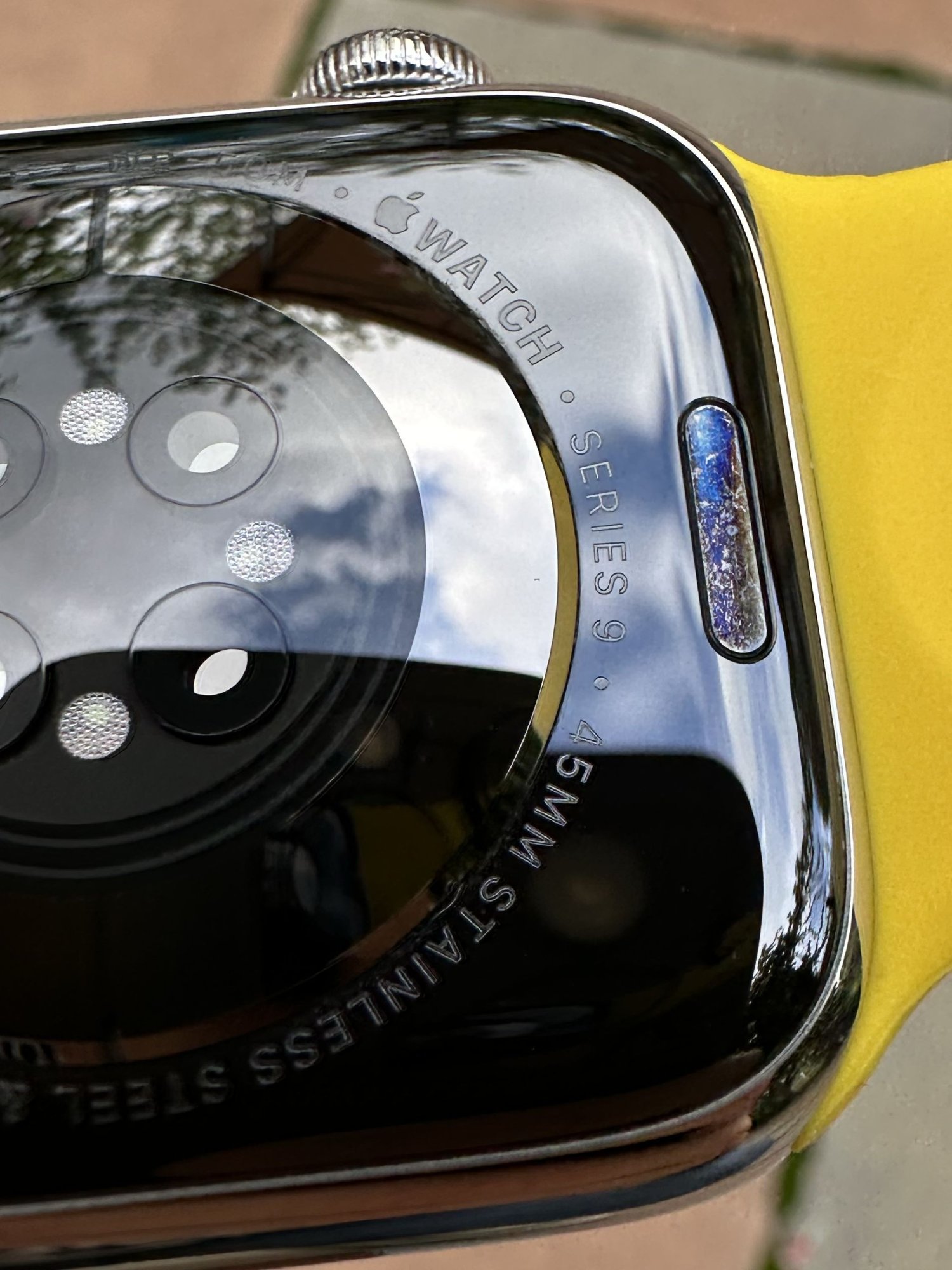

The band release button color is bizarre. Something is wrong.
My logical explanation is than sweat during workout might causes some chemical reaction or maybe when changing bangs I am peeling the coating with my nails. I know it sounds stupid but cannot find other explanation. I really don't mind the buttons discoloration because I don't see them all the time, but the glass shadows are what irritates me every time I look at my watch.
View attachment 2434689View attachment 2434690
This is my bumper.
Critical point to add. Cleaning the watch regularly especially with bumper cases after workouts is important. The case itself should be cleaned. The material could have rubbed a dye into the edges of the screen which are the bezels; that portion covers the screen. Same with the back; many rugged Apple Watch cases that are universally compatible would have both sides open but if it’s covering the back around the heart rate sensor it would rub off the finish on it as well.
If you do not wear nontoxic or dark/shiny nail polish 💅 the nails would not cause this issue. I change my bands every day and I do not get marks like that on my SS Apple Watch.

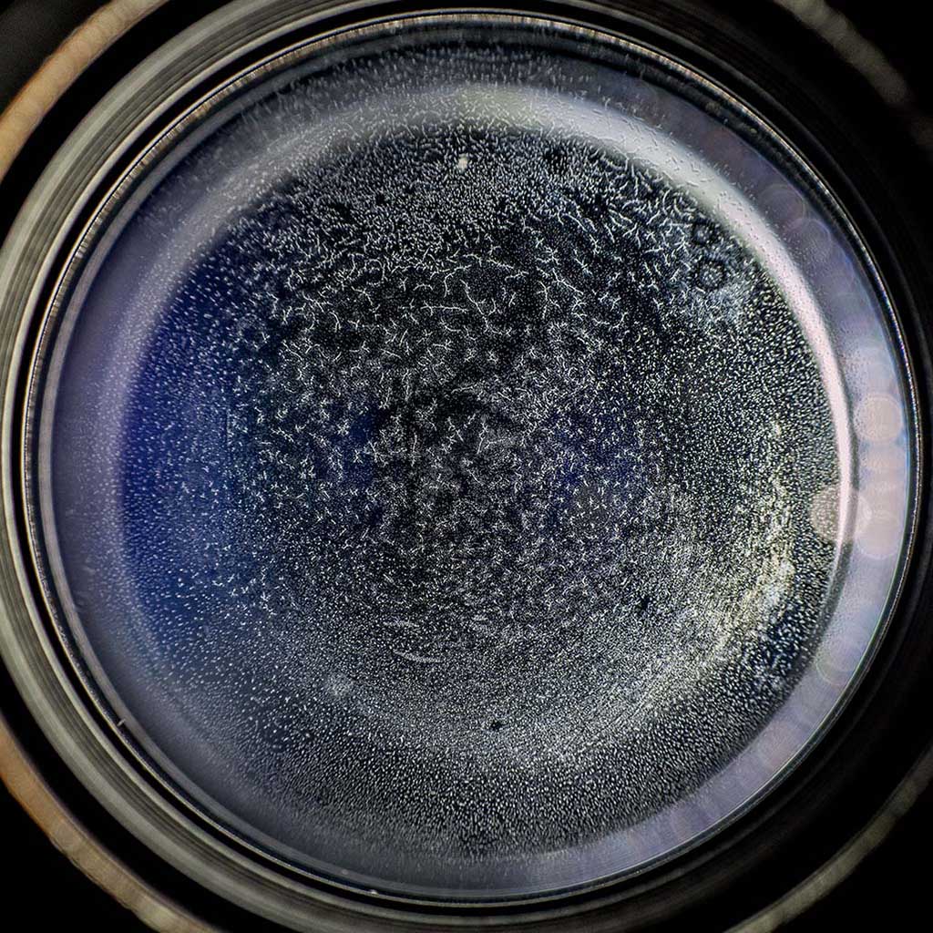

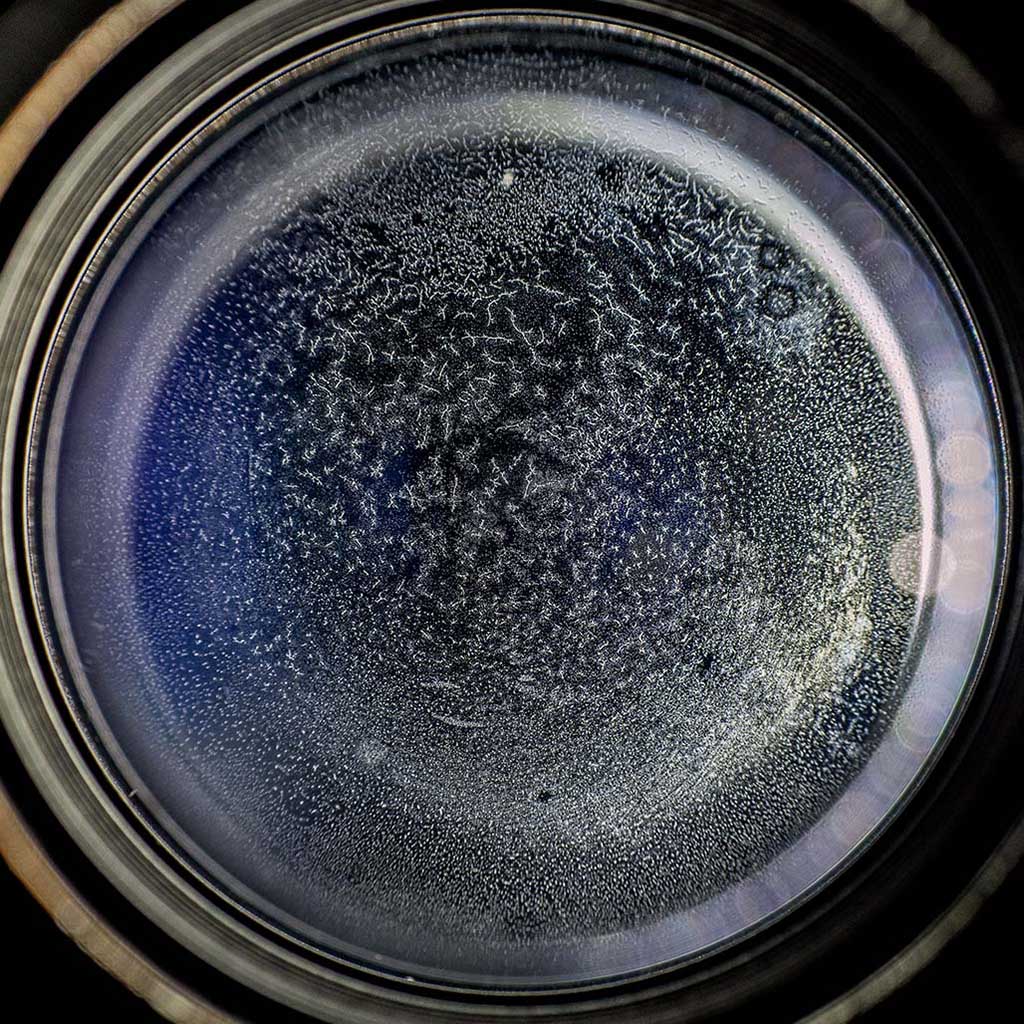

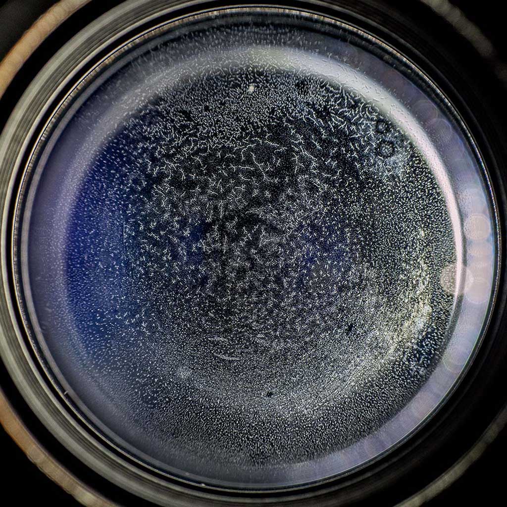

? How would mold be growing on an Apple Watch stainless steel case? Only it would do that on the rubber case he puts on it sometimes.
I am talking about the screen not the stainless. There is a type of fungus, not mold, that eats lens and their coatings.
Lens fungus:
