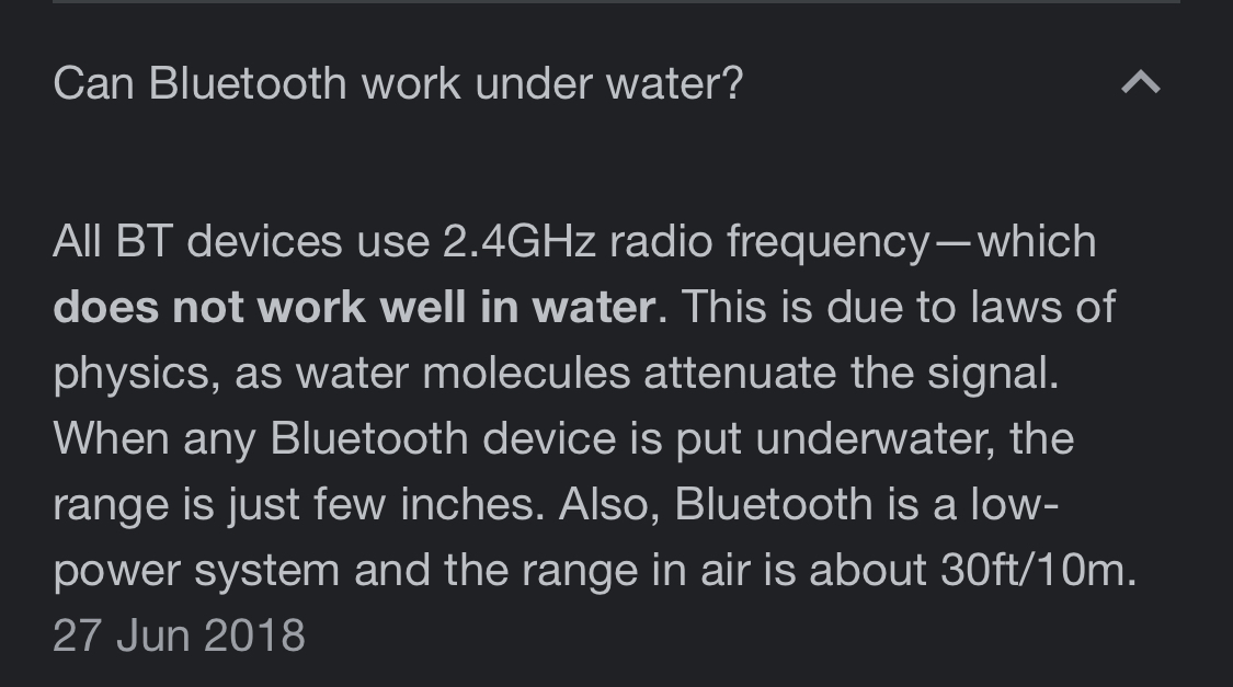

I’m not an expert, but my understanding is that Bluetooth doesn’t transmit well enough under water. I personally wouldn’t go back to using a dive computer that doesn’t have integrated air. I’d maybe wear my Suunto for the integrated air and take the Apple Watch Ultra as a backup / way to record the dive for social media. But that’s a lot of money for a backup. I’m thinking I’ll wait and see if integrated air comes.

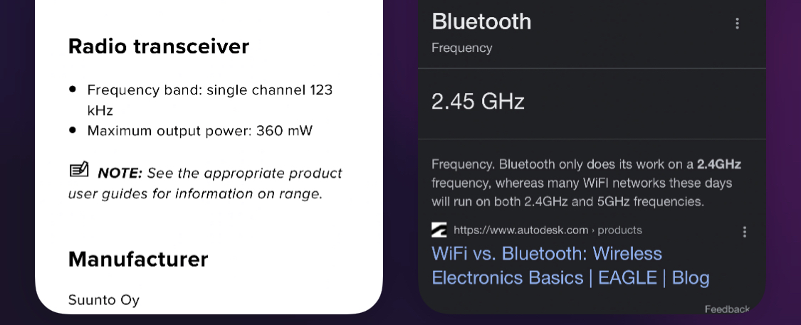

A wee bit of googling tells me that integrated air transmitters work in the KHz range and Bluetooth is in the GHz range. Lower wavelengths have better range and can diffract around obstacles better.
