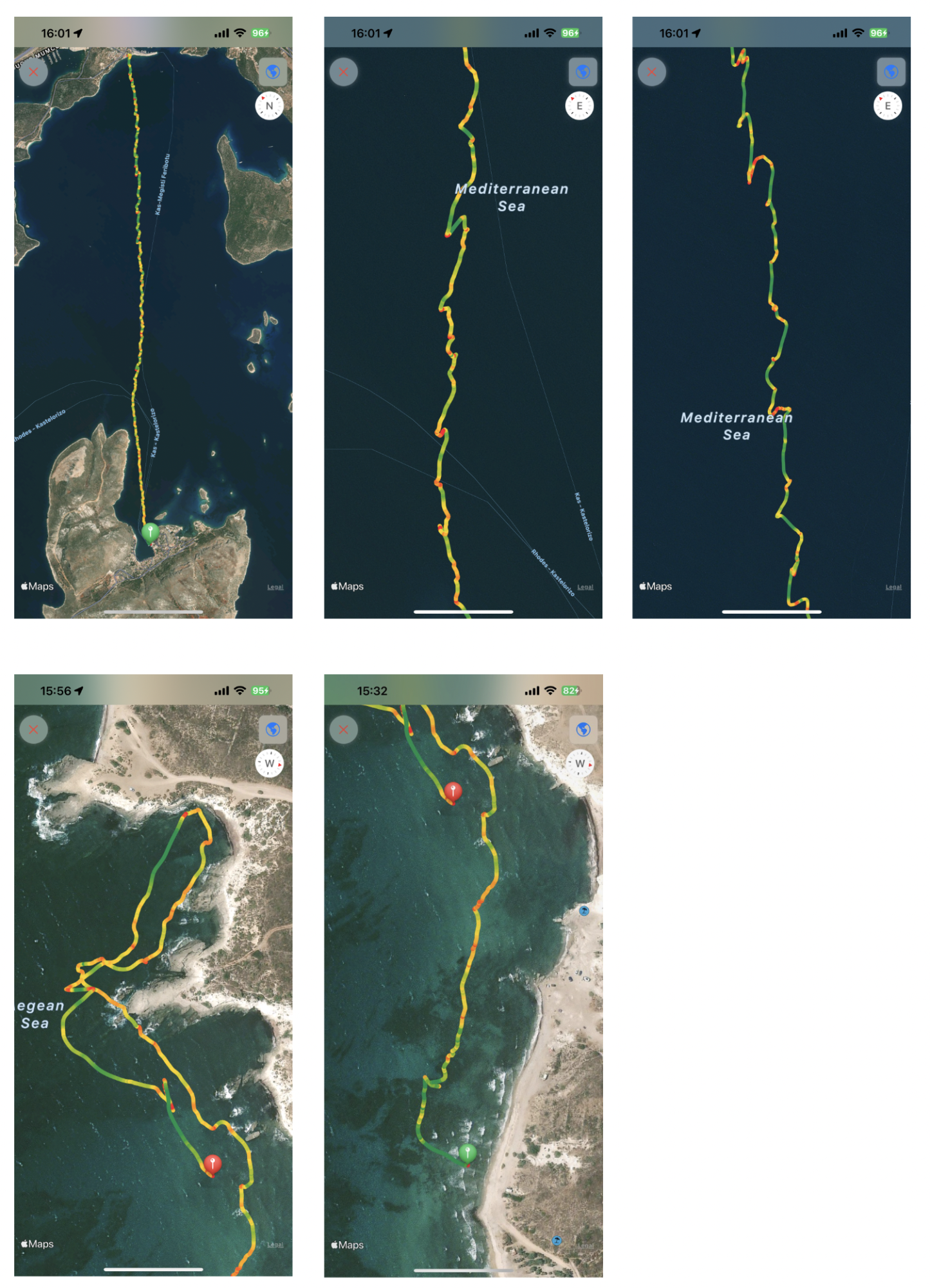

I am a competitive open-water marathon swimmer, thus I bought the AWU the day it came out. I was excited about the dual band and thought it would be much more accurate compared to my old Watch 7, boy I was wrong. I am swimming every single day out in the Aegean Sea. Each training session is around 2-3 kilometres long. So I swim around 40-60 minutes in average each session.
More than half of my swim sessions have wrong distance and thus wrong pace data with the AWU. Before AWU I used to have Series 7 and that worked much better in Open Water Swim. The problem is that AWU calculates extra distances due to faulty GPS points and bad tracking for some reason. It incorporates random loops and turns during my swim even though I don't pause and swim in a straight line.
Example: last weekend I attended a competition where I swam from Megisti Island in Greece to Kas, Turkey. The distance I swam was 7km whereas AWU calculated 8.5km which is impossible. When I checked the map, I see that the GPS track has bad points, loops, turns etc, whereas I swam continuously straight without stopping. There wasn't any current, wave, wind, nothing, flat and calm seas.
The same problem keeps happening during most of my open-water swim training sessions. Attaching some screenshots.
Dear Apple, I need a solution for this, it has been months. I love my AWU and it's smartwatch features but unfortunately, it's GPS simply doesn't work and is not reliable out in the sea. And I rely on this device to improve my competitive timings.
When the GPS works, I would say 40% of the time, it gives a perfect GPS track and map, however, it's absolutely not reliable meaning the next session or next day it just goes crazy.
Such an expensive high-end AWU should not have this bug. It’s clearly a software issue which I reported to Apple a few months back and nothing has been done.
I know open-water swimming is kind of a niche area but this has to be fixed asap.
Do any of you guys face a similar issue?

I'm the friend OP is referring to. A couple of observations from me:
- All our settings, as OP said, are the same.
- OP had AW Series 7 before, and I had AW Series 6. Neither had any problems. Ironically, GPS was _much_ better and reliable on AW Series 6/7 than Ultra.
- It might be something to do with additional GPS bands, as Series 6/7 didn't have any problem.
- We literally swim together next to each other, in a straight line, at the same pace, spanning the same distances, using the supposedly-identical hardware. I never have GPS problems.
- One thing I noted is that I also do walking workouts with my AW, OP usually doesn't. I've read somewhere it helps "calibrate" the AW, perhaps something to do with accelerometer/gyroscope which is important while swimming when GPS signal is unavailable underwater, if that's the case. However, OP also started doing walking workouts, yet the problem remains.
- In my personal opinion: The zig-zag pattern seems like there is some gap in the data, and AW is trying to "fill" that data by interpolation. However, for some reason, the available data points somehow get drifted. I'm not an expert in MEMS but could it be faulty accelerometer or gyroscope? I know it's extremely unlikely but I'm out of ideas.
- However (contradicting with above point), When AW can't get signal for any reason (e.g. underwater) it shows gray dotted lines. This is not the case here. AW for some reason thinks that data is there (otherwise instead of zig-zags, we'd simply see gray dotted lines indicating no data for there, until the next location with available data).
- Like above, could GPS be faulty? Perhaps the antenna connector inside the watch? Again, extremely unlikely, but I'm out of ideas.
