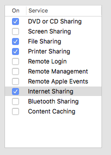

I find myself sharing my Mac Ethernet connection to computers using Wifi, but it involves quite a lot of mouse action and clicks to get done, and likewise to turn it off.
I was hoping to get a simpler solution going, ideally an on/off toggle button (or two buttons) or something in the menu-bar, but an Applescript in the dock would probably be just as useful. Alas, recording my actions in the "Script editor" doesn't work as I had expected. I seem to remember having recorded actions in the past and making them into a script, but that may have been in my pre-OSX days... And a quick web-search reveals that the very few apps support Applescript recording, so that's that I guess.

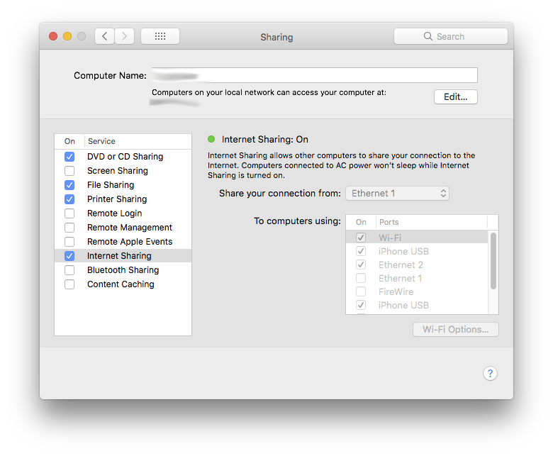

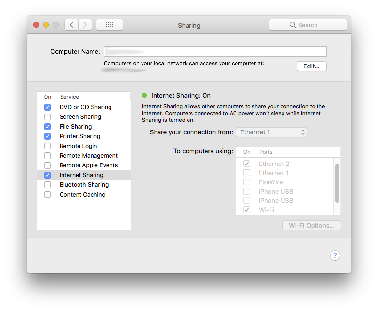

Here's what I do in order to turn ON Wifi sharing:
1) Open System Preferences - Sharing
2) Enable "Internet sharing"

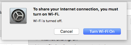

3) Click on the "Turn Wi-Fi on" button (or press RETURN)

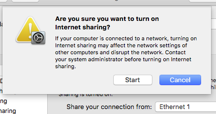

4) In the next dialog window, press the "Start" button

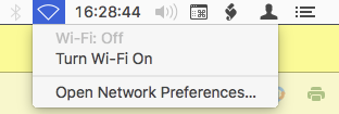

3a) Go to the menu bar's Wifi icon and turn it off, or.....
3b) Open System Preferences - Network
4) Press the "Wifi off" button

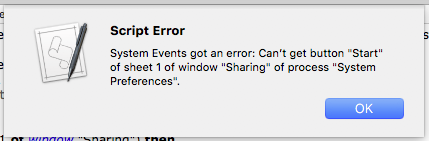

UPDATE: I tried adding the following, but when the "start/cancel" dialog window appears it just waits for my response. If I press the "Start" button myself however the whole script works, so it looks I'm close but not quite there yet ;)
if (exists sheet 1 of window "Sharing") then
click button "Start" of sheet 1 of window "Sharing"
end if

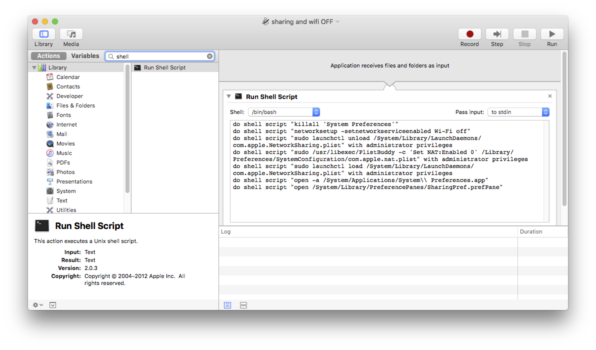

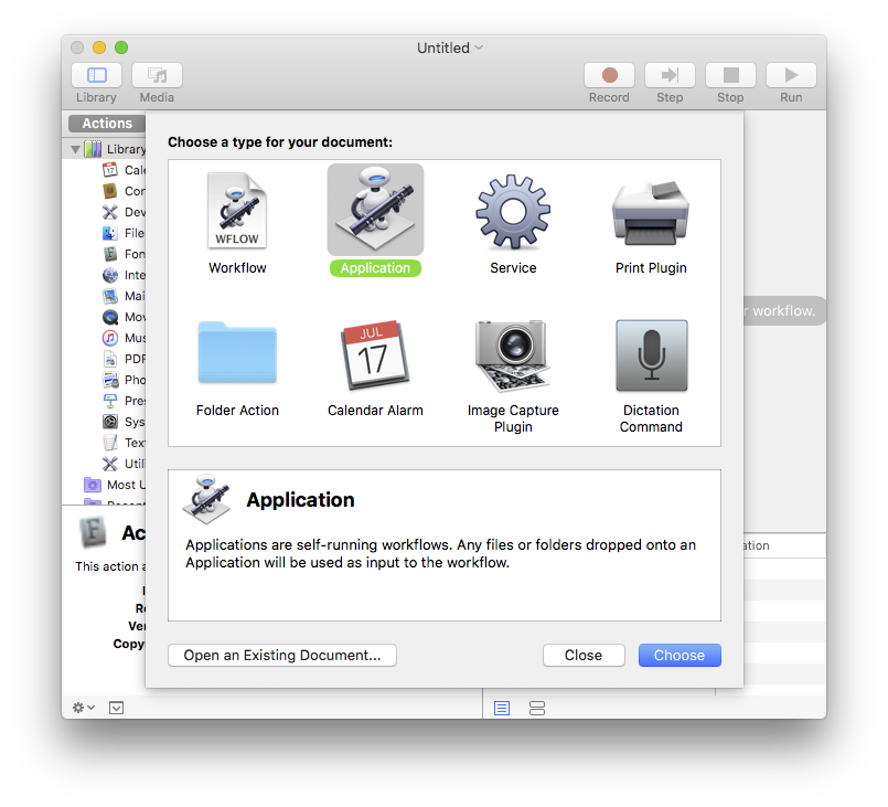

1) opened up Automator and selected a new "Application" document
2) added "Run Shell script" where I pasted your code, then saved the document
3) Back in the Finder desktop I double-clicked the document but only received an error message
I receive similar error messages for the other scripts, so if my procedure is correct, maybe the syntax is indeed incompatible with OSX 10.13 High Sierra.

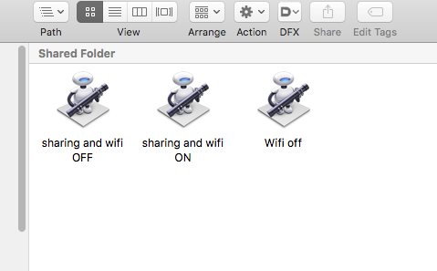

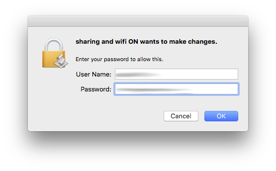

Aha!!

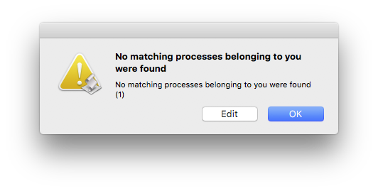

OK, I've created the two Applescript application files but get the following error message (same for both scripts):
So I looked through each line and the following line (in bold) looked to be the culprit as my "Applications" folder is on the root level of my startup drive:
Rich (BB code):
do shell script "killall 'System Preferences'"
do shell script "networksetup -setnetworkserviceenabled Wi-Fi off"
do shell script "sudo launchctl unload /System/Library/LaunchDaemons/com.apple.NetworkSharing.plist" with administrator privileges
do shell script "sudo /usr/libexec/PlistBuddy -c 'Set NAT:Enabled 0' /Library/Preferences/SystemConfiguration/com.apple.nat.plist" with administrator privileges
do shell script "sudo launchctl load /System/Library/LaunchDaemons/com.apple.NetworkSharing.plist" with administrator privileges
do shell script "open -a /System/Applications/System\\ Preferences.app"
do shell script "open /System/Library/PreferencePanes/SharingPref.prefPane"
.... so I changed that line to the following, but I still get the exact same error message:
Rich (BB code):
do shell script "open -a /Applications/System\\ Preferences.app"
The other paths appear to be the same here, in High Sierra.

The last two lines are just for a visual confirmation. You can delete them.

When I run the "sharing & wifi ON" script I'm asked for the admin password:
and then the "Sharing" system pref pops up just as you said it would.
I see it has "Internet sharing" enabled so at least that's working (and likewise, with the other script it's disabled again):
.... but it doesn't turn on Wifi (as seen here in the Wifi status menu-bar item):
If I "help" it a little by manually clicking on "Turn Wi-Fi on" in the menu-bar I would expect it to share wifi but instead it starts looking for networks.
And if I run the opposite script (sharing & wifi OFF) I likewise expected the wifi icon in the menu-bar to turn off, but instead something strange happens as it turns into "Not configured" and in the Network system preference Wifi is inactive:

How does all of this work on your computer? Is it a matter of a single click on the scripts to turn it all on or off, and the wifi menubar icon confirming if it works or not?
I have High Sierra in a virtual machine without Wi-Fi, here is how it works with Ethernet
