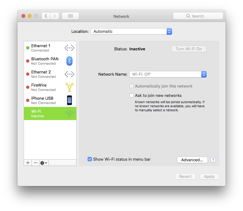

networksetup -setnetworkserviceenabled Wi-Fi on
Then I tried the following command which resulted in this:
Code:
networksetup -setnetworkserviceenabled Wi-Fi off

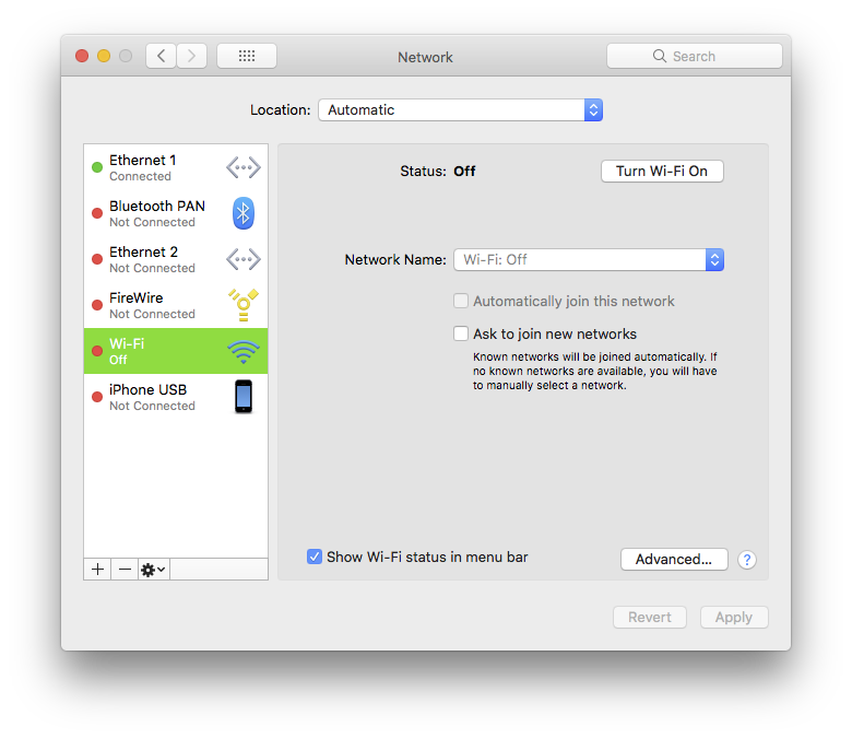

and finally I repeated the "on" command. This resulted once again in "Wifi off".
So the command switches between wifi OFF and wifi DISABLED, but not wifi ON.
I would expect the "off" command to work as the "on" command does now (wifi=off) and there must be some command for turning it on. Confusing.

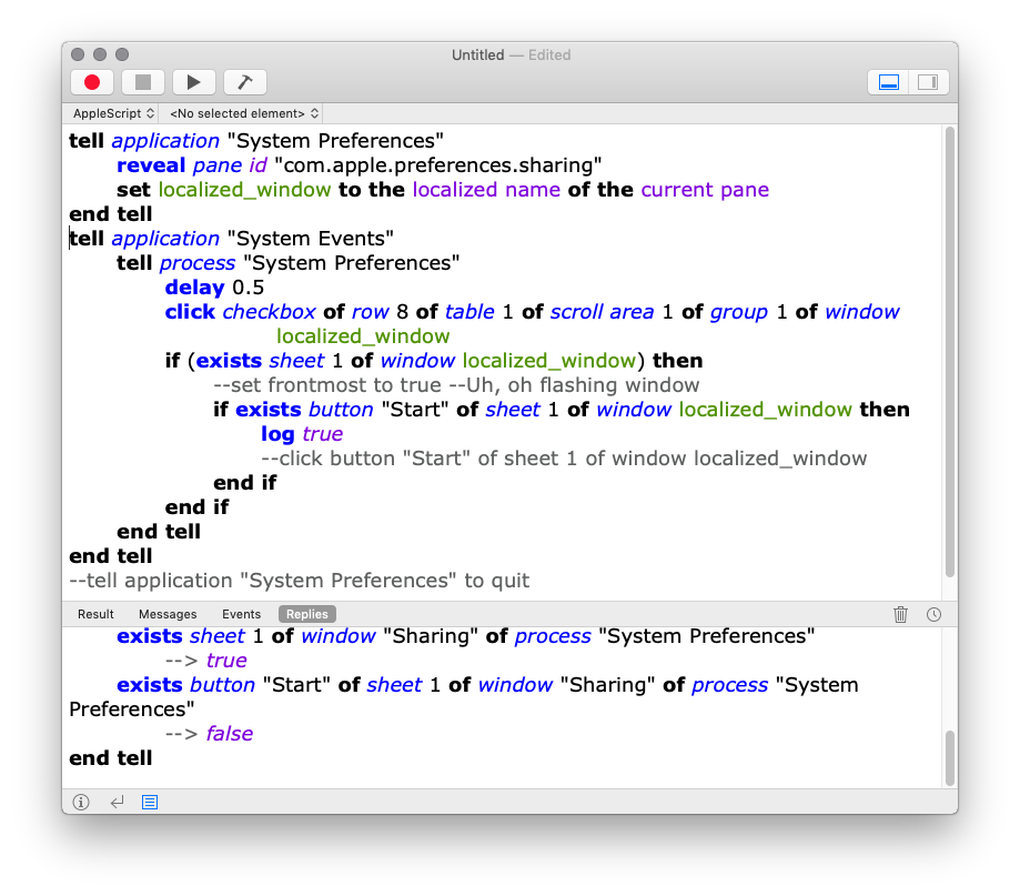

Cool! A single script that toggles on/off makes things even simpler.

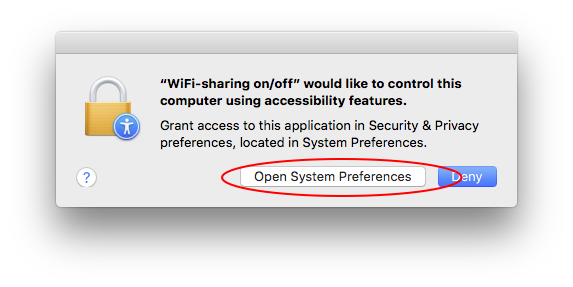

But I can't get it to work here on 10.13 High Sierra (it looks like the script is the last one in the discussion thread, modified for OSX 10.14 Mojave).

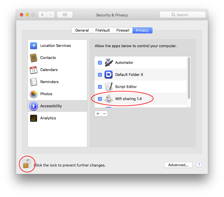

After allowing it in the OSX security preferences it does run, but ticks on/off "Remote Apple events" (instead of "Internet sharing" and doesn't toggle wifi on and off.
I bet the first problem is the checkbox number which doesn't match "Internet sharing", and although wifi doesn't have a checkbox it might be the same thing there -I'll look into it.
UPDATE: I believe I have a working version of the script :)
I'll do some extensive testing and check back here when done
gui scripting… you have to check what Apple changed between MacOS releases to get the right pane… :cool:
OK, got it working after some minor tweaking! 👍

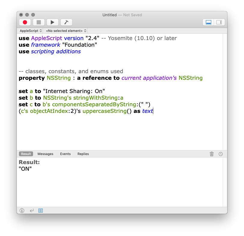

OK, I see.
I typed in the text from your screenshot to try out but am a little unsure about how to incorporate it into the rest of the script.
With my limited coding abilities I'm guessing from the code that this "NSString" might be the wifi status string, but may be way off here :oops:

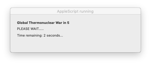

It seems there's no way in Applescript to create an alert or dialog window without buttons to press :(
So I considered using the Notifications instead by adding a notification at the very start of the script (so the user can see something is happening):
Code:
display notification with title "AppleScript running" subtitle "PLEASE WAIT...."
That worked of course, but before that window closed the above text got replaced with the end resulting notification text as from this part of the script:
Code:
    set sharing_state to the value of item 1 of static text of group 1 of window localized_window
    display notification sharing_state with title "Wifi sharing"
The whole idea with the alerting is to_
1) alert the user that something has indeed started up (despite not seeing anything happening on the screen)
and
2) tell the user what has happened (wifi sharing status on or off)
From a user point of view I would want a new window of some sort to pop up to alert that new information is presented and should be read, so one solution was to change the delay further down the script from 0.5 to 2.1 (anything shorter just replaced the text in the same window).
This would allow the first notification to close, followed by a new one opening, but of course taking longer for the script to complete. Here's the entire script with these changes:
Post something where you've tried to implement what you found as a whole script. Those one-liners are useless as there are pieces missing. What is the result of that last piece of code when you run it and replace "yOurSTringHeRe" with "Internet Sharing: On". Is the result as you expected?
Info: cocoaDialog
Sorry about that. I'll try to post the results as well.
I haven't actually tried out the last piece of code yet as I didn't know if it was even applicable for this situation or not (I'm not very familiar with coding so it's not obvious to me).
Does it look like this could to the trick (change the results of the "sharing_state" string to all UPPERCASE)?
That screenshot of the window without any buttons is exactly what I'm after! So does that mean everybody who uses the script is dependant on having CocoaDialog installed, or does only the person who creates the script (me) need to install it?
Seems like it. Try stuff.

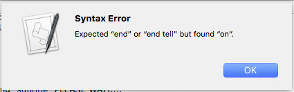

But this results in an error regarding the syntax:
It seems I need to use a different syntax in this context, while in the example from the other thread it works like I used it. I'm not sure what to change here.

5) When security-alerted (this will only happen the first time you run the script application), click on the "Open System Preferences":
6) When the Security & Privacy system preferences open, first click on the lock (bottom left corner) and enter your password, then (when unlocked) enable the script application to control your computer. Finally close the System preferences.
7) click on the application icon in the dock once again. Now it'll run properly and won't ask for your password again. Try it a few times to see that it switches on an off Wifi-sharing.
