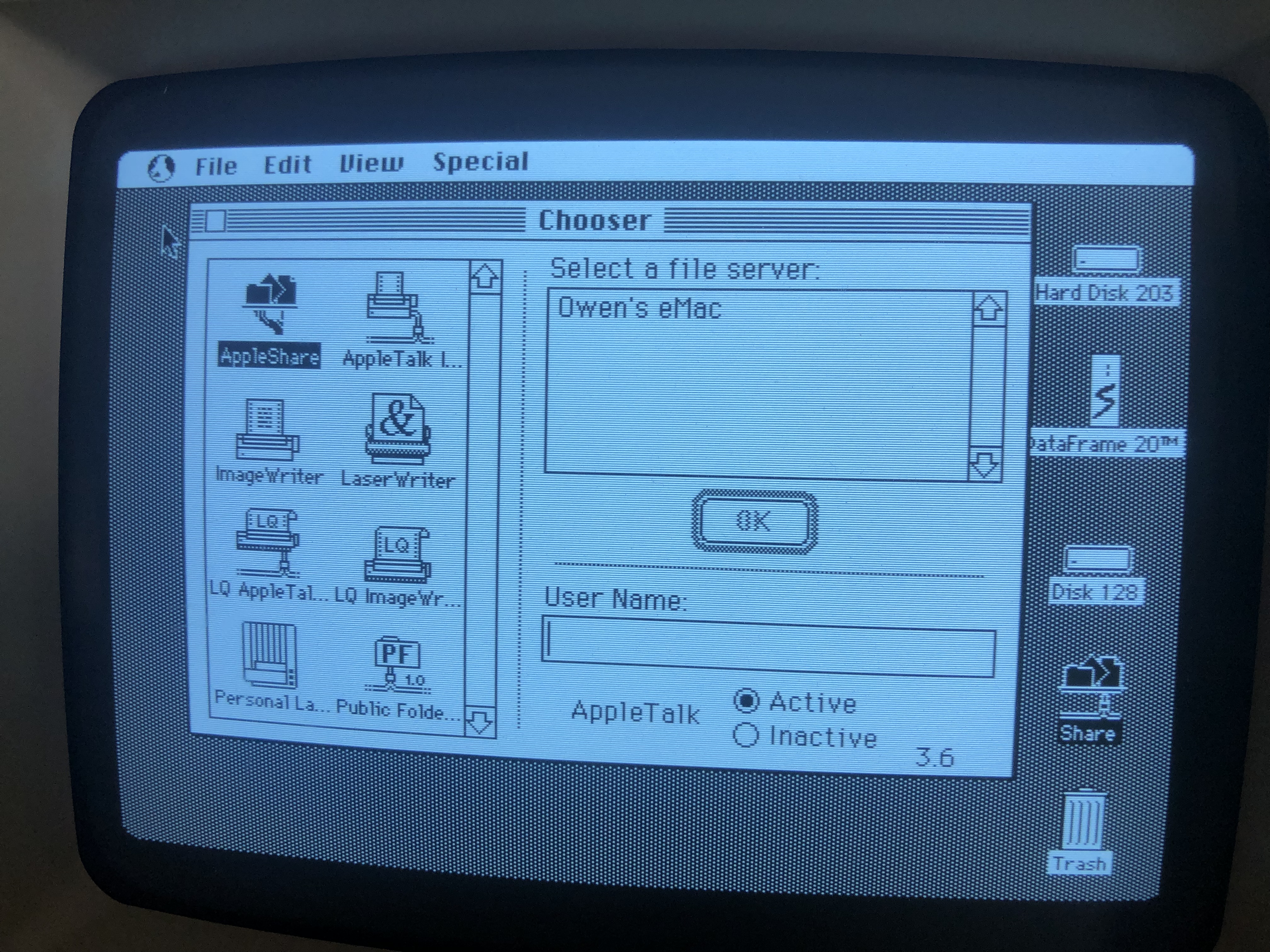

I have no idea why.... but on the 347,981st try, it showed up in my Plus Chooser!
No idea why....
Now I can move files from my eMac to the Plus, but Plus cannot add files to the shared drive. The privileges are set for Read and Write, And I am logged onto the server as a Registered User (who I have also made the "Owner" of the shared folder)
Crazy leap here.... I was shocked when I saw it pop up. I am now well on my way to getting this network going, now I just need to figure out how to share from the Plus to the eMac. The mounted drive on the Plus shows 0K on disk and 0K available.
Progress!!! So close to being home!

And here it is, in all its glory!
It has been suggested that perhaps the size of my physical hard drive on the eMac is causing the issue. I have a 30 GB hard drive on the eMac, and my shared "drive" is just a folder on the main drive.
I might try to mount a 20MB virtual drive on my eMac and make that the shared drive. If the issue is truly that the Plus can't write to such a large partition, then this will eliminate that problem.
Either way, I'll prove or disprove that theory today.
Confirmed.... creating a 160MB volume with Disk Copy, formatting it, and then opening it up for sharing allowed the network to function as expected. I'll do a full write up tonight. 🙂
