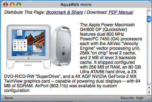

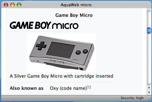

So, cool news. I did some experimenting around again, and I found that ultra small windows (480 x 320), while now stretching into novelty / gimmick territory due to their diminutive size, are regardless incredibly fast at loading pages, even on literally 20-year-old hardware.
So I figured that if said 20-year-old hardware can remarkably cruise around the modern Web mostly unhindered (think late G3s / early G4s), the trade off in viewing area is needless to say probably worth it in the end.
So, here's AquaWeb micro; packing several bug fixes, another snazzy new icon, and gimmicks performance to spare. :)
But that's not all, I also found out that TenFourFoxBoxes are one of the few applications to massively benefit from QuartzGL integration on 10.5.x systems, so now it comes with that built-in, too. So on top of having less pixel area to draw (thus placing less demand on the CPU), rendering performance has easily been doubled on compatible environments.
Give it a try!
