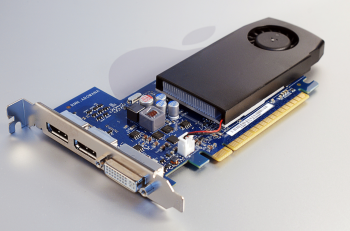

Or two of the HP GT 630 (most similar to the old GT 120). Kepler = OS X compatible without Nvidia web drivers, each one with two DisplayPort 1.2 connectors. There are plenty of HP GT 630 on eBay.

@ gjarold: Get two HP GT 630 (model with two DisplayPort connectors) on eBay and enjoy: https://www.ebay.com/sch/i.html?_fr...C0.H0.XHP+GT+630.TRS0&_nkw=HP+GT+630&_sacat=0
