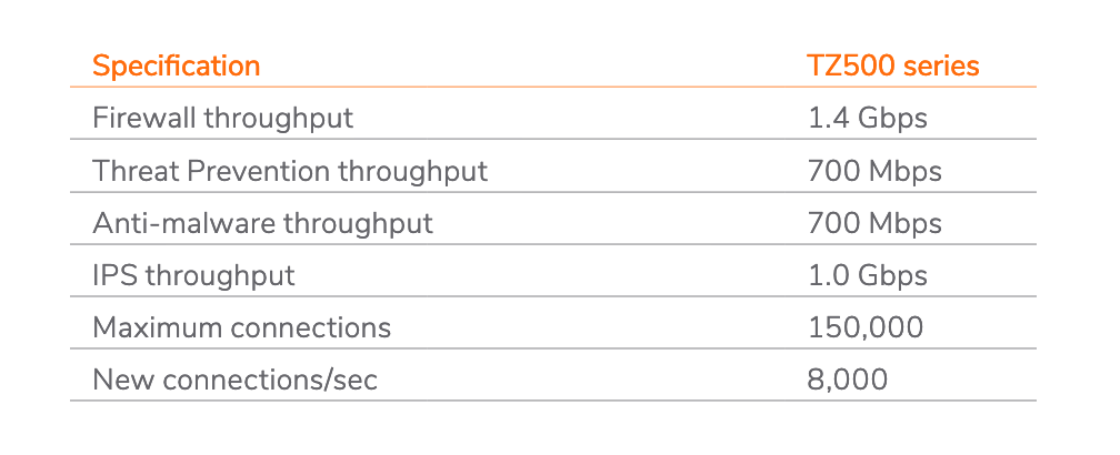

The Sonicwall is a TZ500. It's not a windup toy firewall. I don't think it's a large part of the problem. It's well capable of handling the traffic from my U-Verse connection, I'd think.
Looks like a good ethernet router. If you install the Developer HUD on the ATV you can compare how much bandwidth it is using on ethernet vs WiFi.
Not really. Reading between the lines, Threat Protection costs you half the throughput, Anti-malware cuts it in half, IPS gives you 70%. Therefore, you turn all of those on, you can make 250 Mbps, which is about half of my home cable. Besides, those are always the best case, some traffic types require more complex inspection, which chokes them up.
The root problem with those things is they stick firmware meant for a multi-socket rackmount Xeon system on crappy embedded processors.
In any case, you should be able to connect to it and monitor its CPU usage, instead of just assuming expensive=good.
None of the security functions are turned on. This is an NFR Sonicwall, and I spent a few hours on the phone with them last week trying to get it updated. They used to have s SKU to update an NFR unit to a non-NFR status, but apparently since they were spit out my Mike Dell, they figured they didn't need that money (OR wanted the money of selling another TZ500?), AND short answer, I'm looking for a replacement firewall. But that still doesn't explain what's going on with the network right now.
