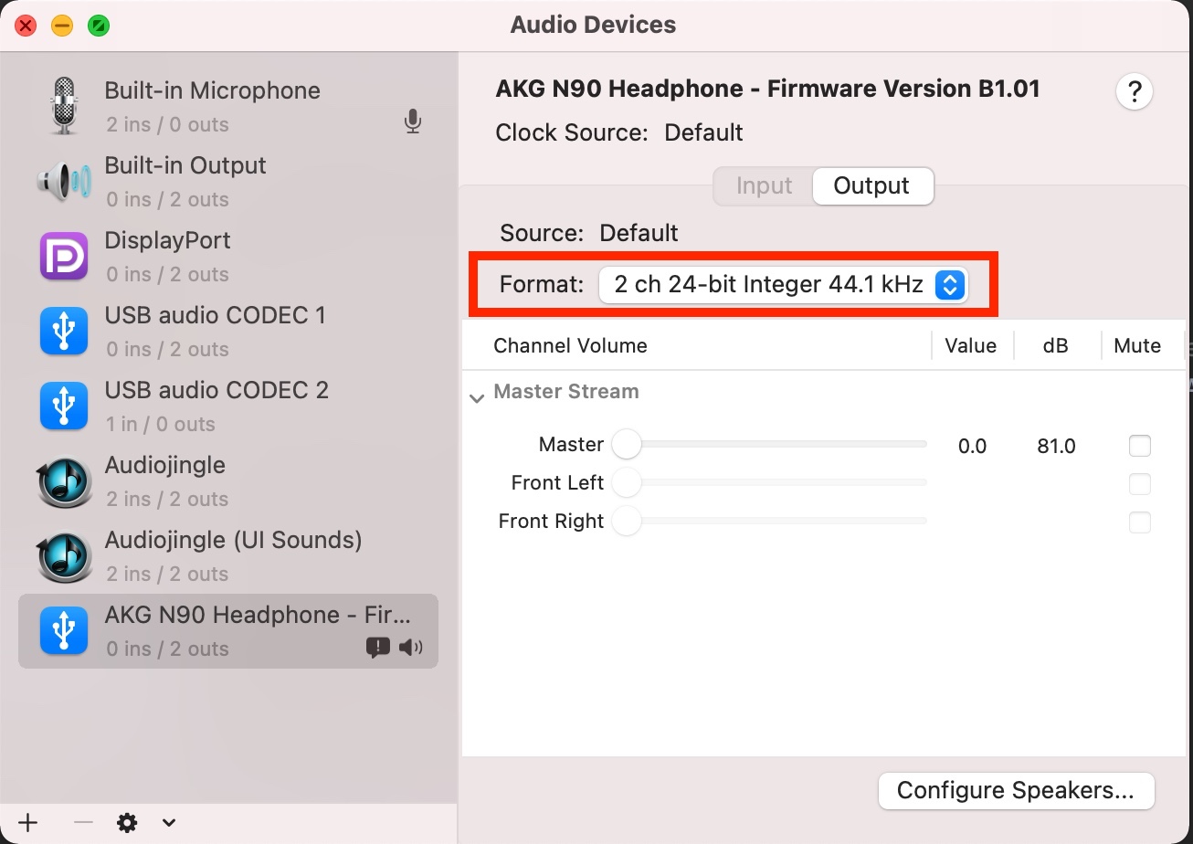

Hi,
For anyone facing this issue, may I suggest you to try some other sound format in the "Audi MIDI Setup" tool: it worked for me, dropouts that appeared months ago on Big Sur are now gone.

Hi,
curious what settings worked for you using the MIDI tool.
That's good for you if that's now resolved. Just for your information, the settings that work for me are as in my screenshot: 2ch 24bits 44.1khz, with Mac Os Big Sur 11.6.3
