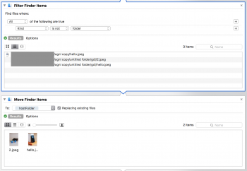

Hello,
I have a workflow that takes all the files from a directory and any within subdirectories, then moves them. The files are filtered, then moved. But, as you can see my filter picks up three files but only moves two. This must be because it can't move two files with the same name into the one destination (I assume). I want to stop/end the workflow if this happens, unfortunately renaming or adding a number to any duplicates is not an option due to their filename linkages within other applications.

How can I end/stop/kill a running workflow from the AppleScript step? Ideally that would happen when the user hits "Okay" on the existing alert dialog.
I am testing as a .workflow file. But this will eventually become an application once ready.
Thanks!
