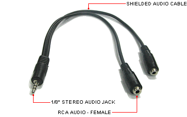

I use the old 30 pin composite AV cable from Apple, connected to the Lightning to 30 pin adapter, and a Y adapter from the RCA left and right audio into a 1/8" jack for my aux in. I ran all of this under the console, and wired a USB charger as well, so one cable from my dash charges and play audio from the lightning port.

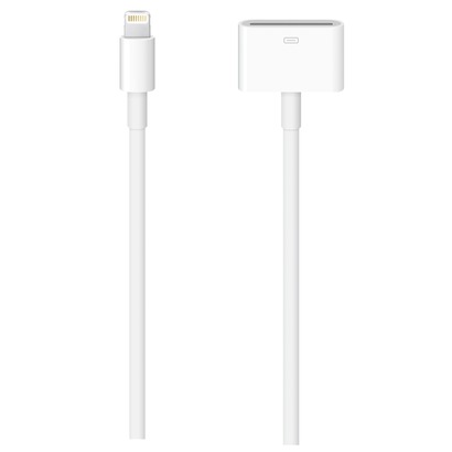

http://store.apple.com/us/product/MD823ZM/A/lightning-to-30-pin-adapter?fnode=45
but it should have the same features (Supports analog audio output, USB audio as well as syncing and charging. Video output is not supported)

Right now I'm using this combination:
Apple branded lightning to 30 pin (charges and carries audio unlike 3rd party units).
30 pin audio to 3.5mm and + - to charge
3.5mm input on radio
