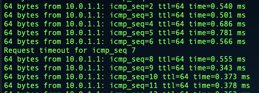

However after testing is I've found out that it's terrible for anything that requires stable connection like SMB transfers or game streaming
It frequently drops simple pings to the gateway:

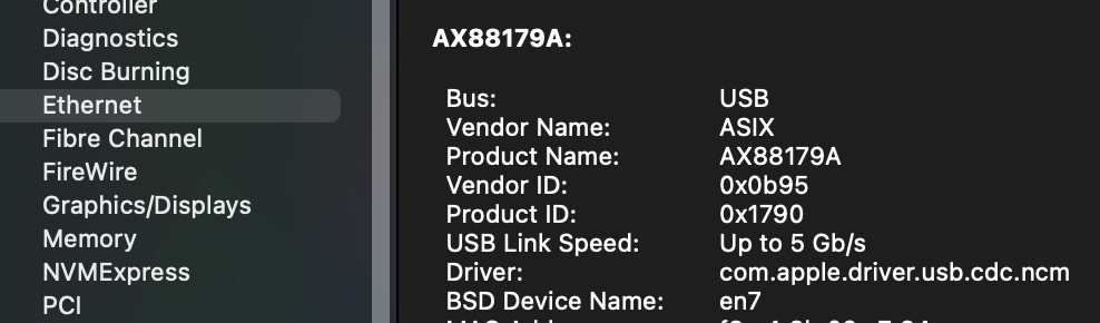

It's using apple native driver:
My question is: Are all USB Ethernet adapters like this on macOS? I've read that AX88179A and RTL8156B are the "okay" ones because of usb.cdc.ncm drivers

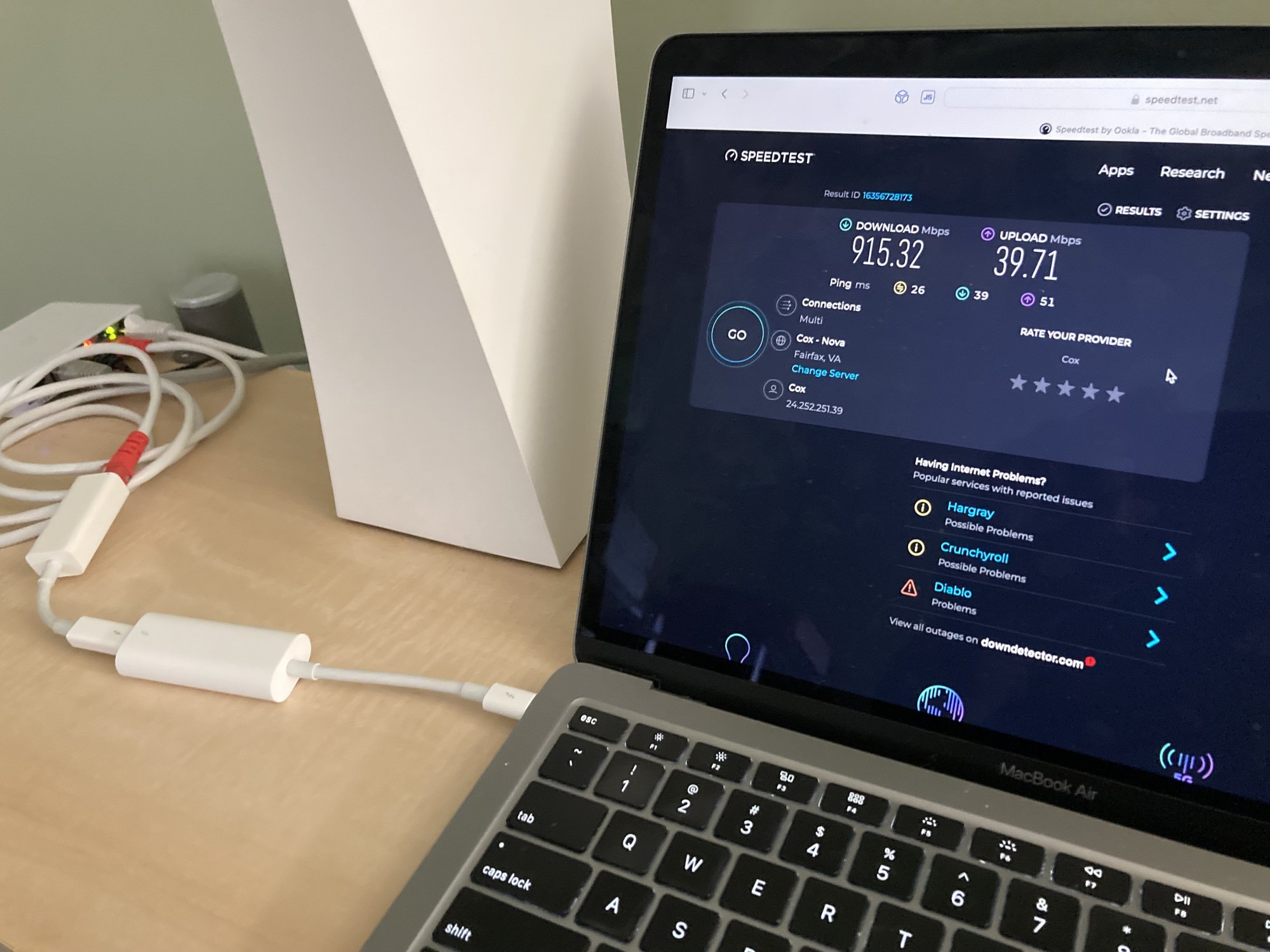

The arrangement of TB3>TB2 - TB2>Ethernet works perfectly on the following Macs in my household - 2019 MBP 16", 2020 i3 MBA 13", 2019 MBP 15", and 2022 M2 MBA 13"... and should work on any Mac desktop w/ TB3.
Updated w/ pic of the 2020 i3 MBA (arguably the lamest of our household Macs) connected via ethernet using the TB3>TB2 - TB2>Ethernet adapter chain. Note the download speed. This configuration worked like a champ for wife's remote WFH during height of pandemic.

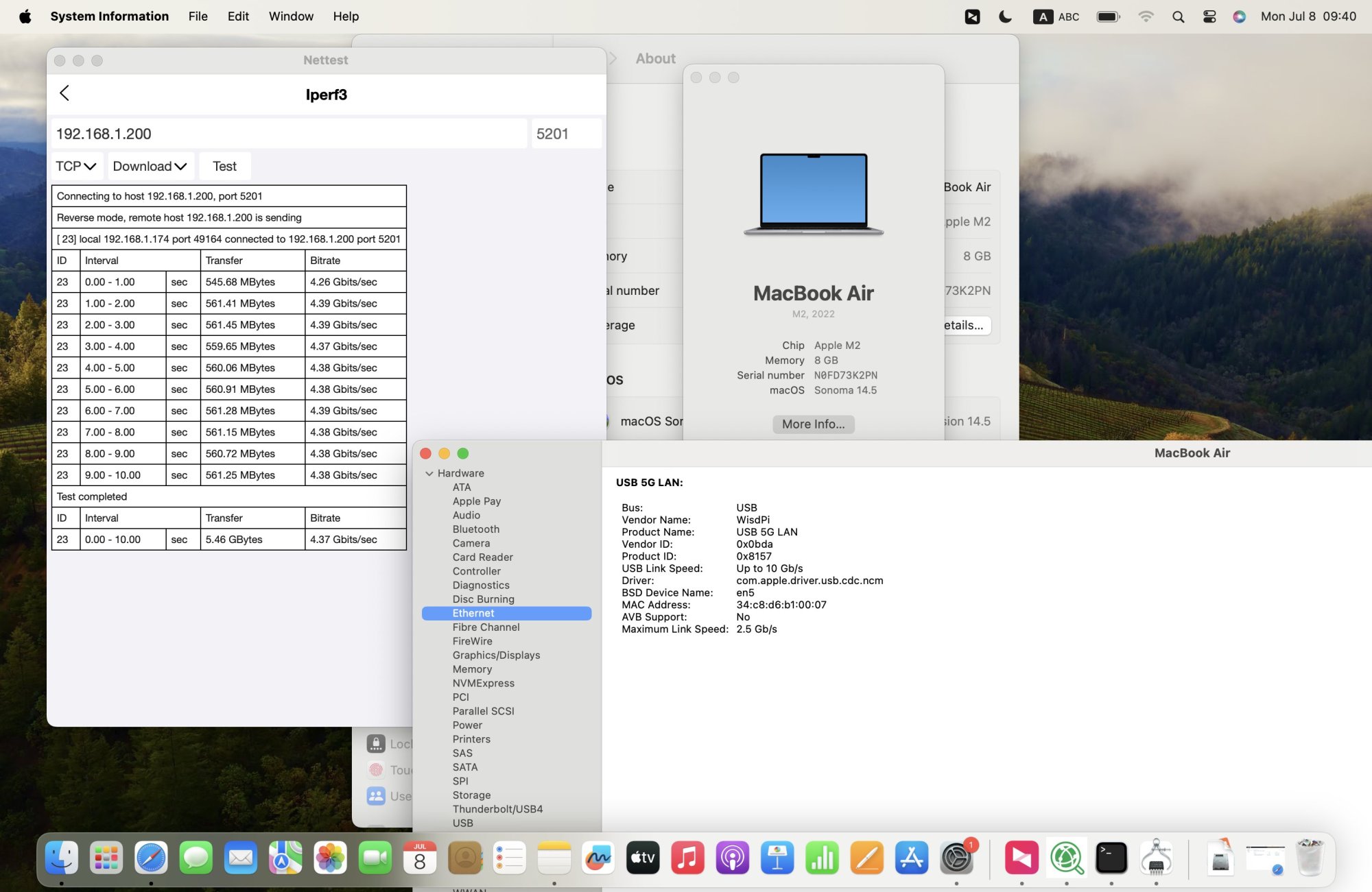

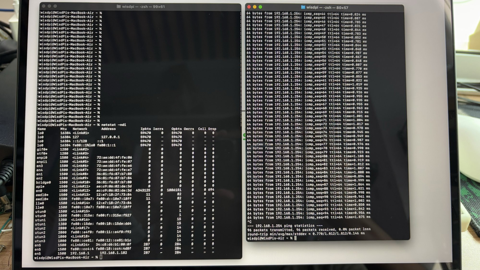

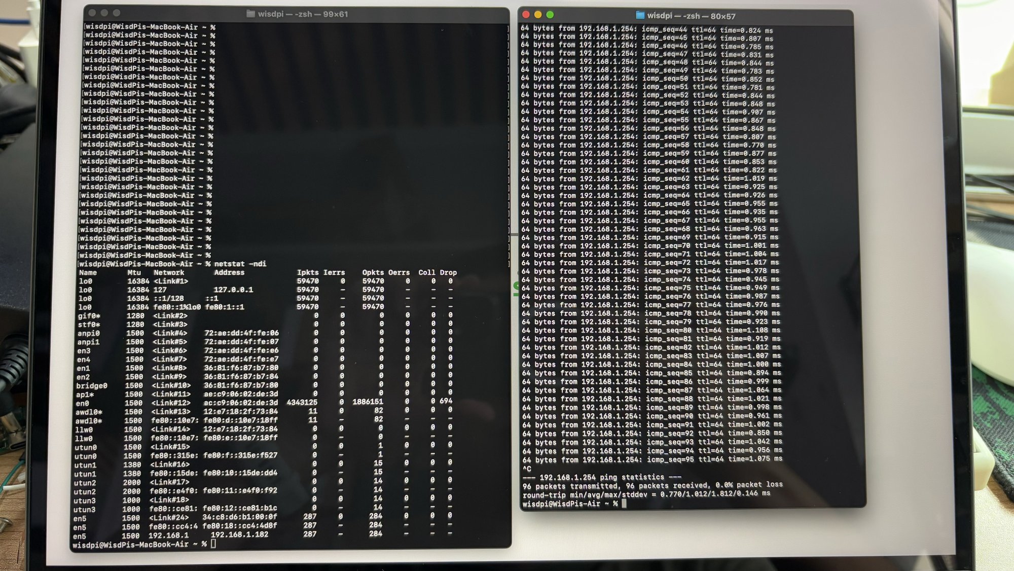

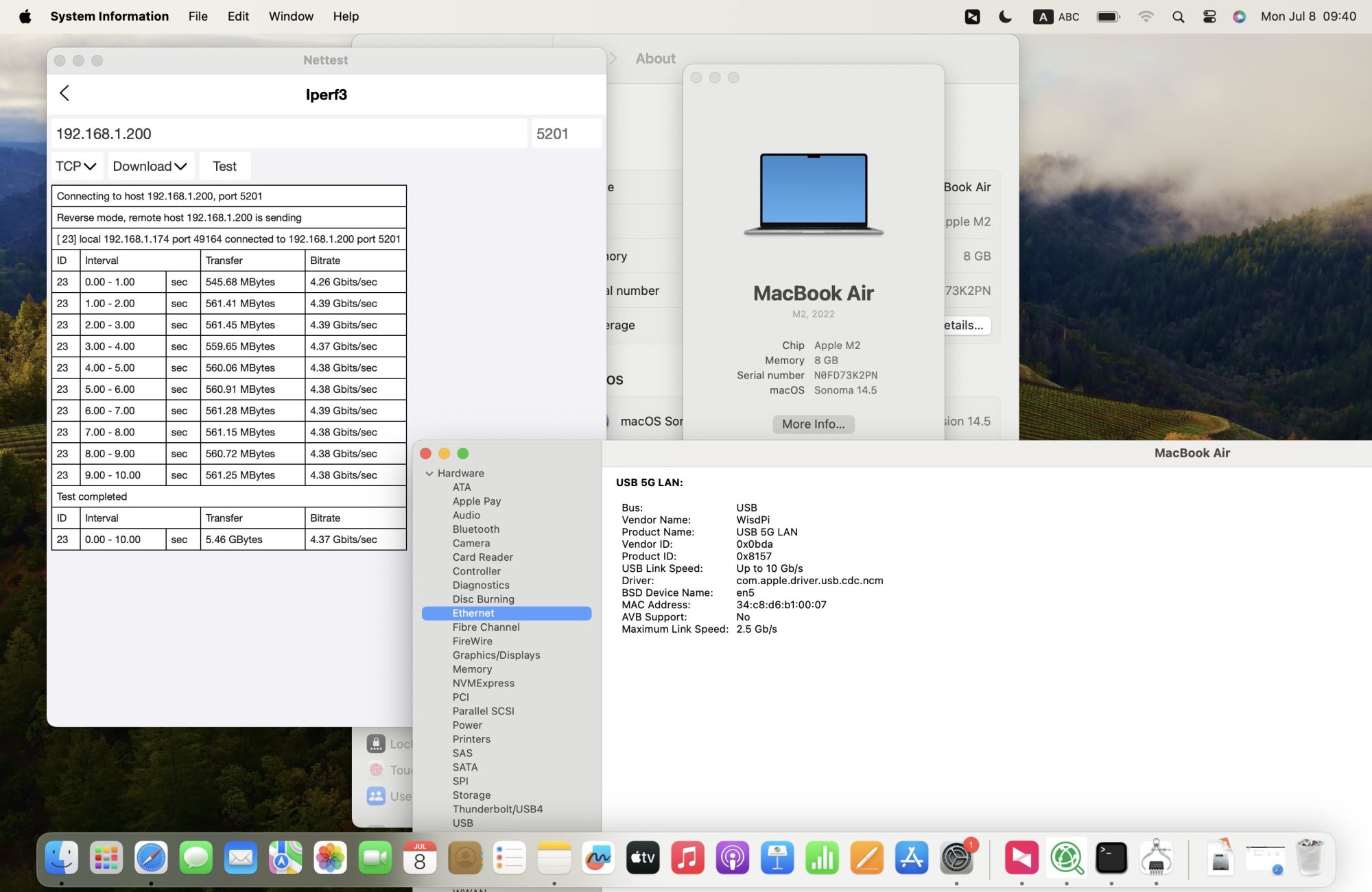

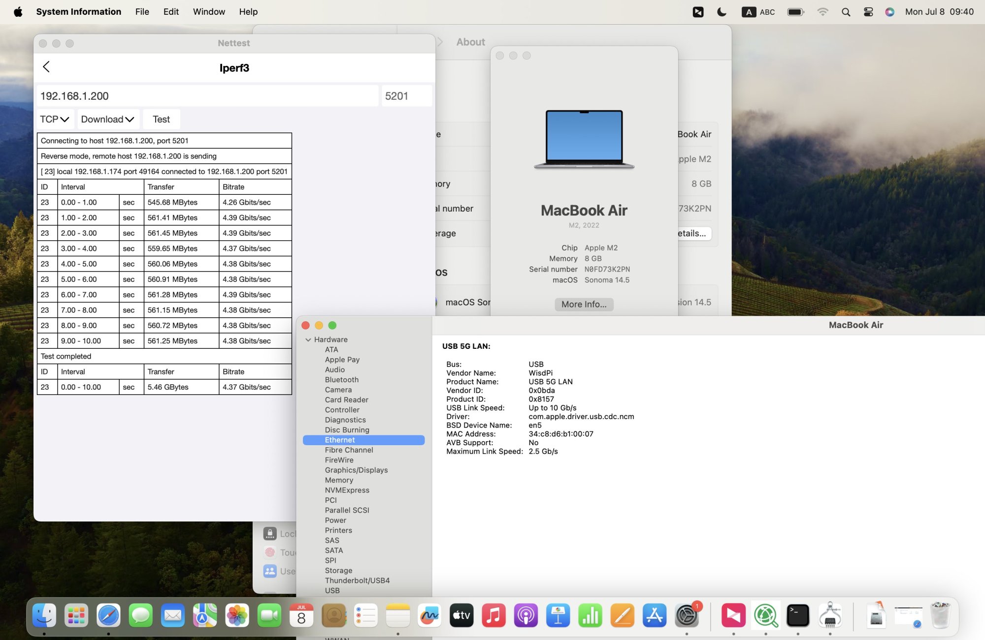

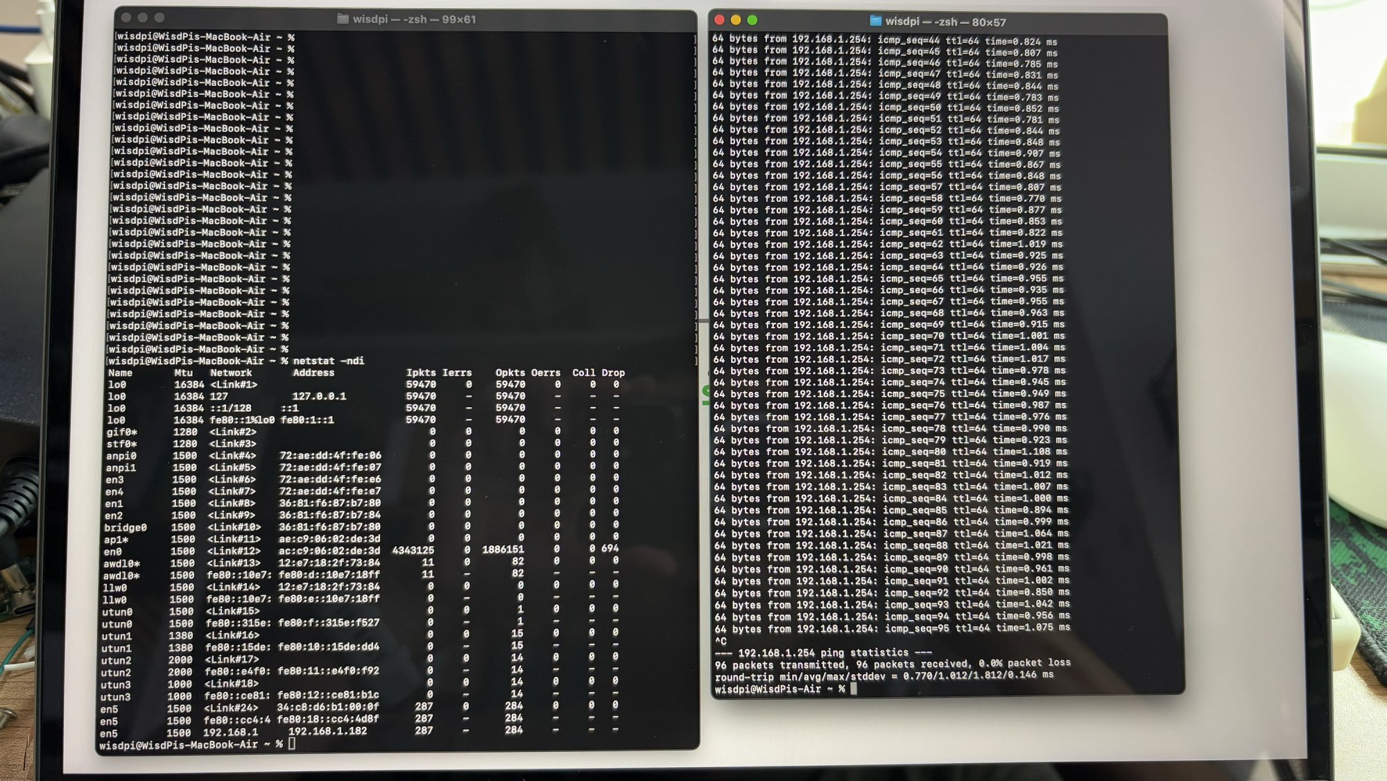

We are WisdPi. This is WP-UT5 test result on Macbook Air M2.
  • Love
Reactions: Papaj2137
Thank you, ordered. Were you able to test it with macos 15 sequoia?
It should be available soon, but for now, Mac is using the CDC driver. I believe it should work without testing, and the performance difference should not be significant.
