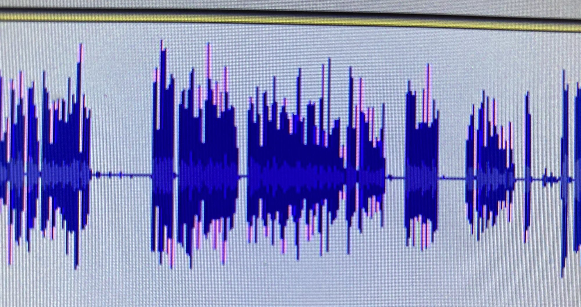

I'm just not switching over to a new Mac mini M1 from a 2018 Intel Mac mini. I'm using a BenQ EW3270U display. And I'm seeing some horrible issues with some stuff (not all). I don't get it. Like, here's a sample of Audacity in a highlighted track. What's that red tinge?? I'm seeing this in Firefox around red text on white background, too.
I'm using a regular HDMI cable. I've tried using a diferent HDMI cable, but it was the same. Not sure what version of HDMI cables I have (and not sure how to tell). But again, my 2018 mini didn't have this issue.
I'm also scaling the screen because the native res is too small for my older eyes, even with glasses. Native is 4k - I'm using 3840x2160, which is the next option the Mac gives me. I can't recall what the 2018 Mac mini gave me as an option, but I think it was a step between 4k and this, because this definitely looks weird to me (widgets, text too big). I can't tell if it's happening at native resolution... it's much smaller and harder to tell.
It doesn't seem to be everywhere... only certain weird places/situations on the screen. Or maybe it's only noticable in certain color combos, etc.
This has to be something simple. What am I missing?
Do you mean 1440? That’s what you had selected in your screenshot. I have an M1 mini with hdmi connected to a 4K display, and I’m going to try and replicate your issue.
Okay, looking at your original post again and reading what you said I'd bet money it's just the scaling.
Yes, sorry... 2560x1440 is what I'm using, on a native 4K display - which you can see in the image I posted.

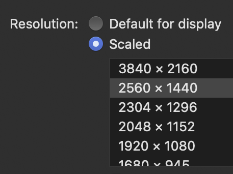

Yeah, good call - thanks! And it seems to be fine. See below. And I'll also say that it behaves much better at native resolution, too. The scrolling is horrible when scaled. There's massive delays when selecting segments of the waveform, too. All goes away at native resolution.

Just out of curiosity, if anyone knows... what exactly determines the available resolutions on a monitor (as shown in the original post above)? Is it the capabilities of the monitor? The graphics card? The OS? The connection protocol (HDMI, DP, whatever USBC does)? All the above?
One reason I ask (beyond just being curious) is that I swear the Intel 2018 Mac mini offered a scaled resolution between 4K (3840x2160) and 2K (2560x1440). I'm 90% sure of that... whatever resolution I was using on the 2018 box wasn't this magnified (ie, resolution must have been higher than 2560x1440).

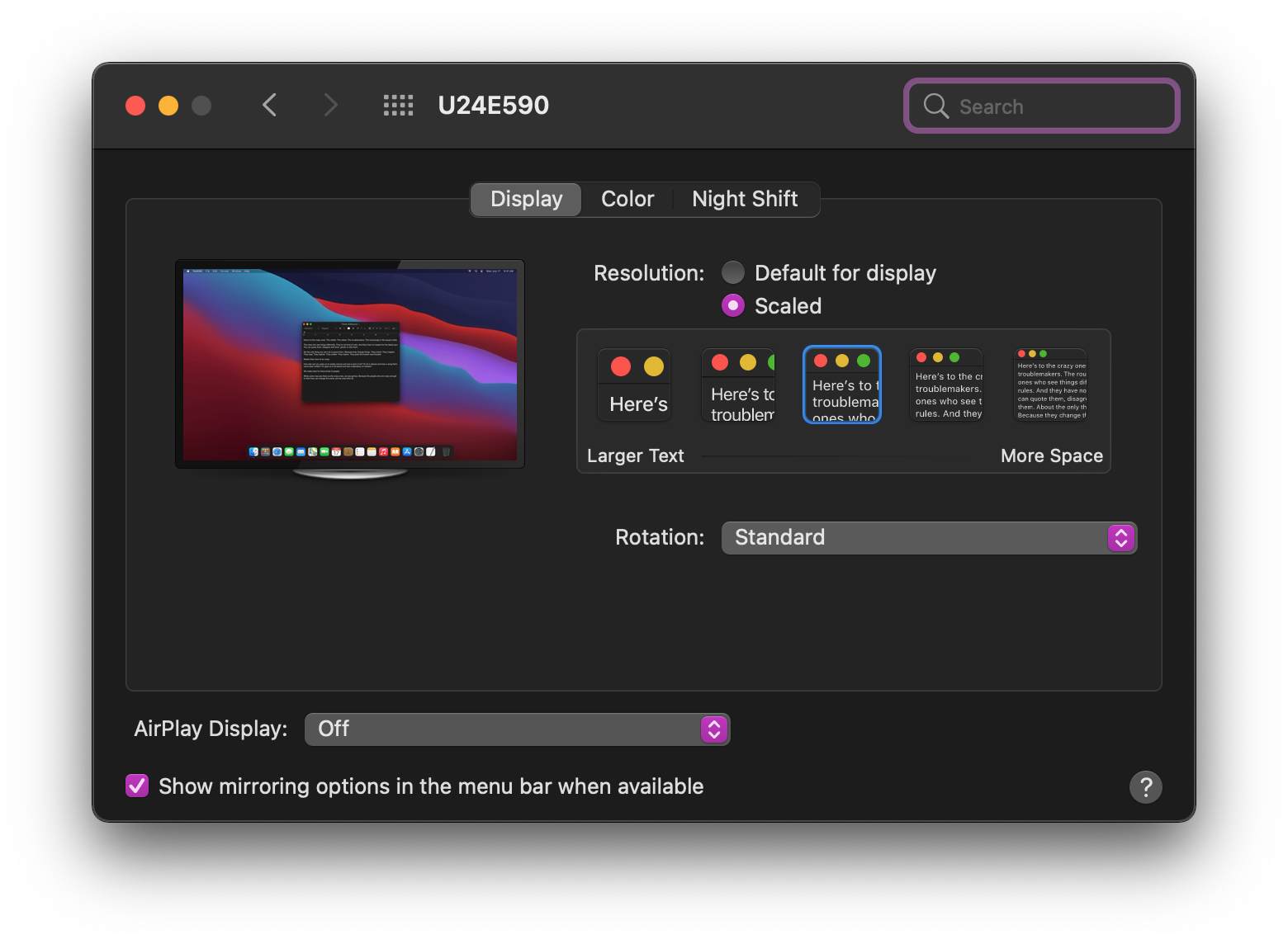

For what it's worth - I don't know if this is controlled by the connection protocol or the monitor identified by macOS or what have you - but my "scaling options" are different than yours.
If I hover over the selected in the middle, it says "looks like 1920x1080" - that middle "scaled" setting is also how it appears when I select "default for display," which is how I usually leave it. It's normal 4x scaling for 2160p, as far as I can tell. The rightmost option for "more space" says "looks like 2160x1440."

You have to hold the Option key click clicking the scale to see the numerical choices.
