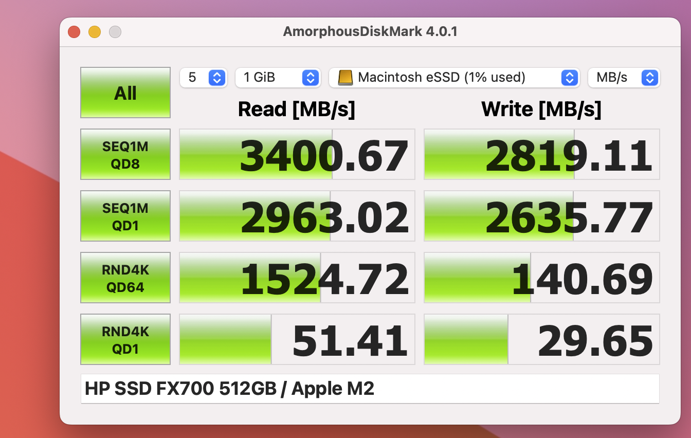

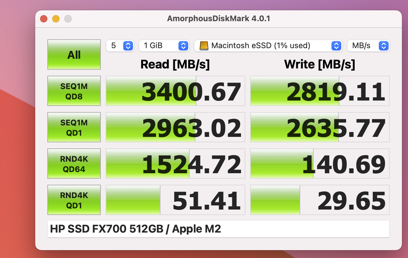

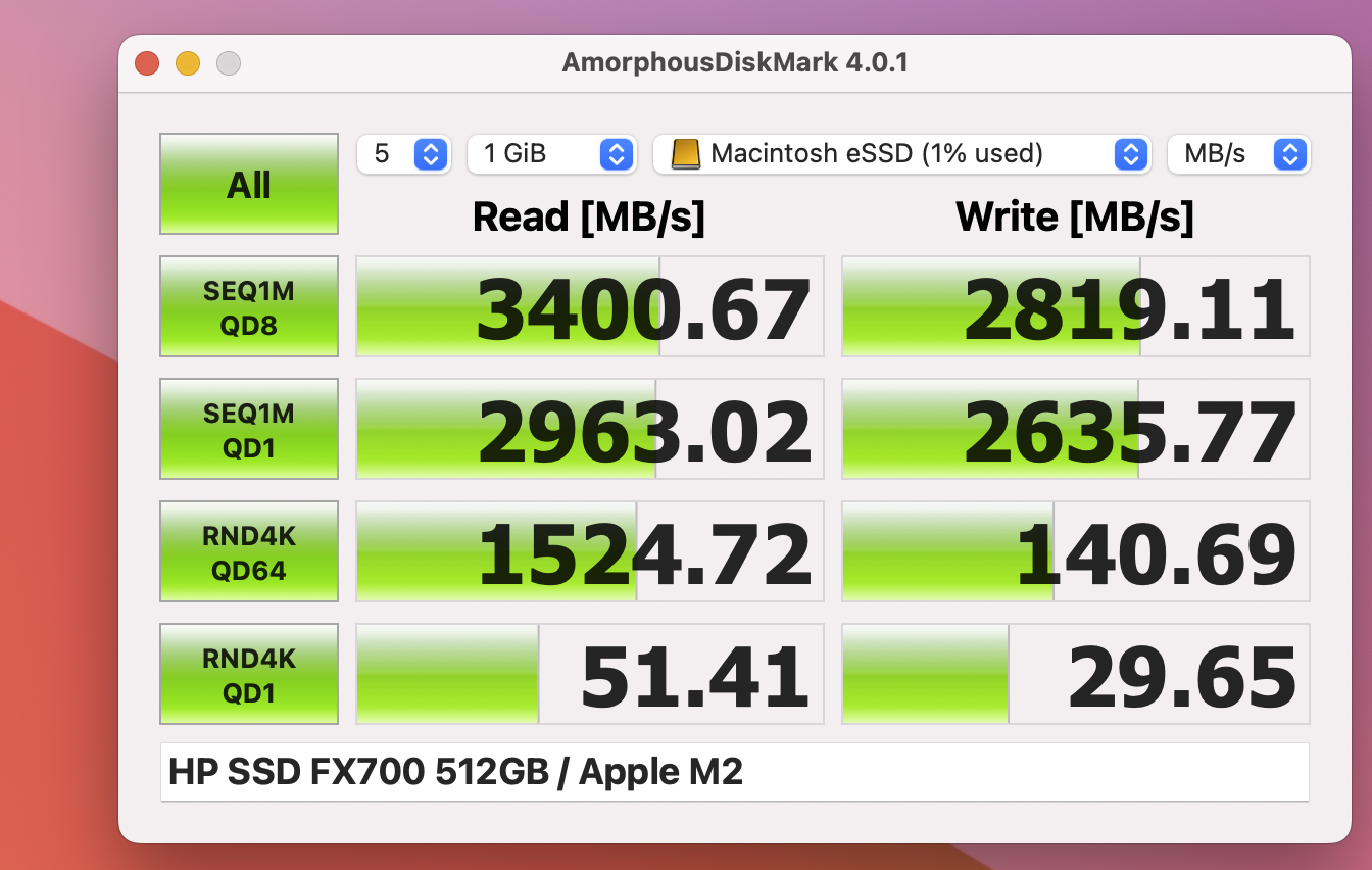

Tried both methods. The disk speed is quite high. Slower than the internal, but still fast enough. Larger SSDs (1-2 TB) have higher speed performance.

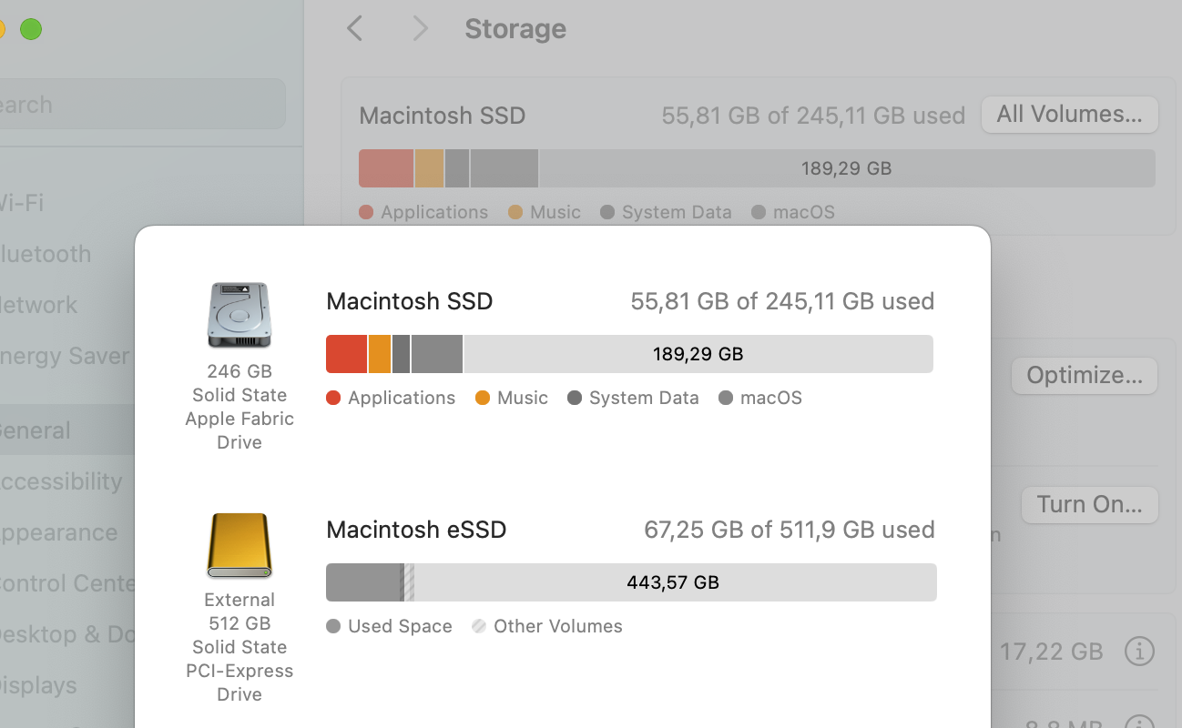

Installing the OS on an external SSD is not difficult. I chose the second method.
Steam allows to choose the installation location and creates a shortcut. In some cases, an alias is created, transferred to the launchpad and grouped as you need. Expanding disk space is not difficult at all
