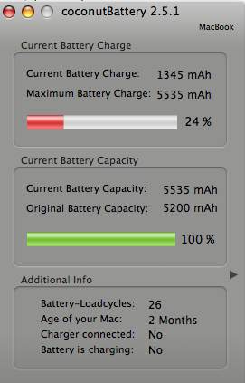

hey guys! i always charge my battery up to its maximum and den discharge it to about 20%! this is my current battery state
What do you think?

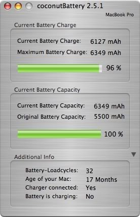

I saw this thread and decided to test my battery. How can the current capacity be higher than the original capacity?
Coconut Battery doesn't actually know what your original capacity was. It assumes MacBook batteries are 5200 mAh and MacBook Pro batteries are 5500 mAh, but there are variations in this value. So presumably, your battery was actually > 5200 mAh when new.
Perhaps there's been a battery hardware update since Coconut Battery was created to increase capacity? Does anyone have a new MB, Pro or not, who can check their capacity?
