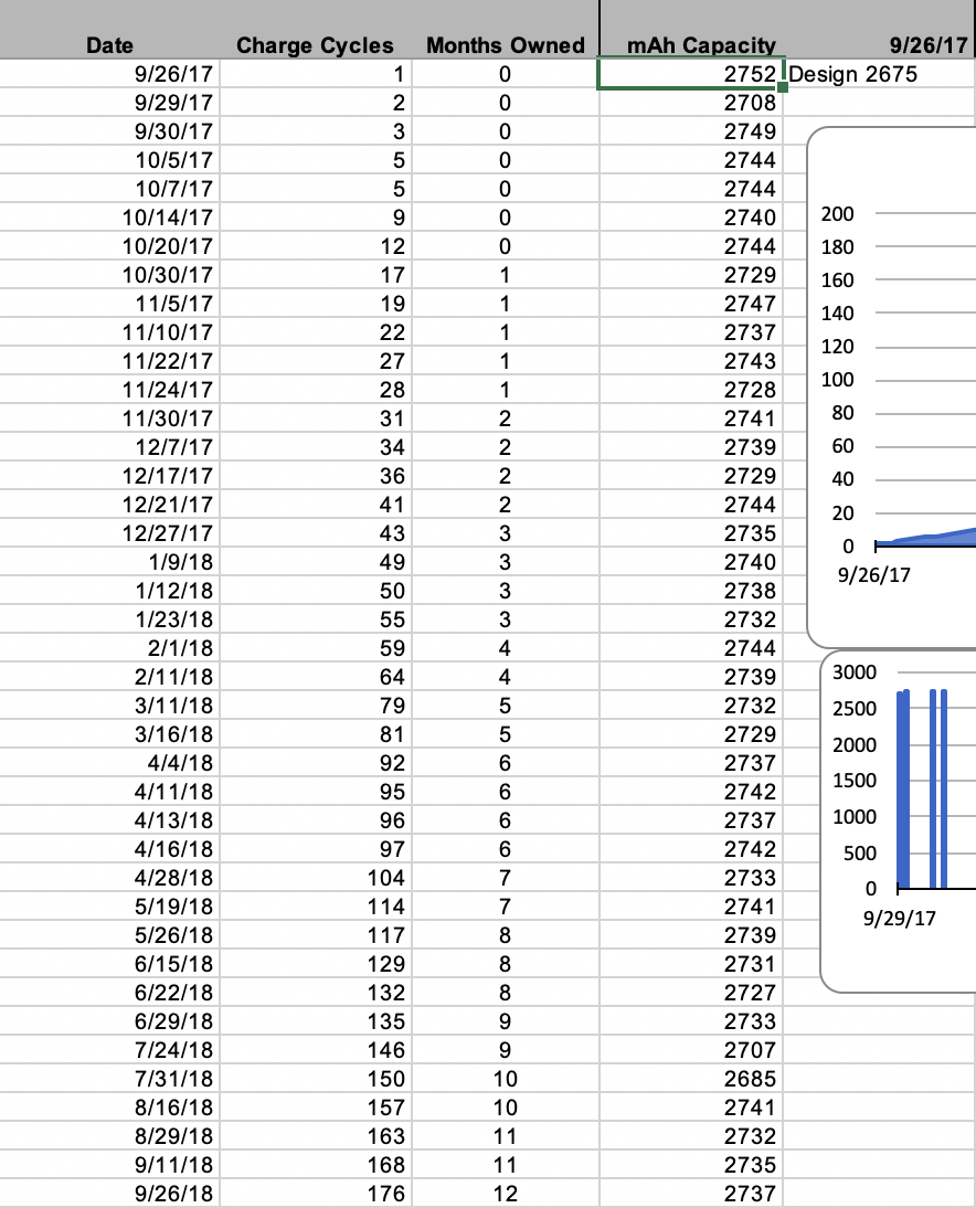

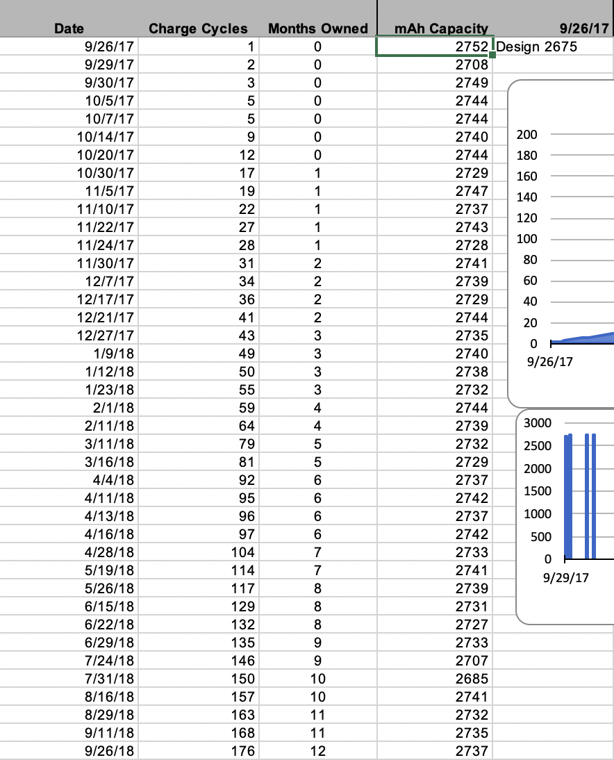

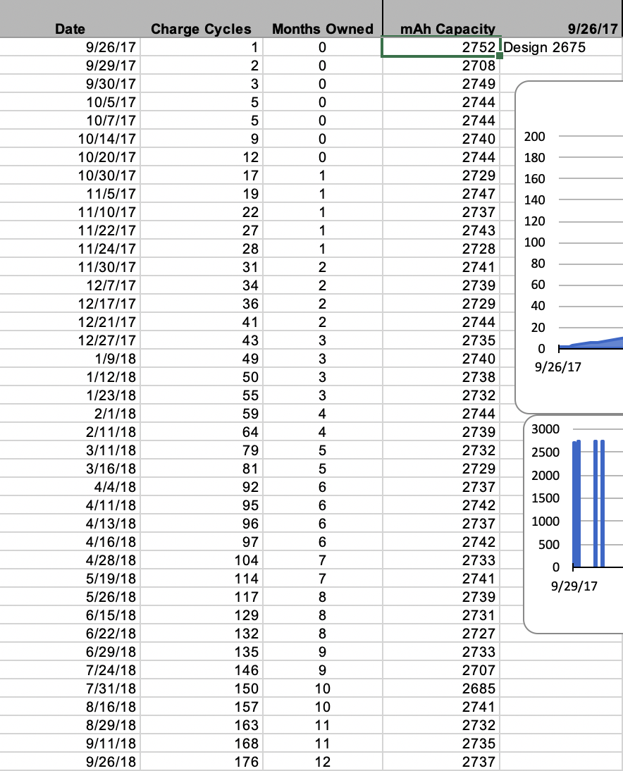

I mostly pay attention to capacity and charge cycles. Some points to note: Battery wear is not linear, like a tank of gas, it is a chemical reaction that changes. https://www.BatteryUniversity.com is a great place to learn how to care for a battery - the author of the site writes a really good book too.
Here is my 8+ that I had for about a year:
Ahh yes I see quite a bit of fluctuation on that chart, however what is impressive is that it is all above the design capactiy, it almost looks like apple have some sort of battery lottery with a design capacity and some batteries being over it by quite a bit. I guess this is like the silicon lottery with overclocking processors, some can go far higher than others.

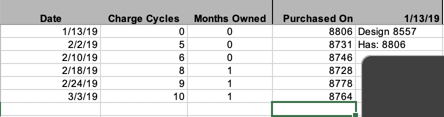

It's basically brand new - Purchased 1/13/2019. 10 cycles so far on it. Started out at 8806. I just measured it again today:

I too have noticed the threads on battery life of these iPads. I try to read it as soon as coconutBattery shows fully charged because it will drop after that slowly.

Interesting. You're right, 8827 mAh. https://d3nevzfk7ii3be.cloudfront.net/igi/QW3NGQFjwTjCGIdX.huge
I see, yours is still on its early stages. I just checked my notes and mine started at 8996mAh out of the box. Then it hovered around 8800 up to 17 charge cycles but then I forgot to unplug it next time and it was maybe couple hours after it reached 100% and capacity dropped instantly to around 8600mAh and from that on drops were sharp, 22 cycles was already down to 8300. Now it has 82 cycles and only 8051mAh and it show in running time also. iMazing says it is about 94% but obviously counting from 8557, while in reality it is only about 91% counting from supposed 8827mAh. Hard to see that batteries like this will last anything near 500 or was it even 1000 cycles iPad batteries supposed to be rated for? And as a note before anyone even suggest I'm running deep cycles or such causing it to die so soon- I'm not, I never let it run very low and charge it usually when it reach about 40% or so.
