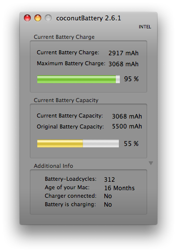

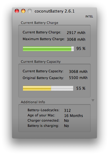

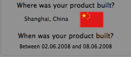

New Late 08 MBP 2.8
That's iStat Nano, I think.
Time for a new battery... :( Calibrating doesn't help.
Edit: Just realized this is the MBA forum... I have a MBP. Oops!

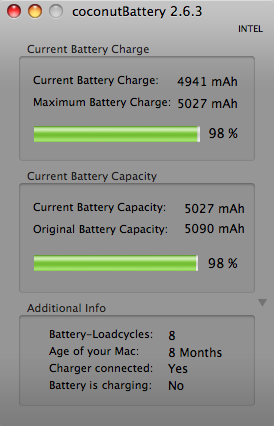

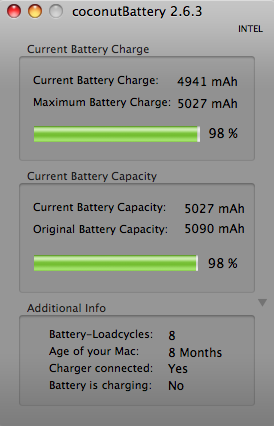

MBA, ordered when they were released =)
And yes, it doesn't go out that often, or when it does, it ends up being plugged into the wall at the destination =)
Very interesting
Thanks for posting your stats even though they are on a MBP. Most battery gurus claim 300 charge cycles for batteries (realize there are newer batteries that can supposedly exceed that number). Yours would seem to prove the case. Still working, but your capacity is falling quickly and will continue to fall.
In my experience most batteries will go 300 charges without problem unless the user only occasionally cycles the battery. In that case, time is your enemy and the battery dies over time rather than usage. For example, I have an old powerbook G4 that is 74 months old, has only 101 cycles, but is now at 73% of original capacity per coconut battery. It actually seems worse than that and now shuts off automatically at unpredictable points.
I note that Apple is claiming 500 cycles for the new 17 inch MBP. I will be curious to learn more about that battery.
Meanwhile, my MBA which still goes out to work almost every day is doing fine with about 100 cycles and 95% battery. Love that machine.

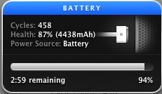

mine is waiting for a replacement... after a period of fighting for juice in airports etc.. etc... (458 cycles!!) but still; the lady feels great!

Nothing like waking a thread from the dead. What version of MBA do you own? The MBPs with 7+ hour batteries have a 1000-cycle battery. The MBA has a 300-cycle battery. But I haven't read any cycle claims for the MBA since the original MBA.
I believe that means the MBA has the old battery tech (meaning not the flat cells used in the long-cycle MBPs/MB). Does anyone know for certain, meaning an Apple statement, of what the battery cycle capabilities are for the MBAs?
