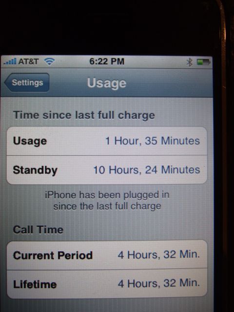

Well,
I take back what I said.
It really does look like the phone is draining faster.
This is with one hour of use. The "use" was with no phone calls. Two missed calls with voicemails saved and listened to.
Also some web surfing. That's it! I do have Yahoo IMAP on so maybe that's what's causing the drain. But look at my meter. Its at less than half at only one hour of use.

Yep..but the settings for my phone haven't changed. I keep the bluetooth on all the time. Plus, as I stated in the above post. I just missed two calls and checked voicemail.
Maybe someone could post similar usage and take a picture of their usage and battery level.
