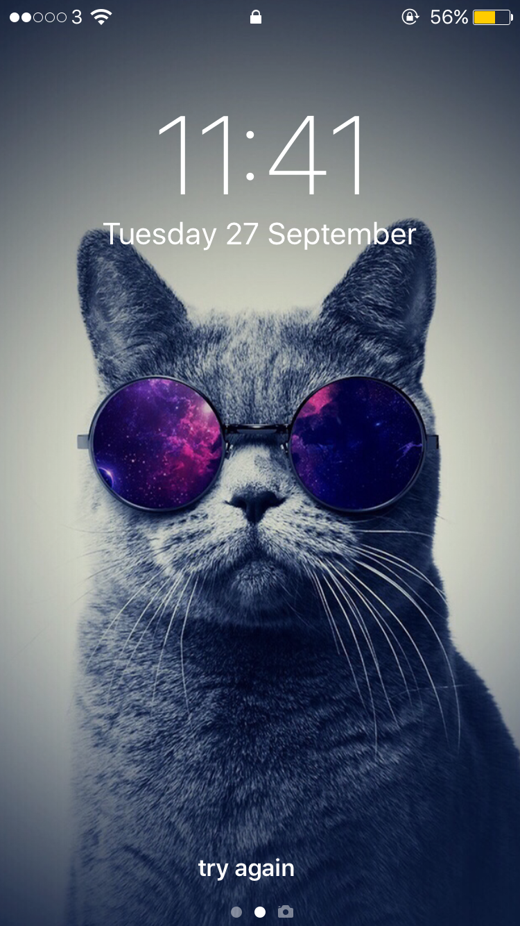

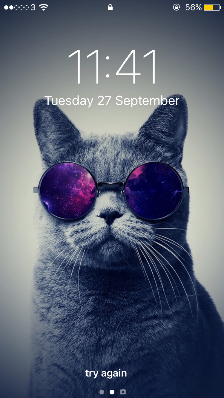

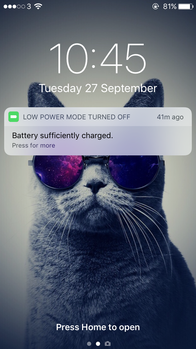

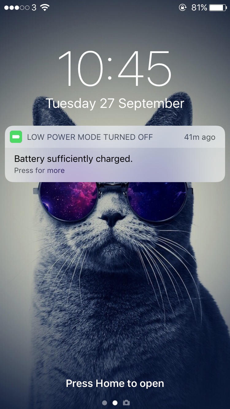

P.s. I have added 2 screenshots. Showing how in 1 hour of using my phone (from 10:45 to 11:41 & whilst on this forum site only) the charging has gone down almost 30% whilst on low power mode. Also shows how whilst charging,low power mode got turned off at 80% which was 41 mins ago. The charging had only gone up 1% to 81% in 41 minutes.
Just to give you all an idea of charging and draining....All this has driven me nuts.
