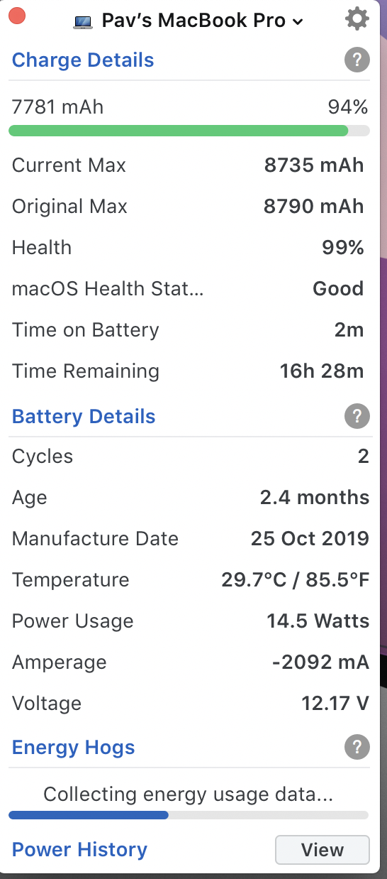

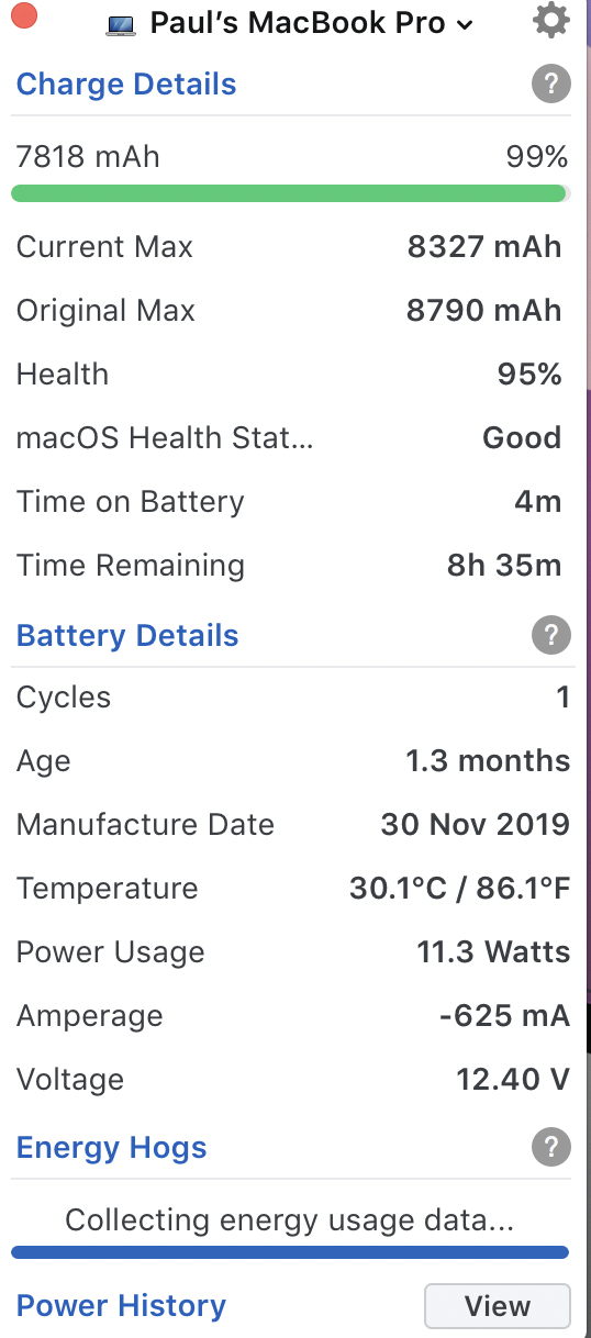

Just got a brand new 16" Says Original Mix is 8790 mAh and current Max is 8394 mAh Health 95%
Is this normal?
I have another identical system with Original Mix 8790 and current Max 8850! with 101% health.
I have noticed that manufactures of batteries are different. Seems odd results.
Out of curiosity, is the battery that is showing the lower mAh manufactured by Simplo, and the other (overstated one) manufactured by DSY?
Yes the 95% health and lower capacity is manufactured by SMP and the other one is DSY.
Both on battery at mo low one says 8 1/2 remaining and other says 16h remaining both doing nothing with same config.

This is screen shot of higher capacity (DSY)

and this is screen shot of lower capacity (SMP)

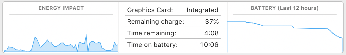

Mixed usage over the past 24+ hours. Brightness around 75%. Probably 3-4 hours in Photoshop and Camera Raw. Very impressed with battery life so far.

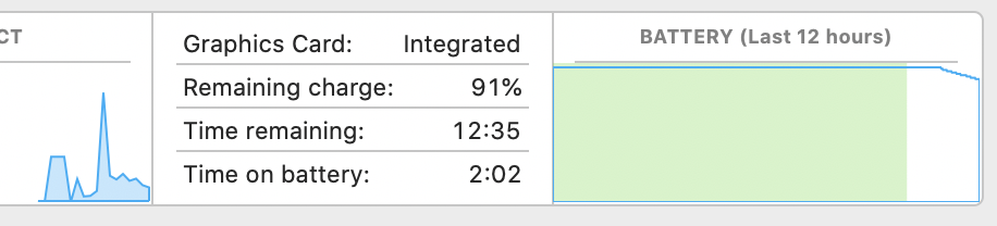

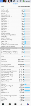

yes - I was posting it before. Look at istats data below.
I have circled in red that system is reporting integrated GPU only and with second account logged in Raden power draw jumps from 0,1W to ~5W. If you look at total power it is obvious your battery life goes down significantly with more than 1 user logged in.
If I work with only 1 user I can easily get 8-9 hours of battery, with multiple accounts this drops to 5hScreenshot 2020-01-24 at 08.44.30.pngScreenshot 2020-01-24 at 08.45.43.png

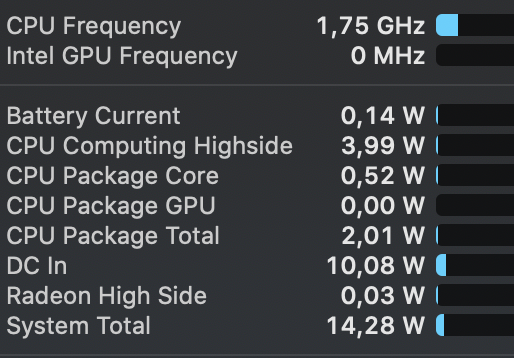

Have installed iStat Menus. Bit annoyed that the (cr)App store version doesn't have fan control, but at least it doesn't have the irrelevant weather nonsense.

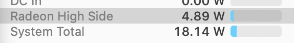

My "Radeon High Side" is drawing 5W. Rebooting brought it down to 0.1W. Nice. So slowly starting up my applications and the culprit surpisingly wasn't MS orofice and neither the hideous MS Teams crapp...

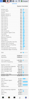

Weird, tried it right now and it gave the problem:
  1. Had it connected in clamshell mode to a DisplayPort over US monitor with USB-PD (Dell U3219Q), driven by the Radeon
  2. Ran pmset to disable the discrete GPU when in battery mode
  3. Unplugged the USB cable. Waited to ensure the computer was sleeping properly.
  4. Opened up the lid, checked Activity Monitor:
  5. and iStat Menu
  6. which shows that it's still powering the Radeon.
  7. Then I quit Chrome (no change), then Postman (no change), and finally VS Code and then it dropped to 0.16W
  8. I did not have to quit Parallels even though Activity Monitor showed that as the only thing with "Graphics Card: Yes".
  9. I relaunched Chrome, Postman and VS Code and it remains at 0.13W.

"Radeon high side" circa 5W - a reason?
I use the 16" primarily with Cinema Displays at home and in the office, occasionally as a laptop.
When the Radeon high side's running at zero(ish) the battery lasts a long time. When running at 5W with no external monitor connected and allegedly running on internal monitor, the battery life's less than 5h.
Working on the sofa whilst watching the telly; noticed it was at 5W. So closed a couple of VMWare VMs and quit VMWare. It then dropped to zero Watts. Hmm.
Now showing more than 11 hours battery life!
