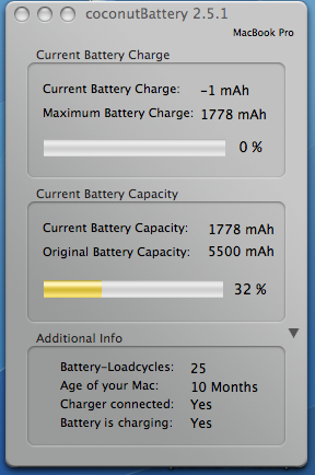

Ok, did the battery update to my 15". Battery capacity went from 3668 to 5495. Too good to be true??? Did a battery calibration. Came back later to a kernel panic. After reboot, my capacity dropped to 2322. Hmmm. 😡 Only 24 load-cycles on this battery. I'll cycle through once more and see where things are at.
UPDATE: CoconutBattery showed a capacity back up to 5495 again. Cycled the battery again, and it will discharge 50% down and dies (goes to sleep). No warning at all. Now shows capacity of 1778. Time to take this baby in I guess... still under warranty.

same here..... 24 cycles and only 1800mAH.
