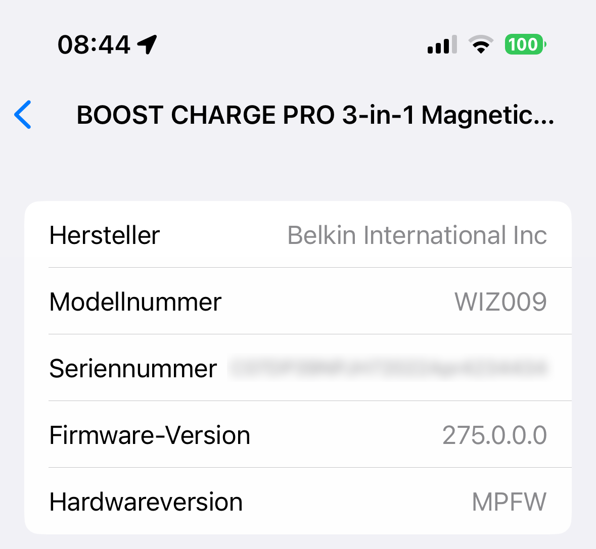

Those Belkin Chargers get indeed FW Updates on a regular basis. You can check this under Settings - General - About
(the iPhone has to be on the Charger for 1-2 Min in order the menu appears)
Good to know! Is there a way how to force the FW update? (I’ve recently realized that one of my chargers suffers from the bug too, but another is fine - version of both is the same as on your screenshot though.)

I remember when I first bought one of these there was some confusion because there are two versions of this but look exactly the same. One is model WIZ009 that does not have fast charging and the WIZ017 that does. I wonder if both have the problem or just one of those models/firmware version does? I have the WIZ017 that does not currently have the issue. My Firmware version is different than yours 267.0.0.0 and hardware version is the same as yours. HMMMMM

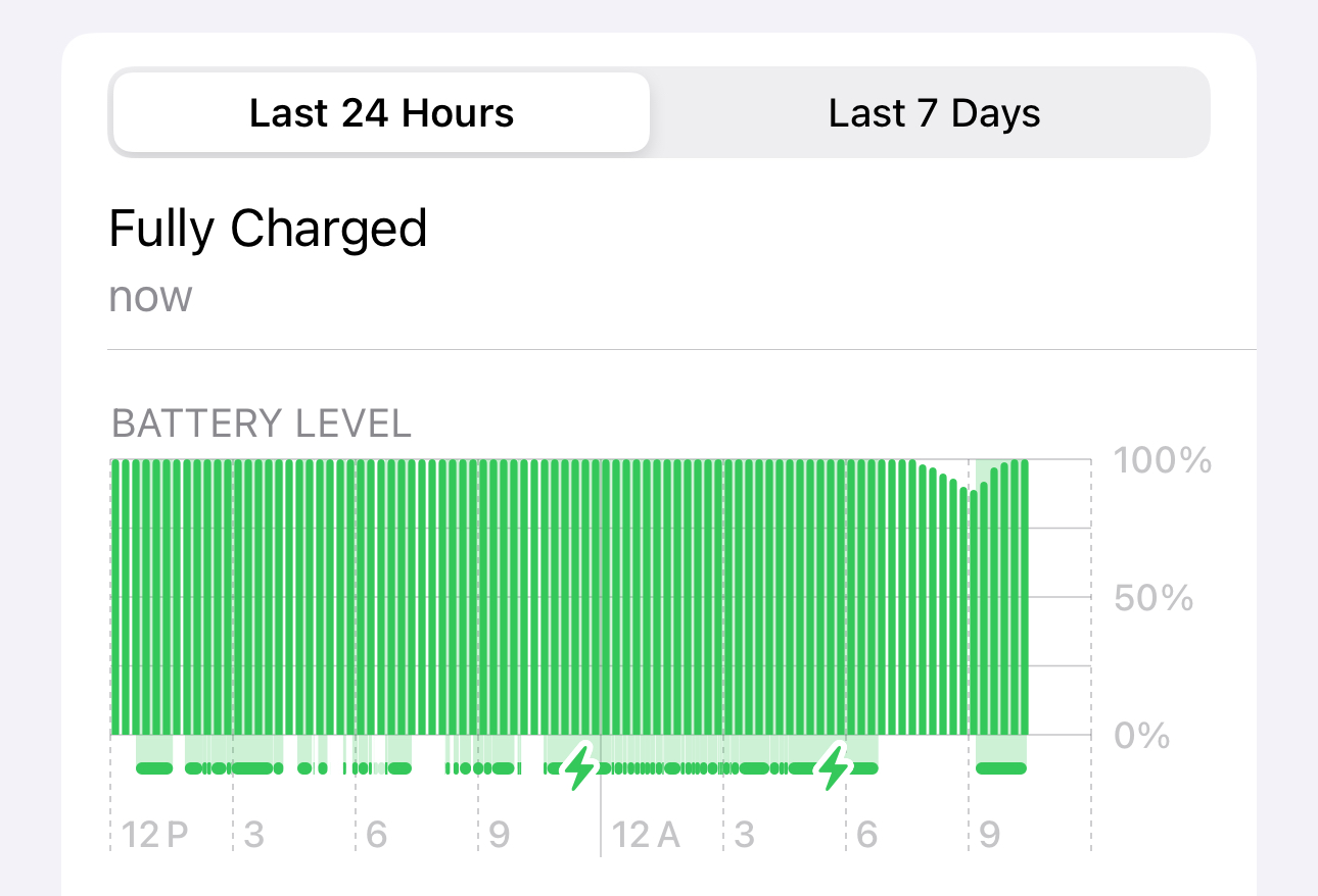

While taking a look at the battery level, I noticed that MagSafe on Belkin was keep disconnecting and connecting many times over the night(i.e. I put the phone on the Belkin MagSafe overnight).
Another test I did was from 9am to 10:30am on an official MagSafe charger, it didn't produce the "dot-line".
I'll stop using the Belkin now I think and ask for replacement from Belkin.
My 3-in-1's model # is WIZ016, Firmware 274.0.0.0, Hardware Rev MPFW. 30 months old now, well outside the 2-year warranty. Belkin is replacing it and told me to toss this one in the trash once I receive the new one.
I have the wiz009mybk model running 275.0.0.0 and it works just fine still. 🤞
If Belkin told you to throw your WIZ016 in the trash then it has to be a hardware related fault.
