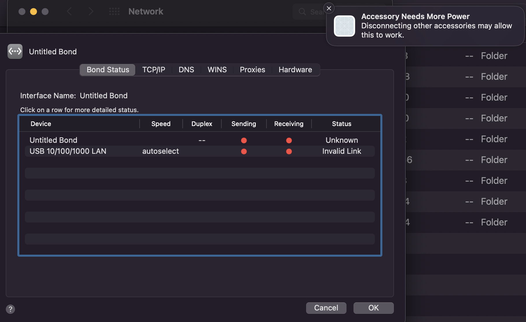

I just did another test with the Macbook Air M1:
1. I plugged in the Belkin Thunderbolt 3 Mini dock and the Anker as the Macbook itself doesn't have its own ethernet port
2. Devices get recognized without issue, I create an aggregate bond configuration with both ethernet adapters as part of the ethernet bond - connection works fine
3. Restart: I get the message "Accessory Needs More Power" - one of the Ethernet devices is gone and in the Aggregate Bond configuration it uses itself as an interface - which of course does not work and the other device lists as "invalid link"
This is essentially what also happens on my other mac with the exception of the spontaneous rebooting after logging in and the message "Accessory Needs More Power" which I only get on the MBA
What's curious about this is that in the device info it shows the available power is 900mA and the Thunderbolt dock displays as 900mA required. Only the Thunderbolt device stops working. Re-plugging the device revives it and I am able to set up a fresh Ethernet Aggregate connection without problems.

is the external power supply for your belkin thunderbolt express 3 dock plugged in properly?
it shouldn't be drawing any power from the host machine

Apologies, but I am actually using this model which doesn't need a power supply:

This may be the key. Having 2 ethernet ports may not work with this combo of adapters/docks because too much power is required. Or your Belkin is defective. Sound like contacting Belkin makes sense, though their support (for other products) can be spotty.

but then why does it work without any issues the first time I set it up and only stops working when I restart the mac? it is puzzling... I am pretty sure it has something to do with how monterey handles thunderbolt power supply. Belkin is known to work quite well with Apple devices and if I wasn't using it in a bonded configuration I may have never had any issues with it. ah well. I guess I'll invest in a bigger thunderbolt dock at some point if I get fed up with this
OK so I found a little workaround to avoid the spontaneous restarts. Before shutdown, I remove the bond and re-enable one of the "regular" ethernet connections in the networking panel. Doesn't matter which, the thunderbolt ethernet or the onboard one.
This definately means the Belkin mini dock is working just fine, there is nothing wrong with it.
After rebooting, everything just starts up fine but I have to go back into networking and set up a brand new bond. Kind of cumbersome but it works...if I don't forget doing it 🙄
Since everything is working just fine and only acts strangely as long as the aggregate bond is active under networking, I am wondering if this is some power or permissions thing going on under the hood and if it is fixable via a script or change in a preference file somewhere...

Things just got a little easier now that I switched to a single-screen setup, using only the studio's own HDMI port. I still have one of the Ethernet ports failing after restart, but after doing these steps, the bond starts working again:
1. remove aggregate bond from the network devices list, click "apply"
2. add all ethernet ports one by one, click "apply"
3. create a new aggregate bond, click apply
Now the bond is operative again without giving me an "invalid link" status. The reboots are also gone. Seems this had to do with the second display I was using - with the HDMI being on the same thunderbolt adapter.

Found a neat workaround: In order to quickly deactivate the Thunderbolt port before shutdown to avoid it being deactivated with next bootup, I created 2 shortcut actions which I put in the menu bar. They trigger two terminal commands:
Code:
networksetup -addDeviceToBond en15 "Finally Bond" /* activates the thunderbolt port and adds it into the bond
networksetup -removeDeviceFromBond en15 "Finally Bond" /* removes the thunderbolt ethernet port
Now I can simply trigger these shortcuts before shutdown or even attach them to a specific keyboard shortcut. Saves me at least some time 🙂
