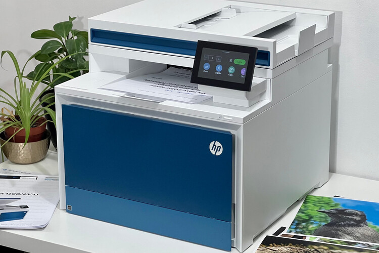

Finally a review of a color laser discussing its decent as a photo printer.
“Paper selection is an underappreciated benefit of a color laser printer. I can get decent-quality photo printing on the cheapest paper available with minimal curling and no delay for drying time. A laser printer melts toner onto the page rather than dousing it with liquid ink.
Naturally, photo paper provides the best results. The HP Color LaserJet Pro 4301fdw nearly matches the photo quality of most inkjet printers when using a matte or glossy photo paper. The limited 600 dpi resolution does show in some photos, so an inkjet is still needed for maximum picture fidelity. The only thing lacking is the option for borderless printing.”
this one looks pretty good, I'll need to see if I can find it in one of my local Office Depots and check it out in person. Tabloid size would be nice, but if this is the right one, Legal size would be good enough for my purposes.
