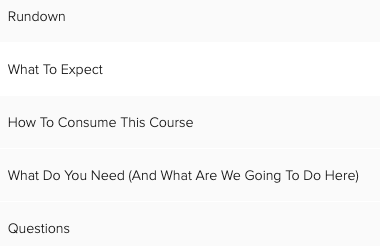

Wow, this thing really is a different beast. Most of those monitors would cost more than the Macbook itself!
I do like to use my Macbook when I'm not working at my desk, but at the desk for the most part it'll be in clamshell mode, sometimes open if I need tons of tabs. So I guess both. I don't have specific measurements but it will be sitting just like a regular desk set up (in terms of distance away).
Honestly, I write using things like google docs, so the colours etc won't effect me that much.
Just want to be sure that the text will be smooth to look at for long hours, for reference I've included a pic of what the text looks like on the current 1920x1080 monitor I'm using. Passable, but if I'm gonna buy a 4k monitor, I don't want this!

Got it thank you. The text is clearer than any windows machine I've used in the past on this Macbook air, but I don't think I'll notice any difference with the 4k screen.

A 27" 4K Monitor like the 27UL850-W will certainly be sharper than a 1920 × 1080 display!

Yep I know it will be sharper, but I just want to make sure it's not fuzzy text at all!
I think that would be up to you to decide!
Apple has decided that sharp text requires 218 ppi on notebook and desktop computers, but this also depends on your eyesight, the viewing distance, and also what you subjectively perceive as “fuzzy”. Certainly a lot of people use displays with lower pixel density and love them.
The LG Ultrafine 4K recommended above by jdb8167 is actually a great in-between option, I forgot about it. There is also an older version of that display which was 21.5" that was near 218 ppi but I’m not sure about features / compatibility. You may be able to find one used.
Is it possible for you to buy from a place with a good return policy or find one of those 27" 4K LG’s in store somewhere near you and look at them? That will give you a much better sense than looking at the specs.
