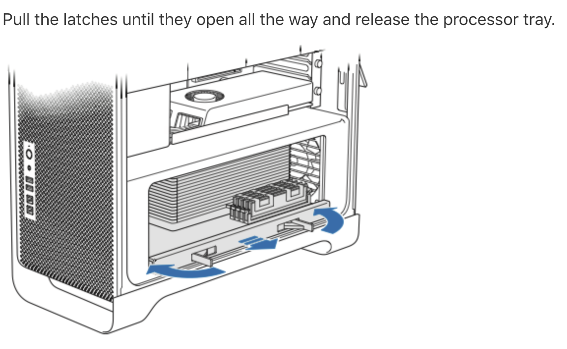

It's so easy to take out the Processor Board Tray, not doing that will prevent you to clean it properly.
-Just push the levers in front of the tray and you will be able to take them out.

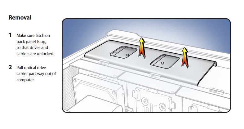

Especially the PSU is very sensitive for dust and the Optical Bay/ Superdrive prevent dust to blow out.
Like above it is very easy to take out the whole Optical Bay so you can clean the PSU.
Make sure the lever to open the Mac is in the up position, than you can easily pull out the Optical Bay.
