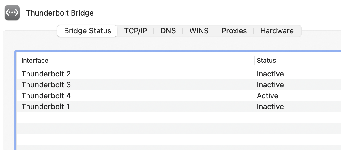

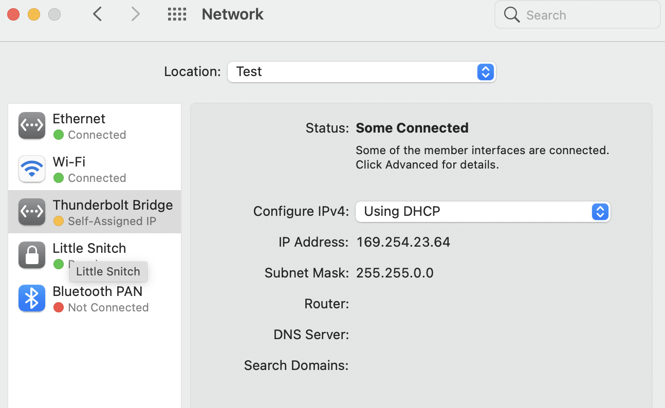

Spent another 2 hours on the line with Apple Support. We got it working on 11.3.1. Not totally sure what did it but:
1. Created a new location "Test"
2. Under Thunderbolt Bridge advanced selected the thunderbolt port connected to the QNAP (Thunderbolt 4 in my case)
