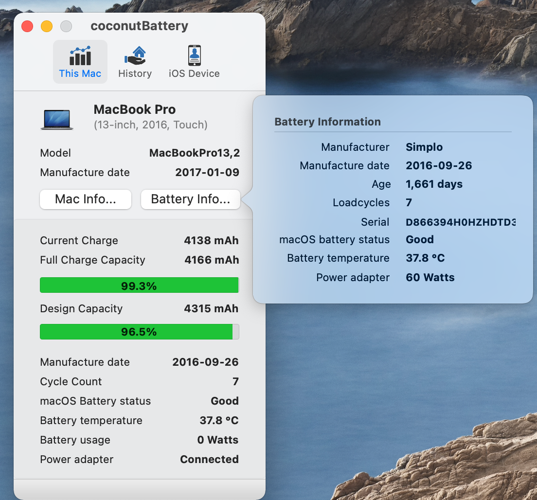

Interesting. So I eventually made the plunge and replaced my battery with some third party brand from Amazon and things are back to normal. Visually the old battery looked swollen in some areas. Thinking about it now, it was 5+ years old. Prior to the Big Sur upgrade Mojave reported that all was fine as well Coconut battery which probably pull that data from the OS somehow. I could only surmise that the prior OSes aren't properly reporting the battery state? It may be worth popping the cover off to inspect it.
Curious that the new battery didn't work for you..perhaps return it? What's the manufacture date?
