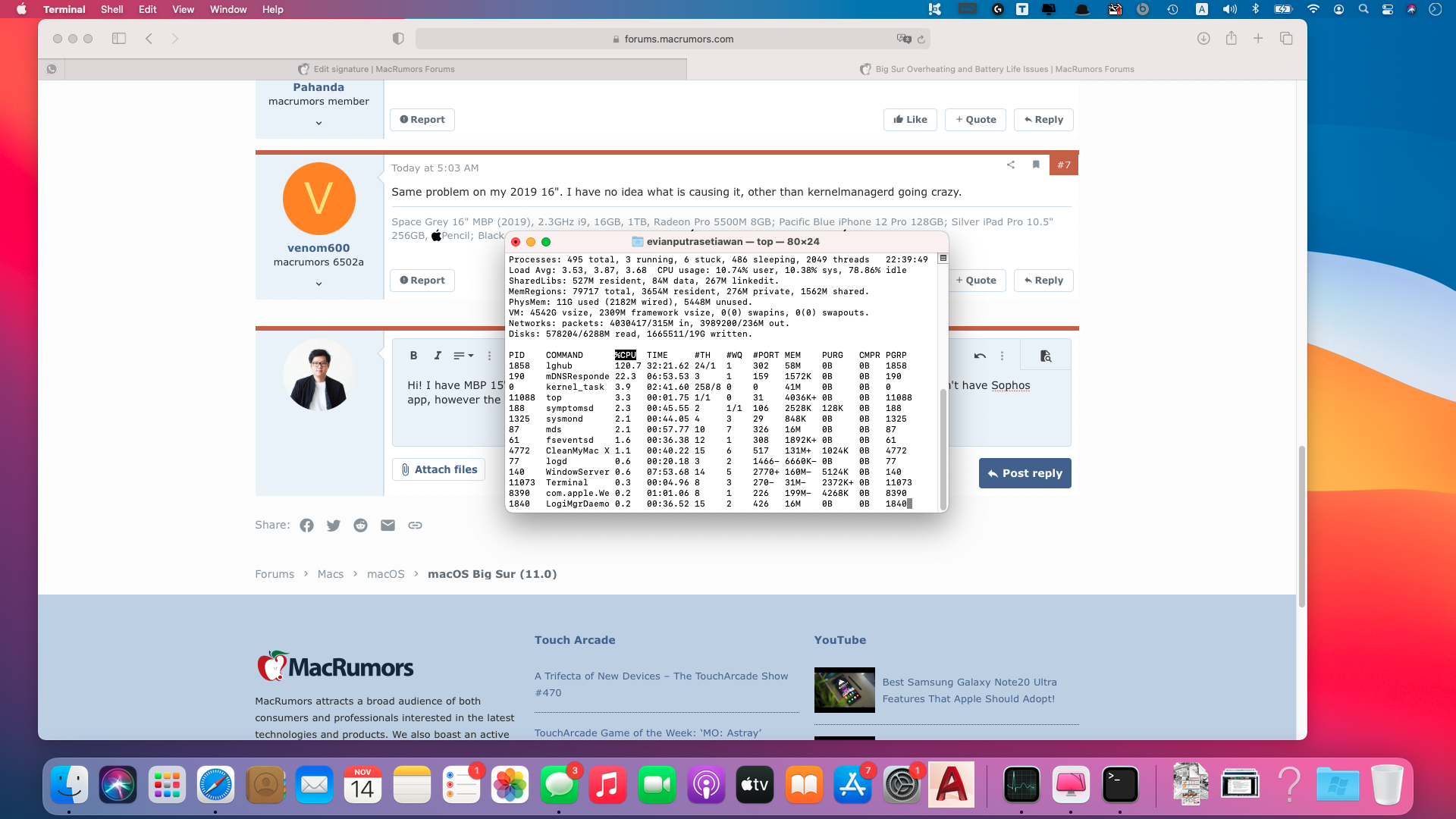

Hi! I have MBP 15" 2017. It also has this overheating issue and I am desperate to find solution. I don't have Sophos app, however the top one is lghub and I don't know what it is. Is it Logitech G Hub App?
