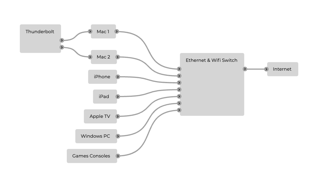

I've been trying to find a solution, and haven't had any success do far - is there a way, through built-in or third party tools, to bind file sharing to specific hardware interfaces?
For example, I have two Macs connected via ethernet to a switch, and also using common Wifi that all the devices in the location use.
I want to run a thunderbolt cable directly between them, such that they can file share to each other over that cable, but the file sharing is not available / does not even show up to devices connected to the switch, or on the Wifi.
Suggestions appreciated.

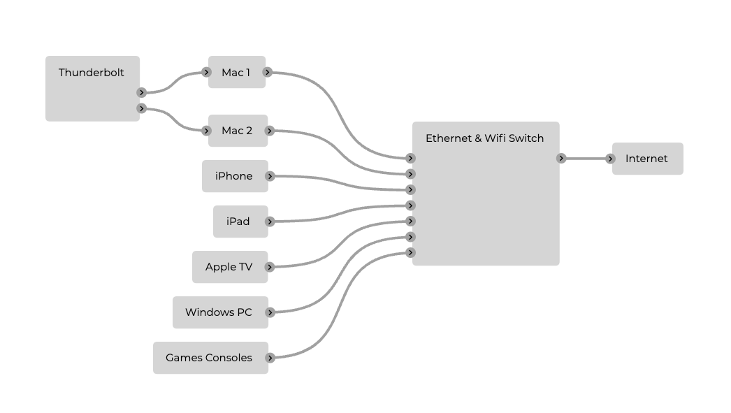

This is the network topology I want to set up:
What I want to avoid is file sharing being available, or even acknowledged as existing through the switch.

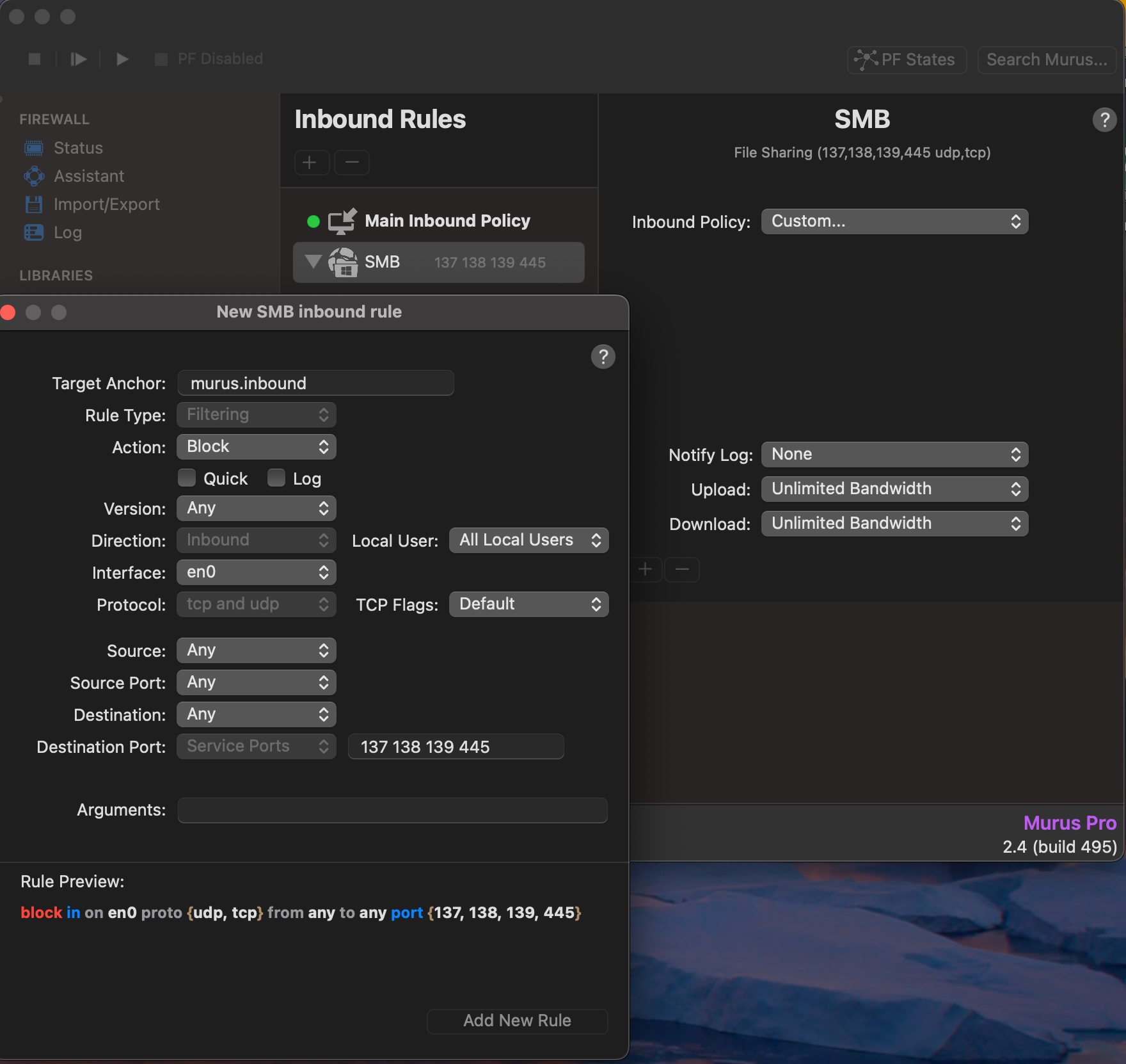

Personally I'd go the firewall route. I don't mean the macOS application level firewall that is controlled in System Settings. I mean the packet-level firewall that's also built into the OS. I would use Murus Firewall (https://www.murusfirewall.com/), which makes it very easy to configure it. Murus is not the firewall, just a tool that helps you configure it. I think it's a beautiful product. If you decide to go this route, I or maybe others on this thread would be happy to help you configure it. I just refreshed my memory on it, and it seems trivial to satisfy this exact use case. I do use Murus Pro, but I suspect the free version, Murus Lite, would be configured identically.

You need to find a way to prevent smb traffic on the switch interfaces of the two Mac computers. Just as @cqexbesd said, either ensure that the smb servers are not binding to those interfaces or prevent the smb traffic with a firewall. Your opening post asked about how to do the first one. Have you tried altering the settings in /etc/nsmb.conf to do that? Have you run "man nsmb.conf" and read that manual page? I have no idea if you'll have any luck with that. I trust Apple to sabotage most efforts to do something they didn't anticipate the average user would need. I don't know of any third-party tools that can help with this.
I do know that the built-in packet-level firewall approach is a trivial solution and Murus makes it easy to configure.
I don't know how to work with the more well-known application-level firewall of macOS to prevent the smb process from listening on a particular interface.
I have a license to Little Snitch. I don't see how it can help. You can limit the smbd process from accepting traffic "from" particular addresses, not "to" a particular addresses.
The makers of Murus also have an application level firewall called Vallum. I think it can do what's needed. I do have a license for it since I bought it together with Murus, but I don't have it installed. Consider https://help.vallumfirewall.com/index.php?chapter=ruleformat, where it shows that it can block by target address. It's kind of the same approach as a packet-level firewall except that the rule is for the listening process rather than just interfaces and ports.

Murus is a graphical tool that would allow you to set this up.

I went ahead and installed Vallum and learned some things.
1 - I wouldn't use an application-level firewall to secure file sharing; it's hard to get all your bases covered. Vallum reported to me the various processes which were involved in file sharing. It was more than just smbd. So locking down smbd to one interface might not be enough for full security.
2 - Vallum reported the other things that were happening on my network that would be lost if I were to completely lock down an interface. "rapportd", which I've read manages Handoff, accepts traffic. I wouldn't want to lose that when working with my iPhone and Mac. There was also general incoming IPv6 Apple traffic that would support things like the Home app. And, I do sometimes screen share - that would be lost if I locked down the interface.
So, I would use the packet level firewall, configured with Murus to just lock down ports 137,138,139, and 445 on the switch-side interfaces. Generally the packet-level firewall is not running at all on our Macs unless we take steps to use it. Here's me, working in Murus setting up what I would want if I were to prevent file sharing on my wireless interface en0, but allow it on other interfaces.

The firewall solution is simple on/off after you've configured that one rule: "pfctl -e" (on) "pfctl -d" (off). But, OK, you don't want to use the firewall.

I'll never argue with intuition. You seem to be well informed. But, I do want to share my experience and intuition.
The PF firewall on BSD is an industry standard and used in corporate environments. I run an OPNsense firewall and it is based on FreeBSD - like macOS - and uses PF. The rules for the sharing restriction are as simple as they come - just one rule; it would be hard to make a mistake in configuring that and easy to test that the restriction is working. PF is open source and very, very, very heavily reviewed for vulnerabilities. I feel confident that it would be secure.
When I'm in a coffee shop I always enable PF to disable all incoming traffic. I don't trust that all my applications are secure, bug-free, or well controlled. They are reviewed for vulnerabilities much, much less than PF.
My intuition is that the firewall restriction is like a locked prison cell. Trying to control a daemon to listen on just one interface is like letting the prisoner free and asking them to behave. I'm trying to be funny, but that is a genuine representation of my intuition.
Sorry about beating a dead horse. I tried to resist adding this post, but it kept nagging at me that I had left it unsaid.
Not at all, it's a good analogy, and I'll keep thinking about it. Much appreciated :)

OK to update, here is where I'm at (all the cabling is set up), and I believe the problem I was trying to avoid is happening:
Workstation Mac Pro:
  1. Ethernet to Router: DHCP static IP bound to Ethernet MAC
  2. WiFi to Router: DHCP static IP bound to WiFi MAC
  3. Thunderbolt to Mac Mini: Manual IP 10.0.0.1
  4. Logged into my iCloud account
Legacy Mac Mini
  3. Thunderbolt to Mac Pro: Manual IP 10.0.0.2
  4. Logged into my iCloud account (for reasons of iCloud Drive)
The workstation has filesharing enabled, and only a single drive is shared.
On the Mac Mini, I can see the workstation in the Finder sidebar, and if I click on it, it will automount the entire workstation's filesystem, using the workstation's local credentials it's getting from iCloud.
I don't know how to tell what network interface that's using.
More importantly, I don't want it getting filesharing credentials via iCloud - I have a bad feeling the only solution to this is to remove the Mini from my iCloud account.
I can disconnect the auto connection, and manually set up an SMB connection to 10.0.0.1, and it will show only the single drive as available, but again, I personally don't know if that means I can be sure it's actually transiting the connection via the thunderbolt link.
I would also like to bind Apple Remote Desktop to the thunderbolt link, as the Mini only has gigabit ethernet and TB should provide for a more responsive experience, but whenever I try to configure connecting to 10.0.0.2, while ARD shows it as 10.0.0.2, if I get the attributes of it, it's showing its address as a 192.x - again, I don't personally know enough to know if I can attribute that to meaning the link is happening over the TB cable (I did my OS X Server Admin qualification with Apple ~19 years ago, so I'm very rusty from my sysadmin days).
So this seems to be where I'm at, and I imagine the next step is to waste several hours of my life trying to get Apple support to let me speak to someone senior enough that they know what a "Mac Pro" is (true story), and then see whether I can speak to someone who knows how to do the networking thing.
*edit* and FWIW signing the Mac Mini out of iCloud solved the login issue - now it only shows the login option for the dedicated filesharing user I created, and only mounts the specific drive I shared.
