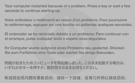

Yeah I had read that and every time I try, seems to get a kernel panic message.
Even if I leave the 780 in the lower PCI slot and put the quadro back in above it and try and reboot I get a kernel panic till I pull the card out completely and reboot.
I can’t really see what’s happening, but I know it doesn’t boot in because when I switch it too the Native driver and reboot I never reestablish my remote connection to the other Mac I am using. Then I have to pull the card and put my Quadro 4000 back in and start over.

Here is the first part of the Panic report.... let me know if I need to post more of it. I don't really know how to read one of these.
*** Panic Report ***
panic(cpu 0 caller 0xffffff7f88adf692): "bool IOAccelDisplayMachine2::display_mode_did_change(uint32_t): vendor driver returns false"@/BuildRoot/Library/Caches/com.apple.xbs/Sources/IOAcceleratorFamily_kexts/IOAcceleratorFamily-378.26/Kext2/IOAccelDisplayMachine.cpp:490

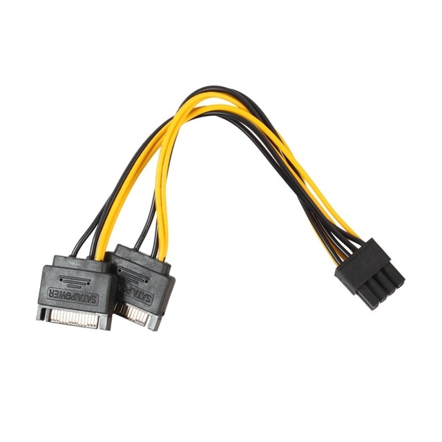

I ' feel ' that its a power problem.
I previously used a "DUAL SATA to GPU 8 pin " cable -
https://www.aliexpress.com/item/5pc...Power-Supply-Cable-20cm-SATA/32832007302.html
So, if you can live with out two internel SATA HDD ports .. ( use the DVD drive cage for 2 HDDs )
Setup
1. From cMP motherboard one 6 pin to 6 pin cable for the GPU 6 pin socket
2. The above DUAL SATA to 8 PIN from the two ( now empty ? ) internal SATA sockets to the GPU 8 pin socket.
Can't hurt to try this.

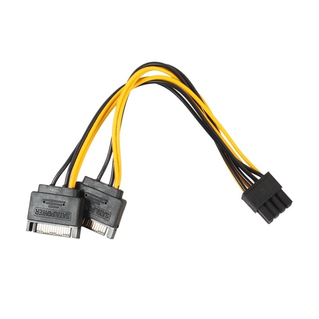

Setup
I am under the impression a single SATA port can provide ~50W, so two of them makes ~100W. With 8pin potentially pulling up to 150W I am not sure this is a real improvement. If anything, sounds more like a lateral adjustment if you will.
I would recommend using dual SATA to a 6pin PCIe connector. To be safe, I would recommend at least 3 SATA ports going to a single 8pin if the 8pin is needed to be powered via SATA ports.
However, if the poster has two SATA ports open for power, then they should use a dual SATA to 6pin cable for the 6pin of the GPU. Then use the two mini 6pins on the logic board to power the 8pin on the GPU, use a dual mini 6pin to single 8pin cable for that. This would be the best, safest, and recommended power setup
Reactions: macsforme
The onboard Apple mini 6 pin should be perfectly OK for the GPU 6 pin but I do agree about TRIPLE SATA to 8 pin to the GPU 8 pin socket - to be safe.
( Internal spinner HDDs are a thing of the past since SSD & bootable NVMe M.2 )
I use an EVGA PowerLink to my Sapphire Dual-X 7970 without any issues. ( had to cut off a little bit of the plastic fan shroud though.)
Single motherboard 6 pin + dual SATA to 8 pin. X-Plane 11 at hi-rez settings runs fine
