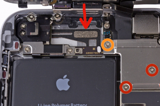

If you have the balls, you need to open your phone. Shut down. Remove the 2 screws and using the suction cup and plastic pry tool, pop the screen open. Once its open carefully lift the screen no more than a 90 degree angle! Look in the top left corner of the phone, you are looking for this... (ignore the circles)
specifically, that goldish rectangle. There SHOULD be a kind of odd sticker covering the rectangle (as in the picture). In my phone, that stick had moved down off the brass contact. I carefully scraped the sticker off with the plastic pry tool, then used tweezers to re-position it. Used the plastic tool to stick it back down... closed it back up. Start it up and boom! My Bluetooth is 10x better! Its not perfect, but I can now move well more than 2 ft from it and stay connected!
