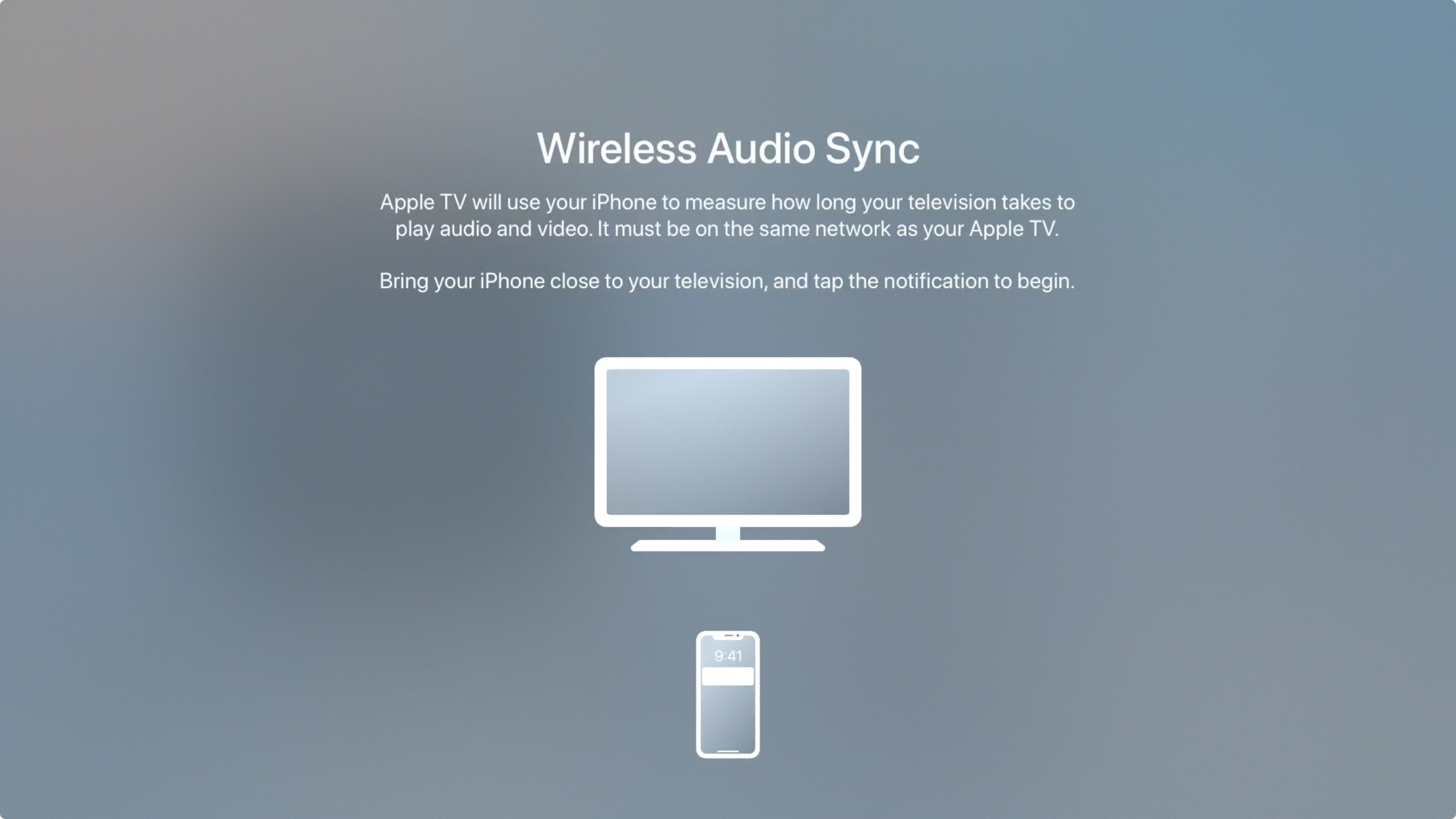

If you have an iPhone then use Wireless Audio Sync
No luck as it did the test/process via the speaker on the projector (thinking it’s a TV) and no improvement to Bluetooth. I’m going to try another Bluetooth speaker.

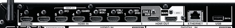

Look over there at the far right in that picture. If you have a wired network (access), connect via ethernet instead of wifi. That USB jack could let you dig that old iPod out of retirement, load it up with favorite playlists and play music from that iPod instead of tying up some wifi with airplay.

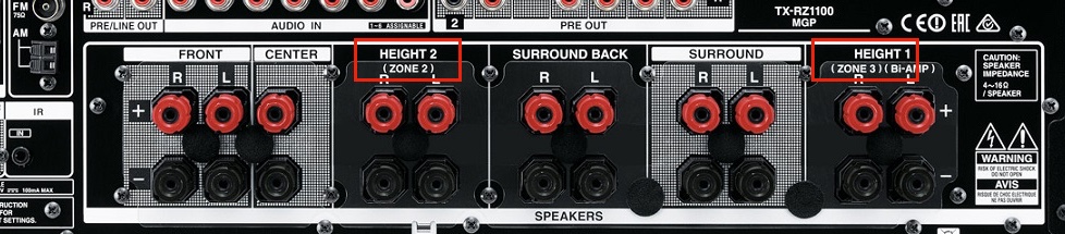

Want it to also play some speakers in another room or area? Look for Zone 2 Receivers that can play one thing to Zone 2 and the same or something else to the main area (zone 1). Want zone 3? Look for that too...

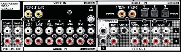

Do you need any other kinds of inputs? Perhaps you've got some old A/V tech that has only optical, or only RCA, or super VHS, etc? If so, perhaps look for a Receiver with the jacks so you have the flexibility of directly connecting that stuff too... even if rarely.

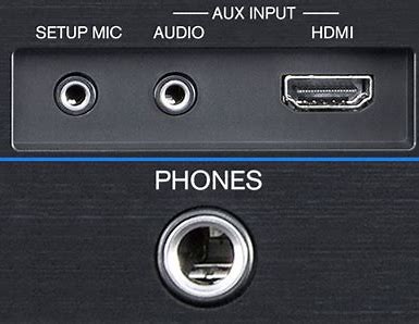

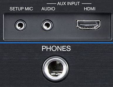

Need an easy access input(s) on the front for some occasional need? What inputs? Then screen for that input as you narrow it down. Usually, that's at least a HDMI input on the front side... but maybe something else is important to you too?
